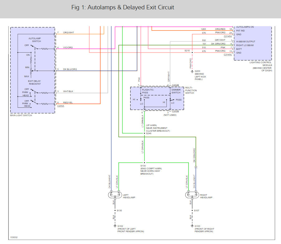

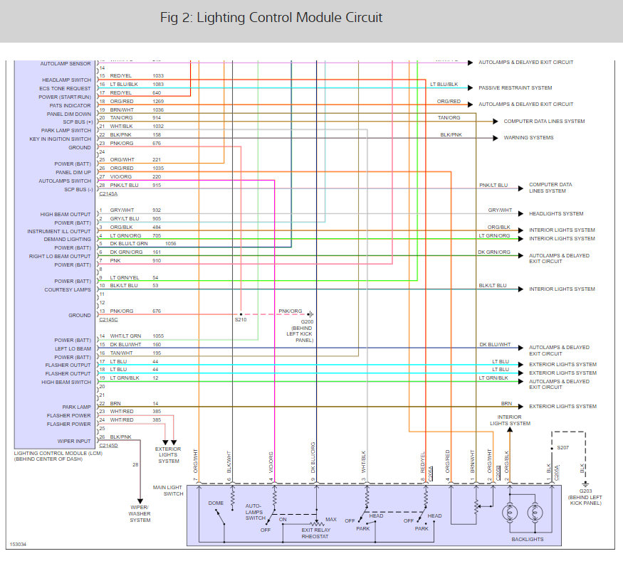

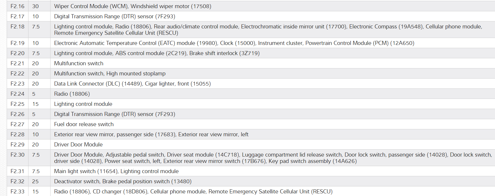

So I used my keypad to make sure the car was locked and my headlights that were in auto mode will not turn off unless I put them in the off position on the switch. Also, when the car is on and running the dash lights/radio/lights will not turn on in auto mode. Not sure whats going on.
Aug 6, 2018 at 12:47 PM
  • 55,797 POSTS

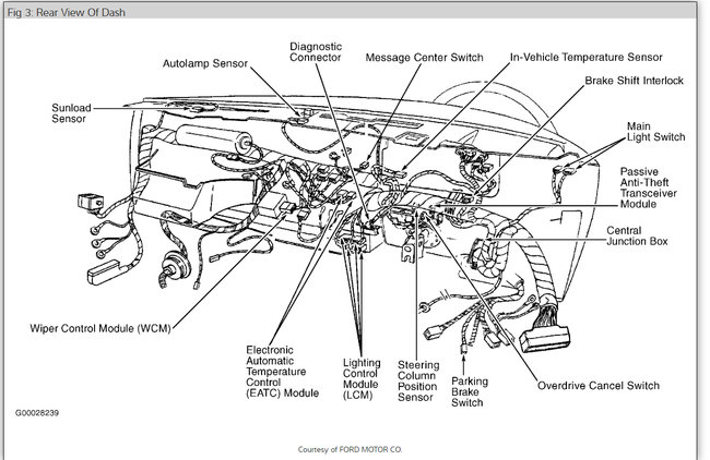

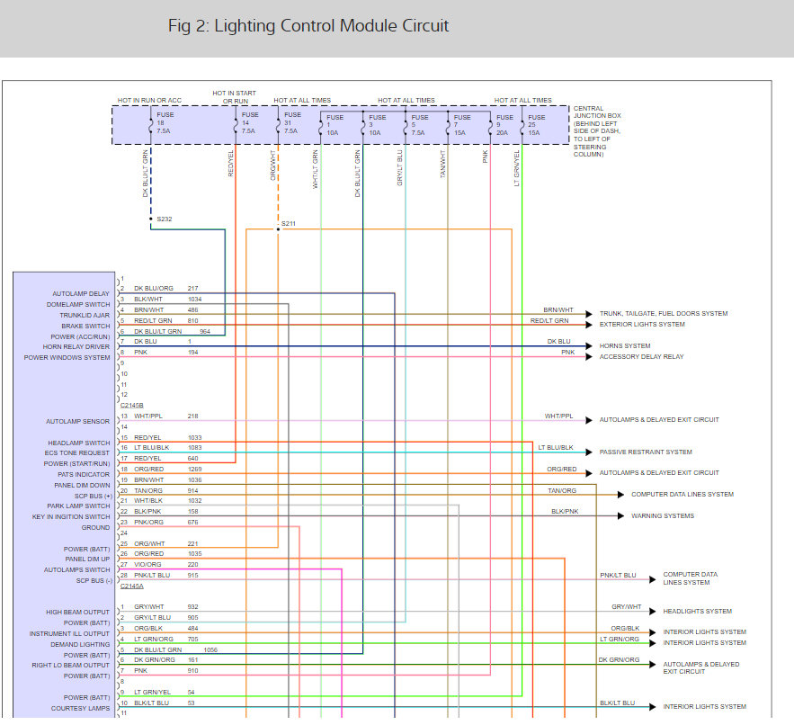

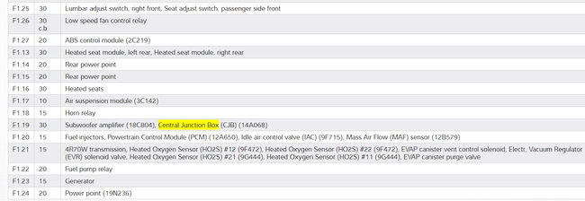

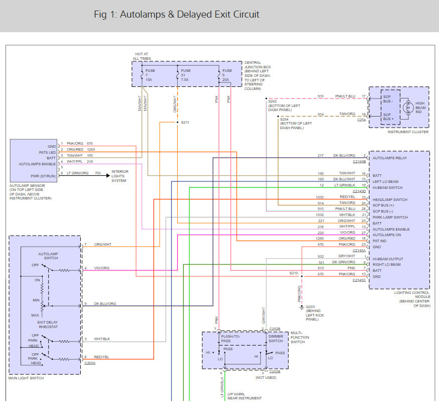

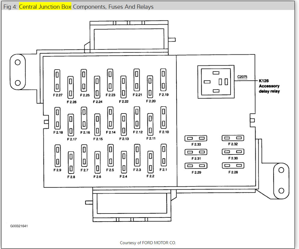

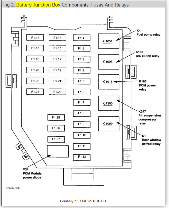

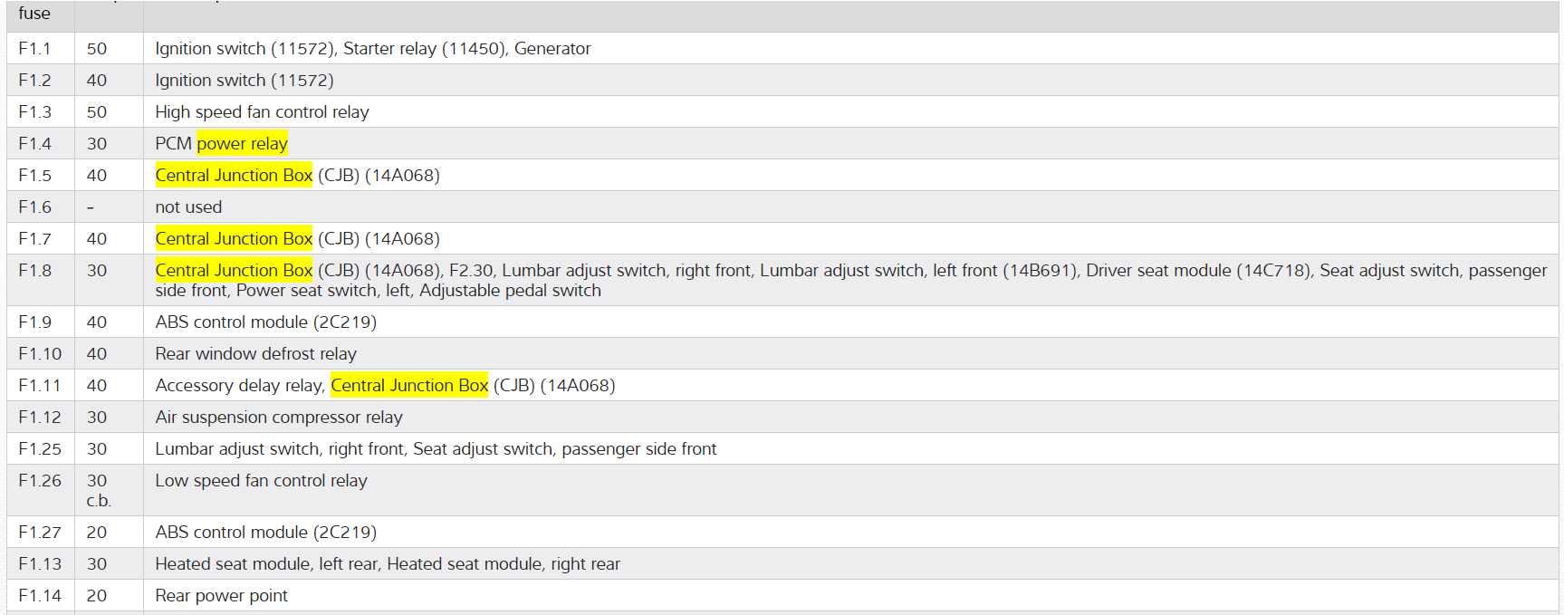

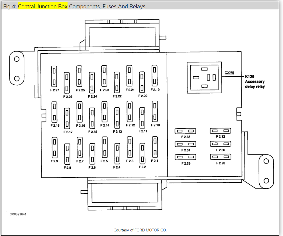

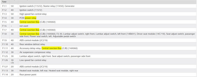

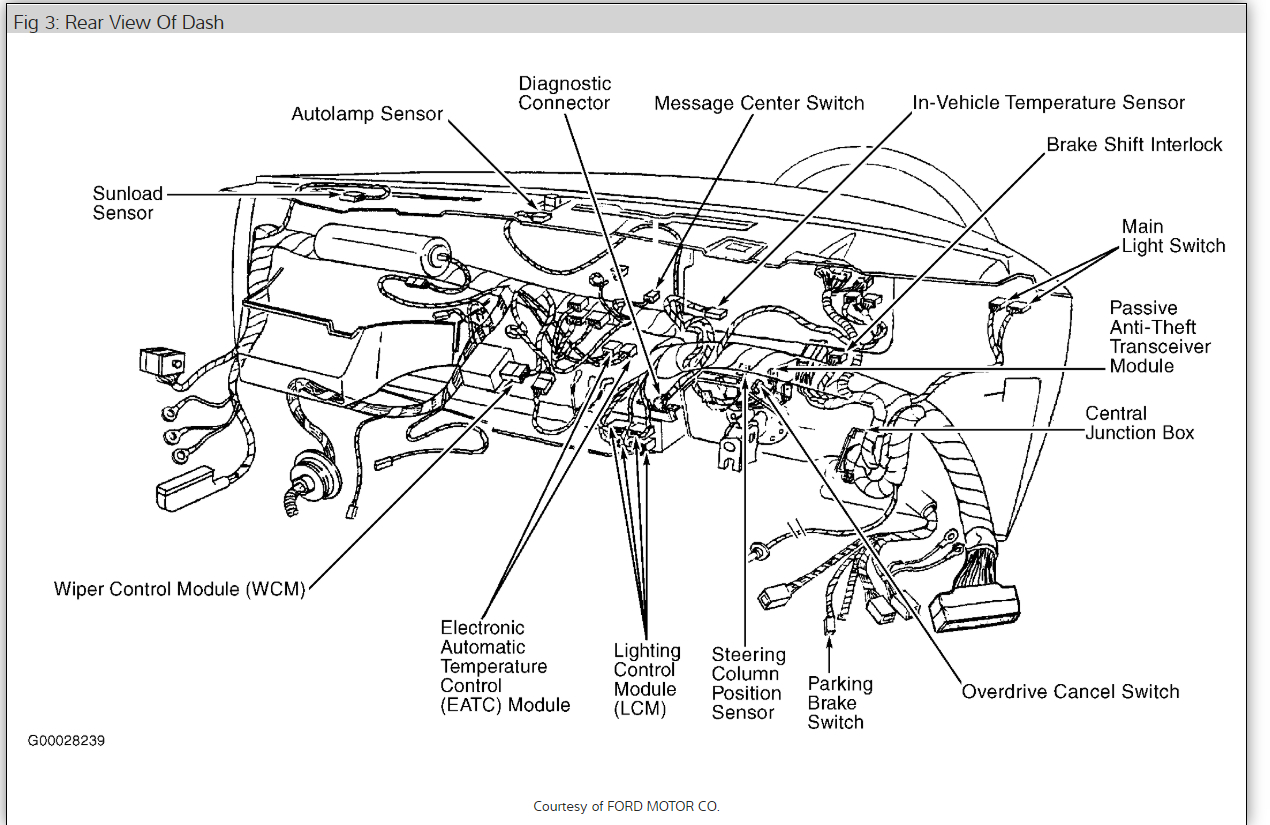

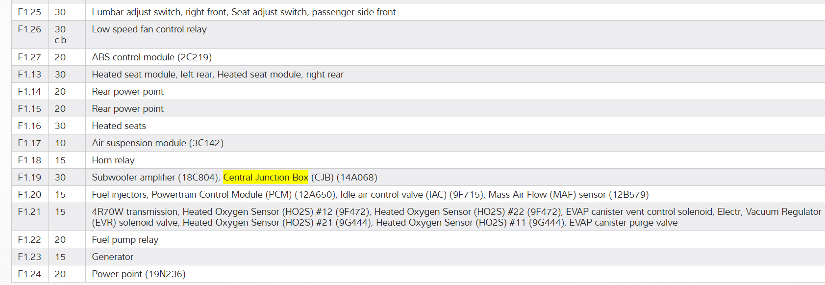

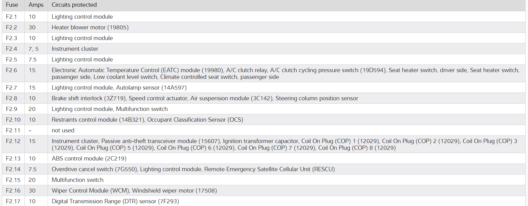

There are several fuses that run the system that need to be checked first. If everything checks out it sounds like the lighting control module is having a problem. Here is the location of the fuses, lighting module and wiring diagrams so you can see how the system works:
