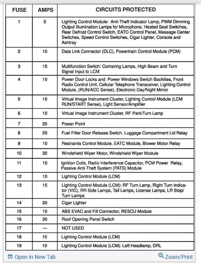

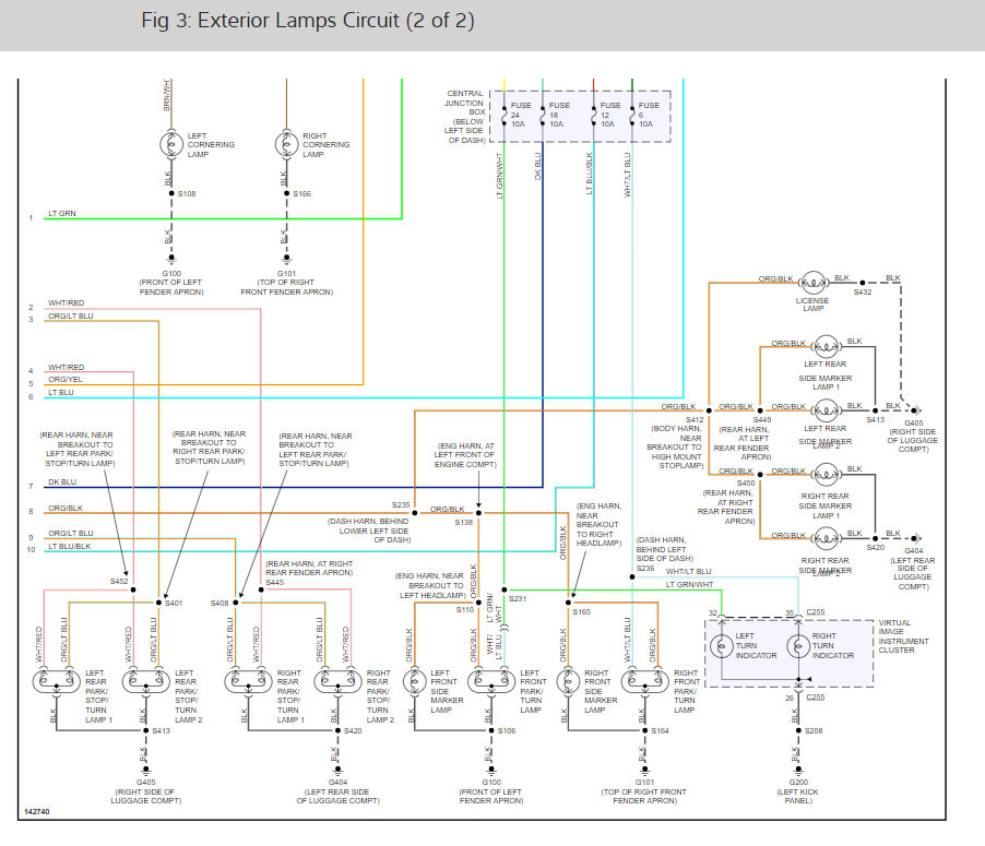

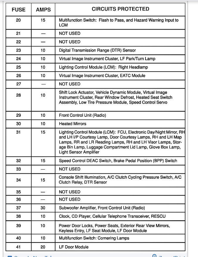

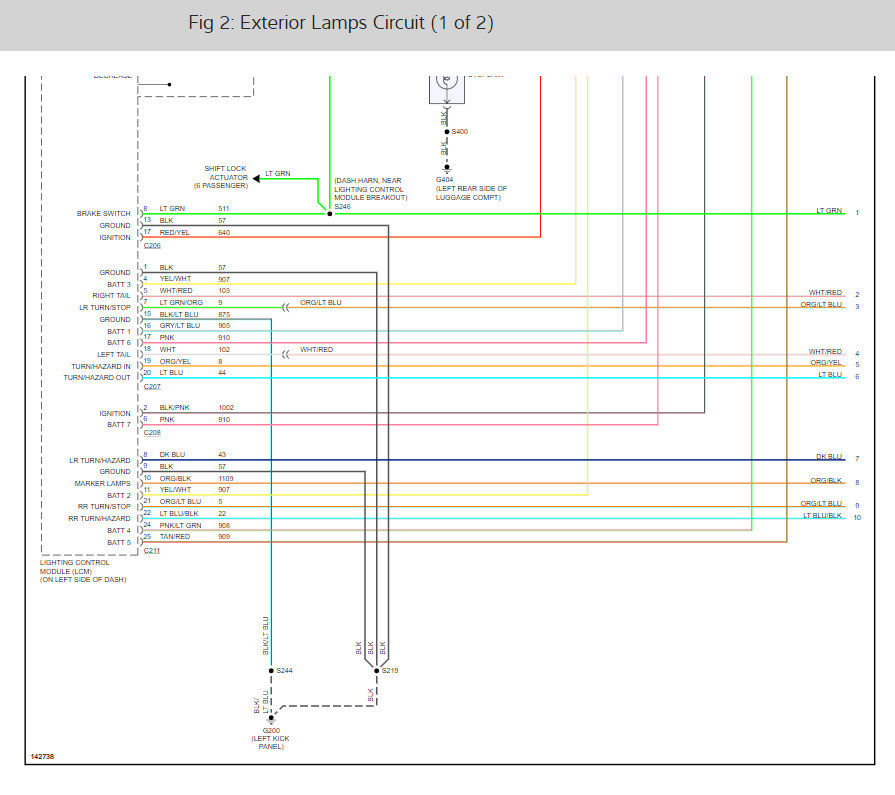

We replaced the heater core and the rear left light does not work at all. Everything else works. But not that. We replaced the light module and that didn't fix it.
Nov 12, 2019 at 1:39 PM
  • 55,443 POSTS

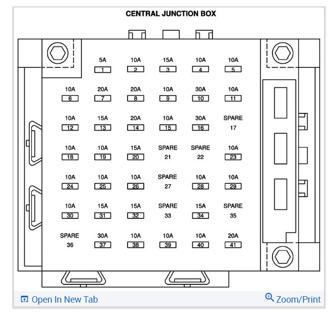

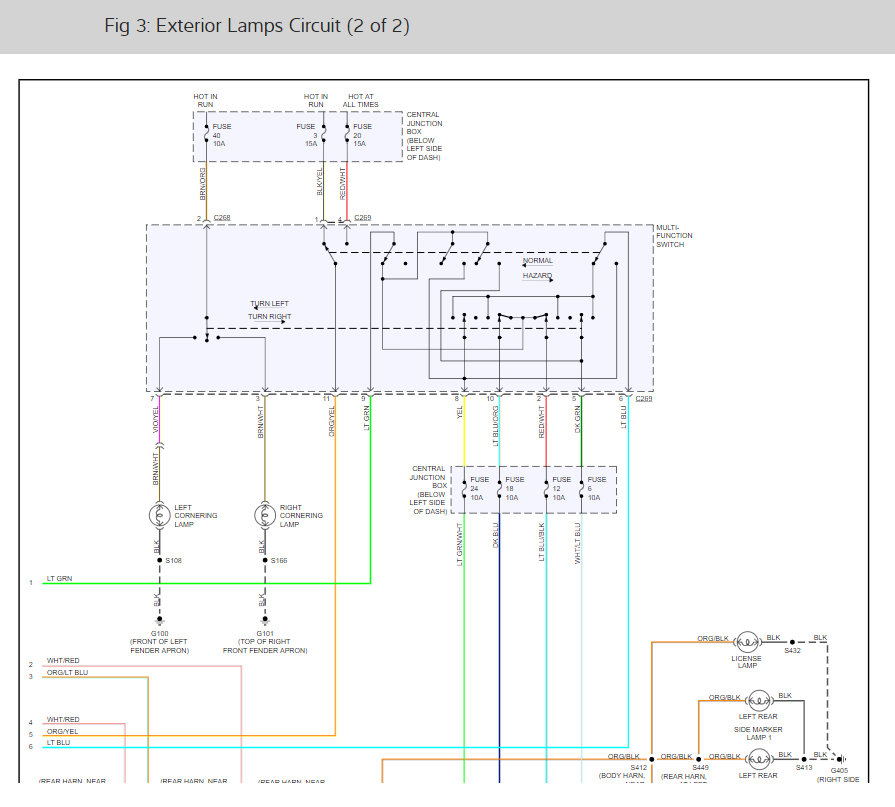

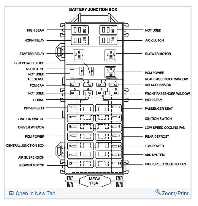

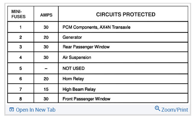

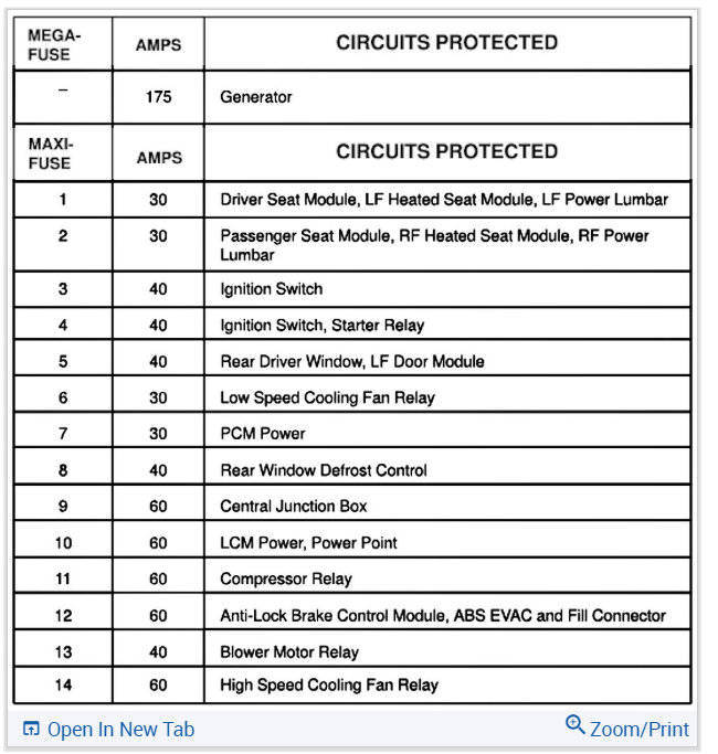

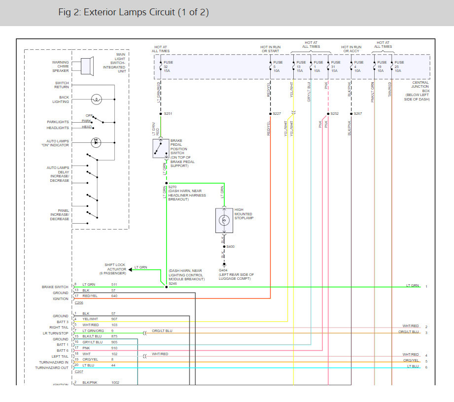

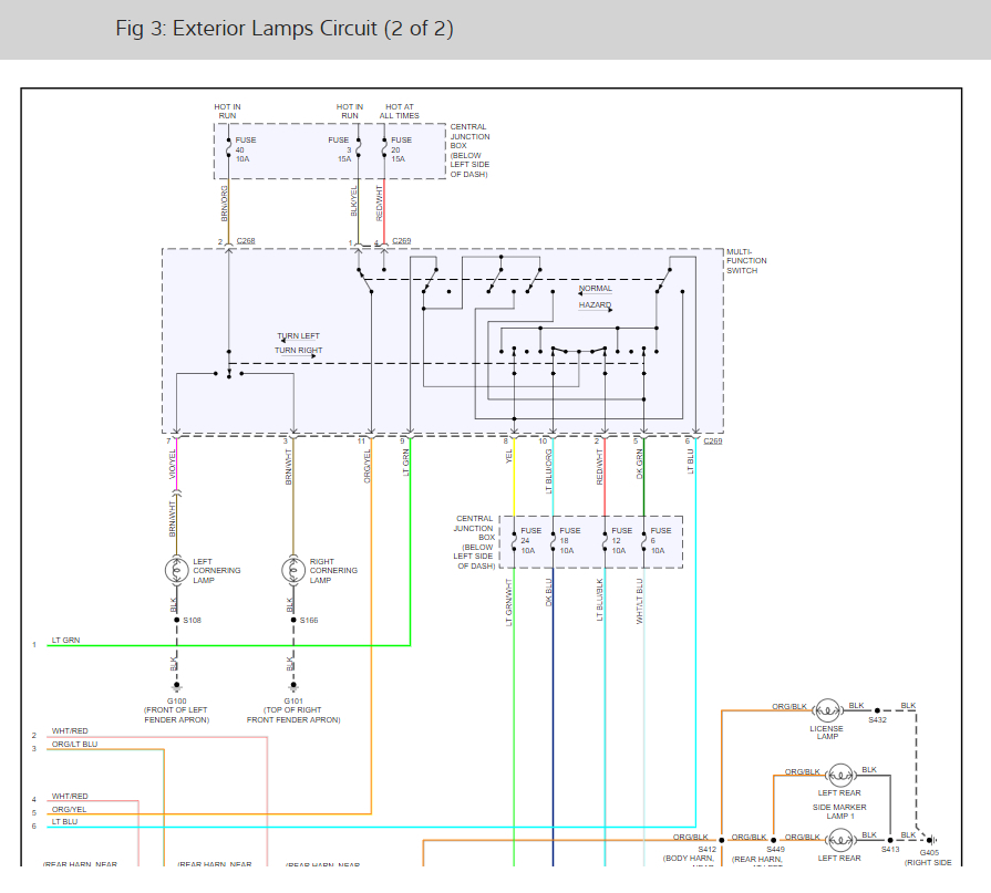

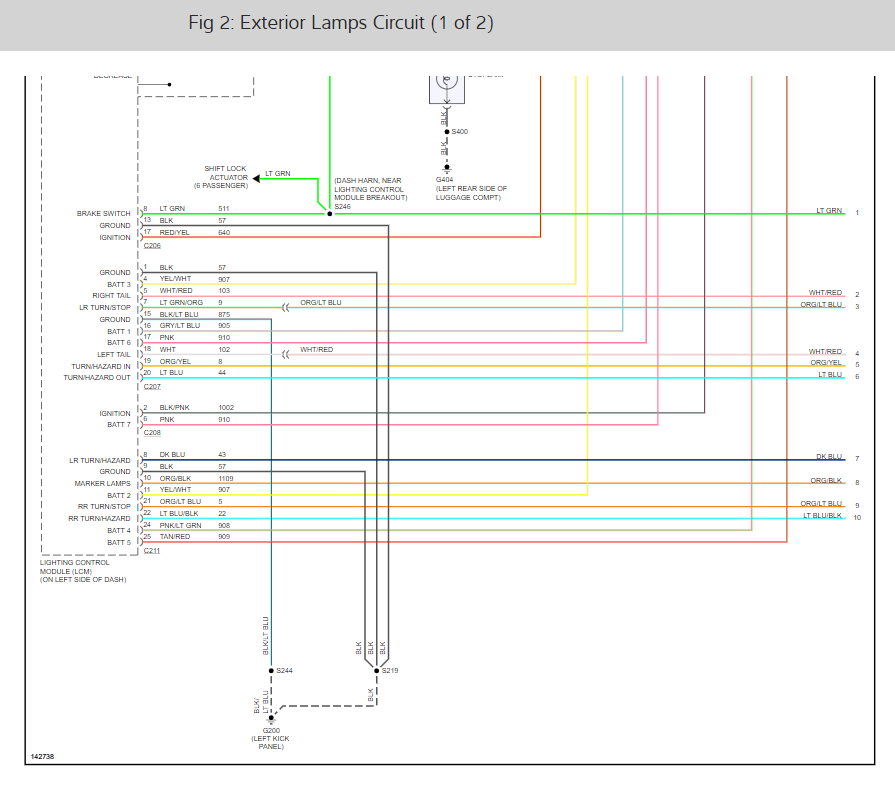

There are 12 fuses that run the system we need to check. here is a guide and the lighting wiring diagrams so you can see how the system works and which fuses to check I have also included the fuse locations as well:
Nov 14, 2019 at 2:38 AM
JBENSON87
Okay, i checked all fuses and relays they all work. There is no power going to the rear light.
Nov 15, 2019 at 1:02 AM
  • 55,443 POSTS
15 fuses run the system I just to make sure you checked them all?
Here is a guide to help us see whats going on:
https://www.2carpros.com/articles/no-tail-lights-exterior-running-lights-tail-lights-out
Please use a test light and see if there is power at the fuses and at the lighting control module. Use the wiring diagrams above to see which wires to test for power/ground.
