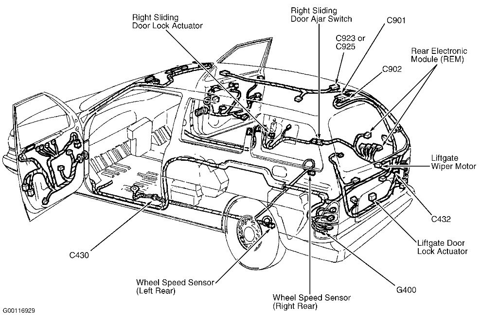

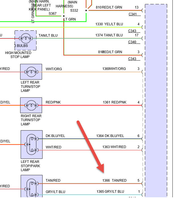

there is a rear electronic module at right rear quarter panel that may be screwing up. if your top and lh stop light work ok then check the wire marked in pic for power with brake applied. if it comes out of there then you have a short between that and taillight. it can also be scanned to see if it's bad auto parts can't do that though

I checked and there is no rear electronic module at right rear quarter panel. The only thing there is a place to put a jack.

here is pic of where rear module is supposed to be it does have it otherwise you will not have any lights in rear. pic is from ford manual. also check fuse 8 and 16 in central junction block. also fuse 119 in battery junction block although I don't think that would be the problem. if you cannot find the module then have it scanned for codes a mechanic will need to do it.

one other thing check for corrosion on plug in at rear module if it is clean what you can then put dielectric grease on contacts you can get a little package at auto parts for around $2

Do you have to take the whole rear left panel off to find it? There are not sections that come off easy, except for the jack storage area.
Mar 21, 2016 at 6:51 PM
HMAC300
  • 48,601 POSTS
yes the whole panel may need to come off to access it as it is probably above the jack area. we don't have instructions for that
Mar 22, 2016 at 6:01 AM
ELLEN GAUTHIER
  • 6 POSTS
I didn't get the back Right panel, looked like I would have to remove the strip that goes close along the carpet inside the Right sliding door, and it didn't want to budge. Also, I would probably have to remove the rear seat to have room to pull the bottom of the panel out so I could get it out of the top that it slides under. ANY WAY, WHAT I DID DO WAS TAKE THE COVER OFF THE JACK STORAGE UNIT, AND I FOUND A LARGE CLUMP OF WIRES AT THE BOTTOM AREA BEHIND THE FOAM LIKE SHEET, AND I FELT AS FAR AS I COULD ALL AROUND IT, BUT FOUND NO OTHER WIRES OR LITTLE BOXES. RATS!
