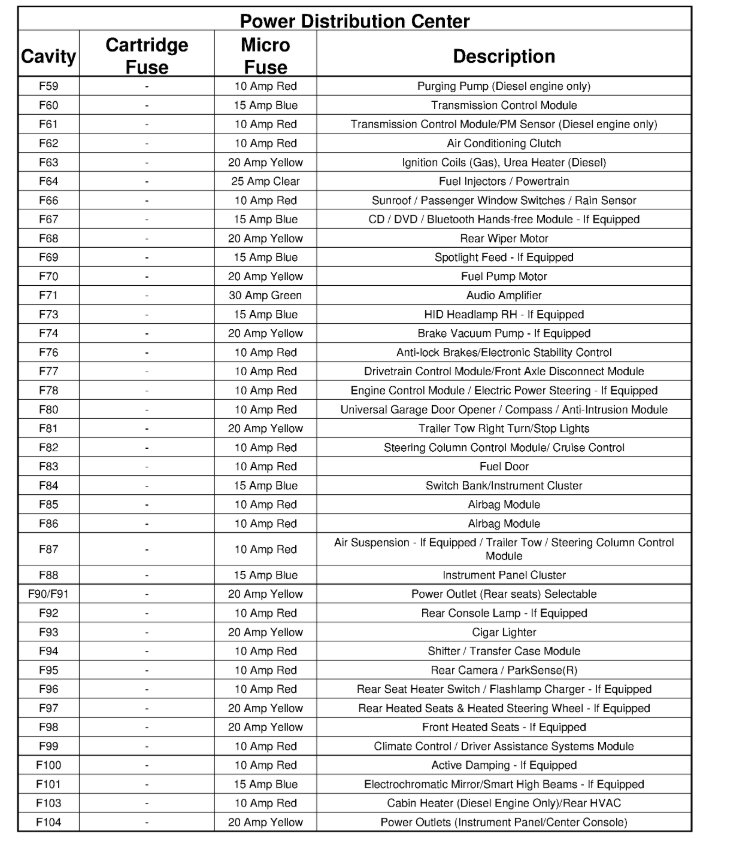

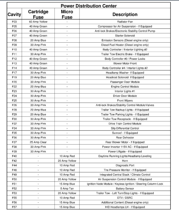

Two things could have happened; either some fuses blew when you were connecting the electrical or you have a BCM that is going out. Lets start with the fuses. here is a guide to help us check for power and to see if the fuses are good along with the fuse location and descriptions. Test with the key in the on position.
If everything looks okay fuse wise I would think the BCM is out but to be sure. here is a CAN scan which must be done to confirm the issue:
https://youtu.be/InIlnsjOVFA

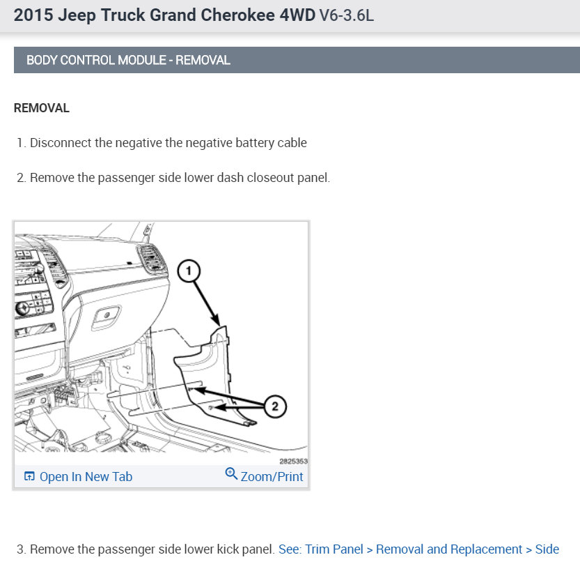

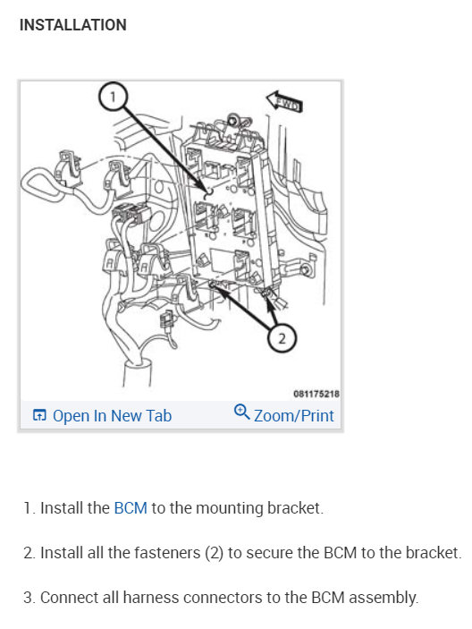

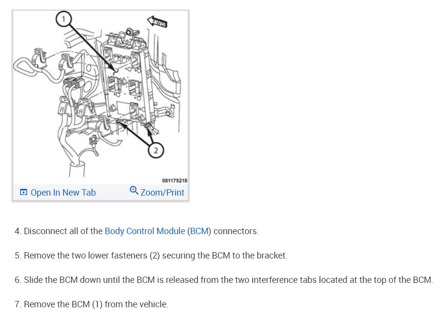

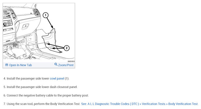

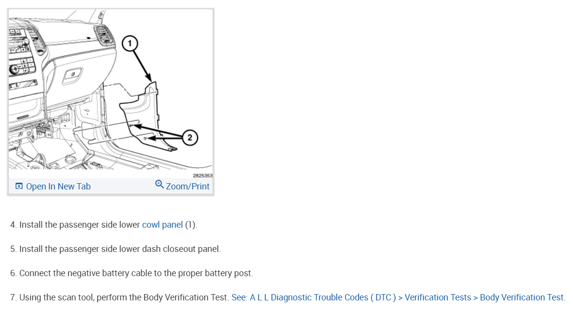

Here is how you replace the BCM and the unit location below as well. Check out the diagrams (below). Please let us know what you find. We are interested to see what it is.

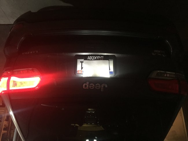

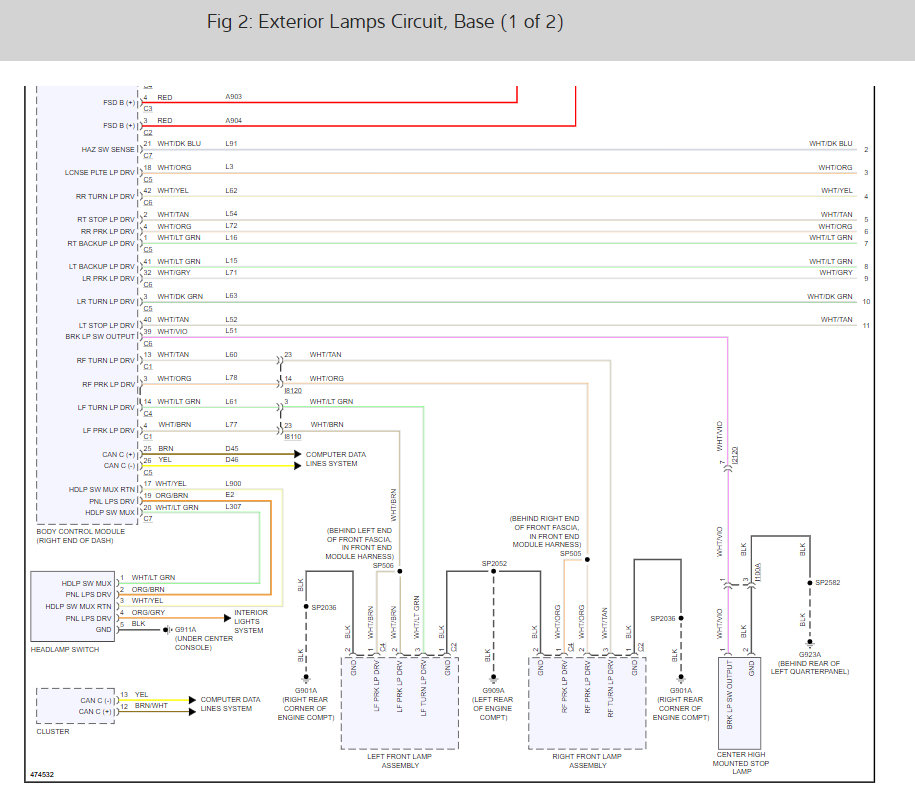

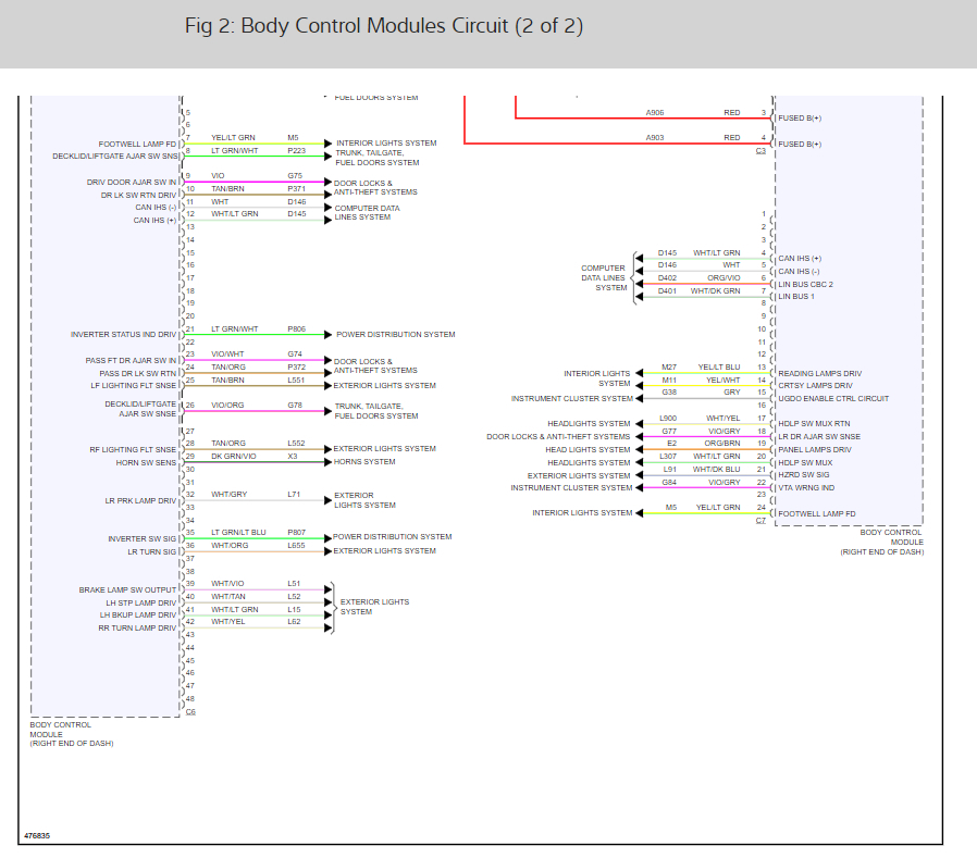

But! I will reiterate what I had planned to say before, below. Anyway, now that I've gone out and checked the fuses...and they are all good, I went a head an bought a test light just to be sure, so when that comes in tomorrow I will look into that again just to make sure I'm not crazy. But thinking about this some more, I had thought maybe it was a faulty relay somewhere. But now I'm thinking that the BCM is probably the issue. Pressing the locks yields a response (not the one we want but..) when I press the locks on the inside, it will click at the BCM and the lights on the dash and the gear shift light up, so there is acknowledgement of the locks being initiated. If I press it on the key-fob, the head lights and tail light blink, so the care acknowledges that as well. If the BCM controls the tail lights (maybe you know this better than I do) then perhaps this is why that left one is out of wack as well (the only thing that worries me here is that the multi-meter detected no power at the tail light socket, however I could have been doing something wrong).

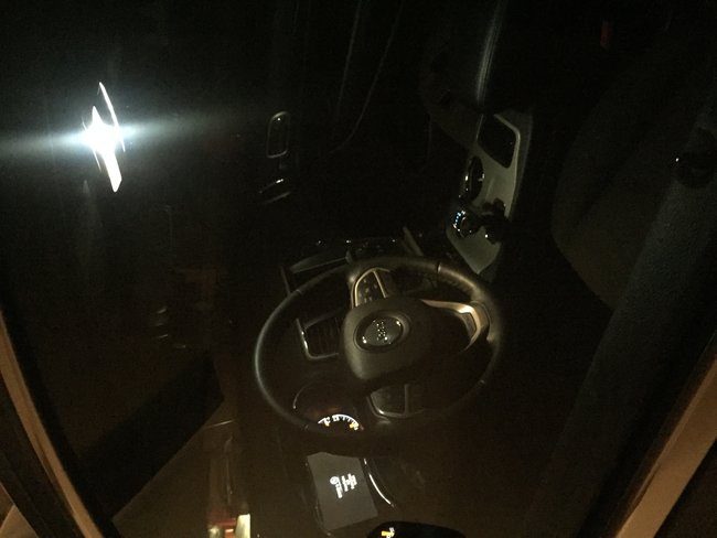

The door sensors must be integrated in the BCM as well, because the dome lights and the radio are in working conditions but they don't respond to the doors being opened. However I can place my hand on the door handle from the outside and the dome lights will come on and the dash lights up, so there is acknowledgement there as well.

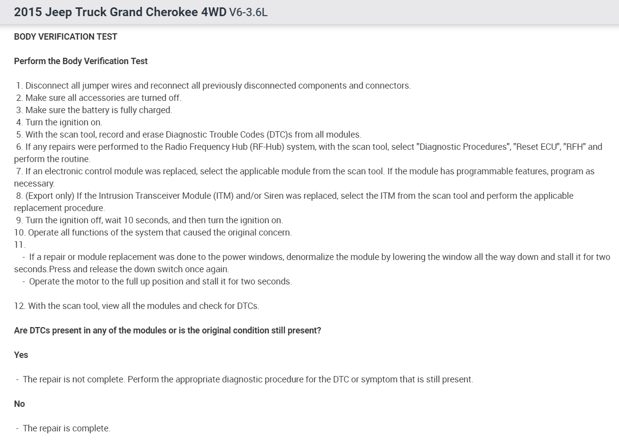

I'm ready to buy a BCM! But I'm listening to what you say and trouble shooting first. But thinking ahead, is the BCM in a 2015 Jeep just a plug and play? Disconnect the battery,, unplug the ports, disconnect the old BCM, install the new one, plug in the ports, and reconnect the battery? If so, that's easy enough. if it has to be programmed and such...well where do you get that done at? (please don't say the dealer)

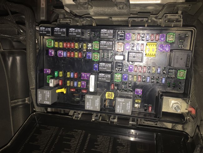

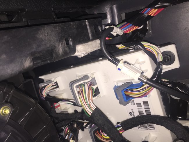

added some pictures as well. why is one upside down?. No clue!

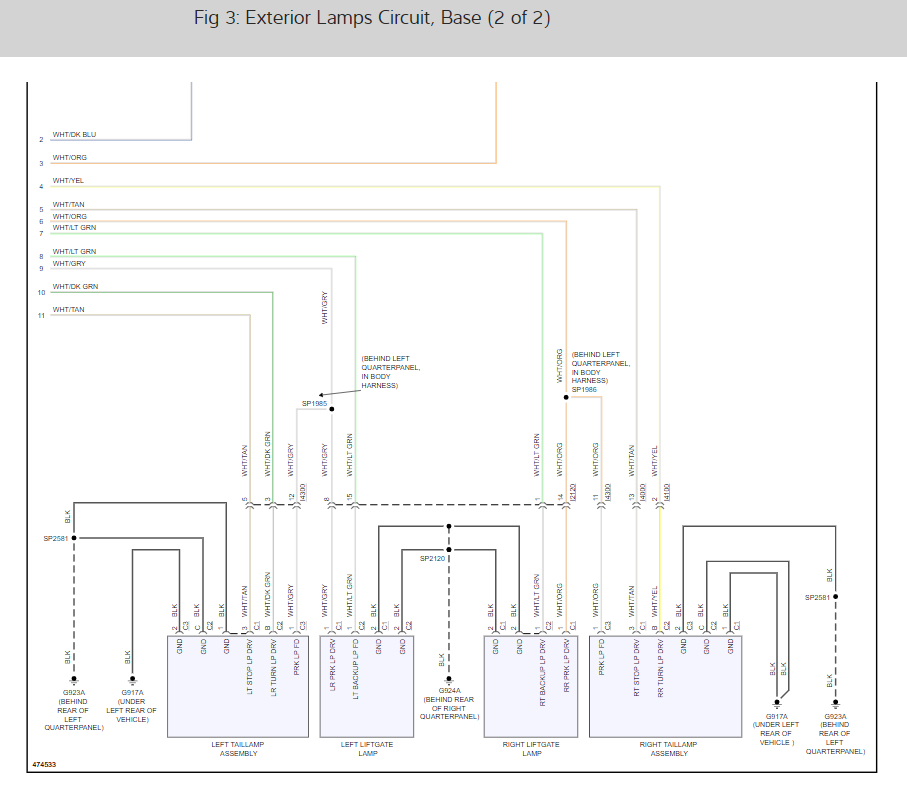

1. the tail light out (it's the whole unit!).
2. touching the door handle lights up the inside of the car.
3. the BCM you know what that looks like.

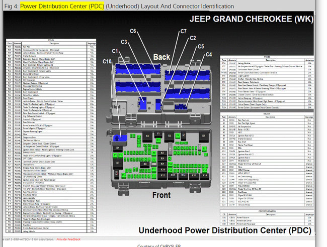

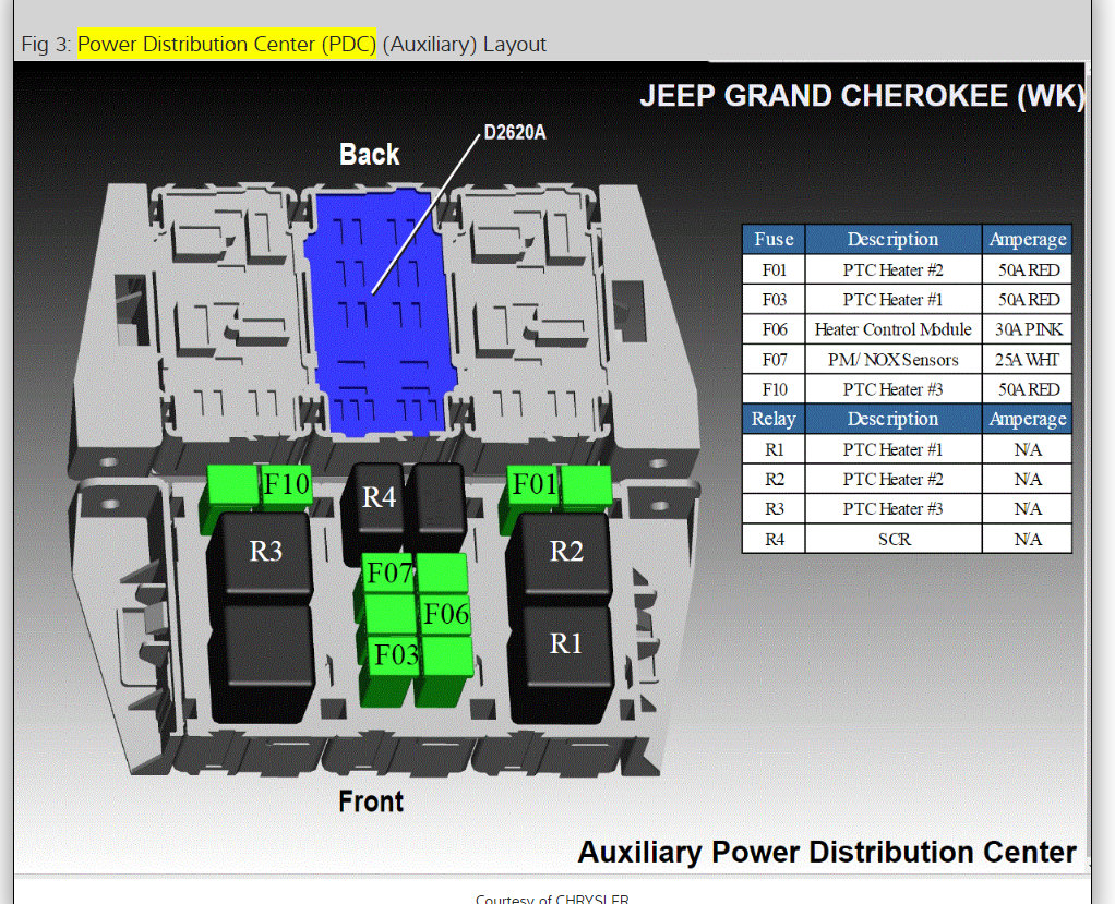

4. the fuse box.

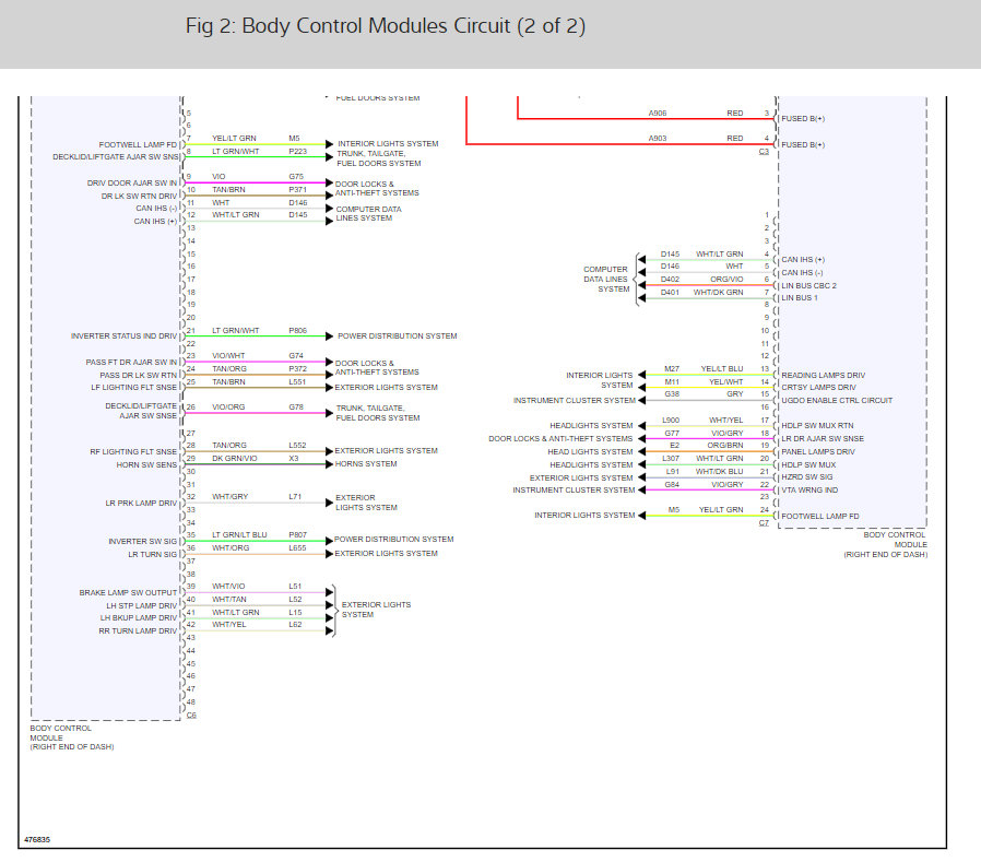

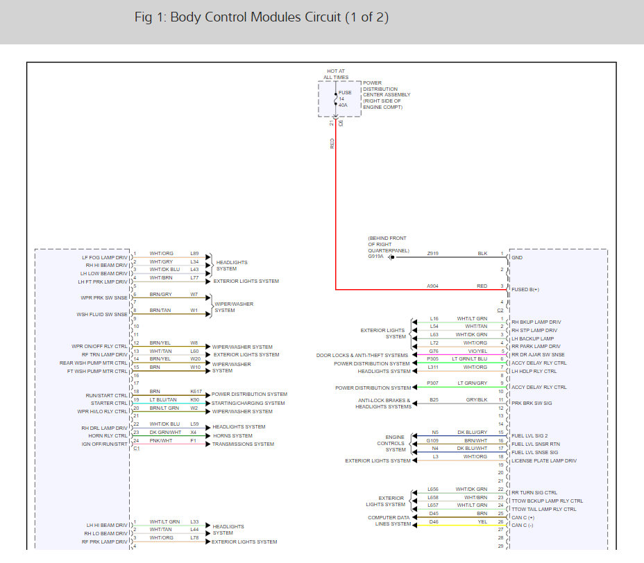

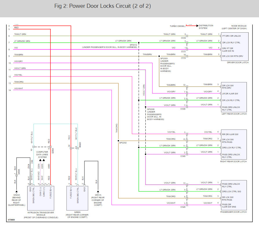

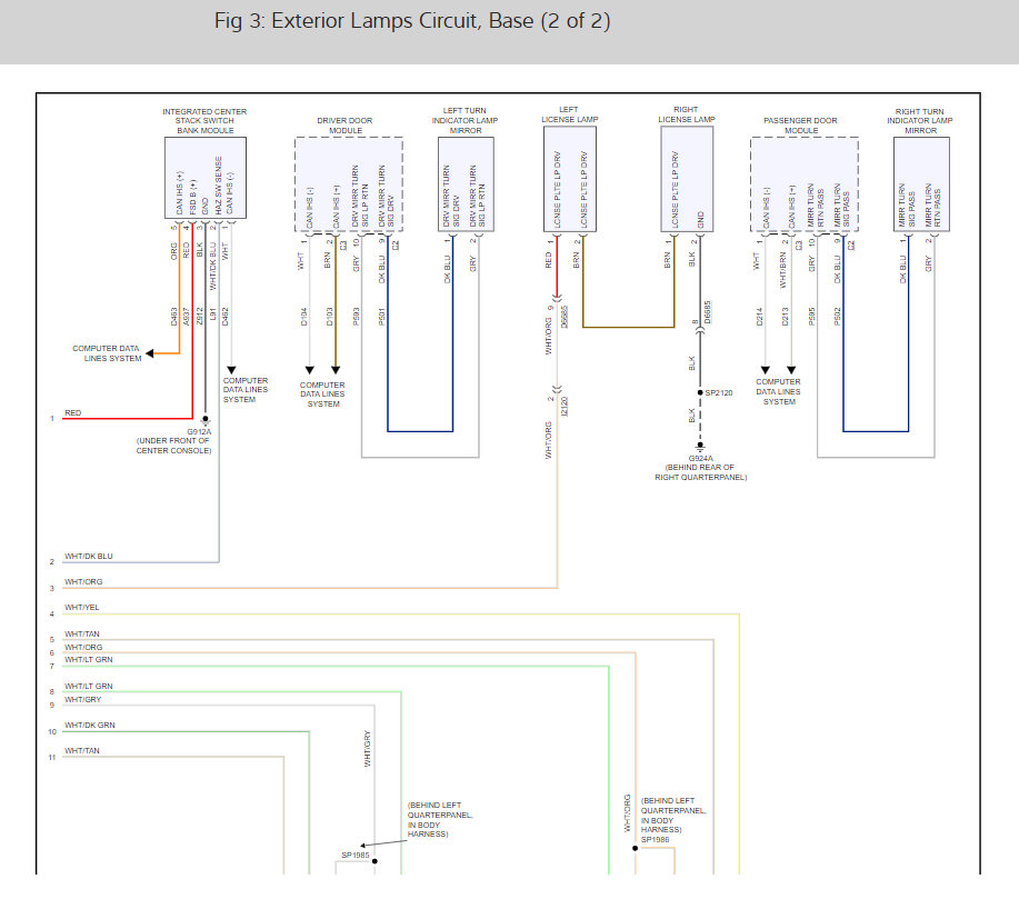

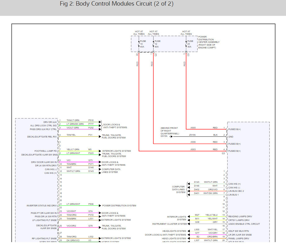

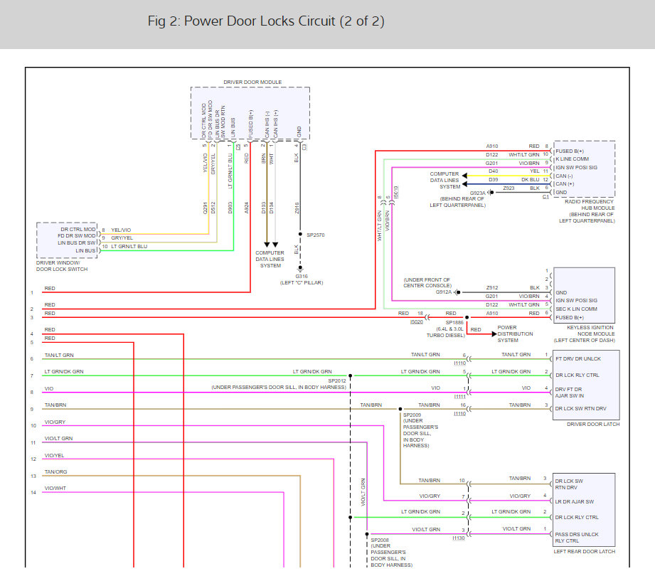

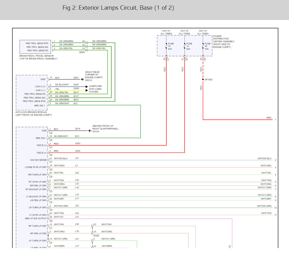

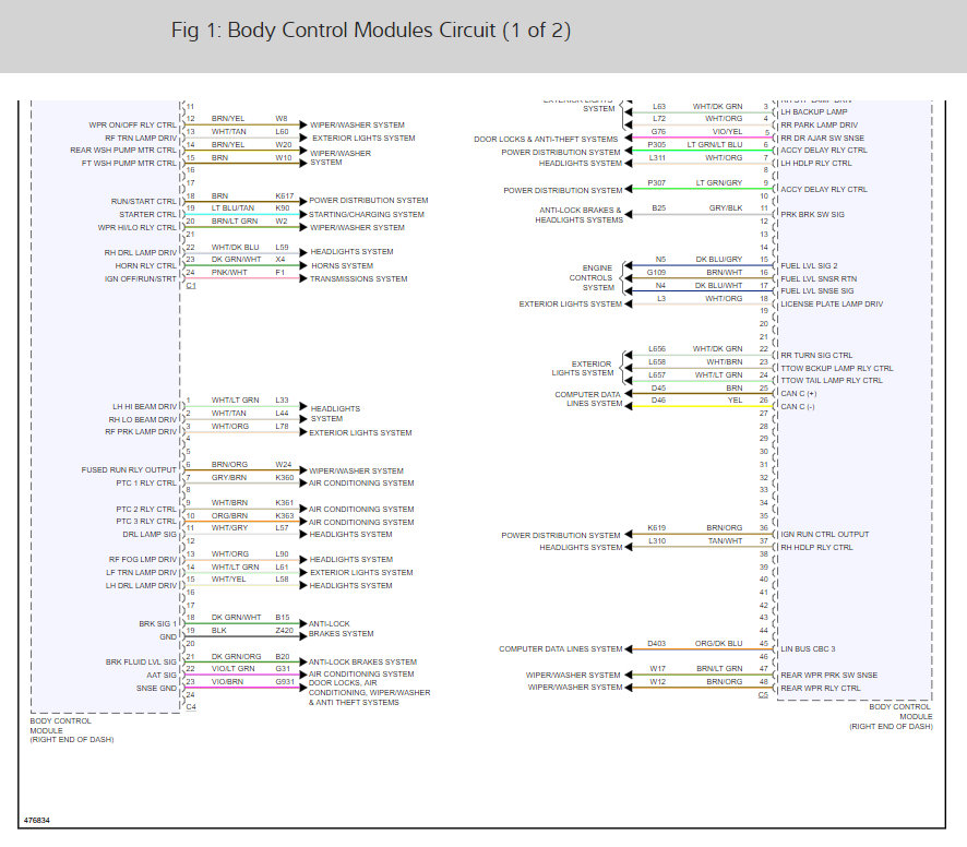

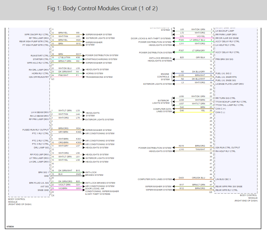

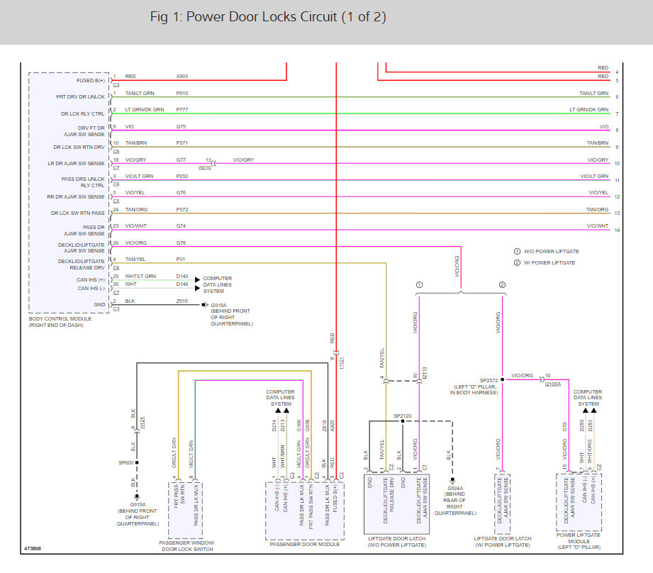

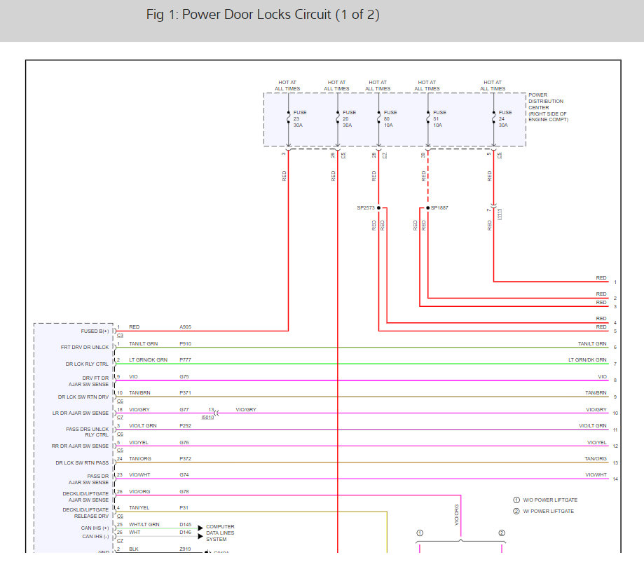

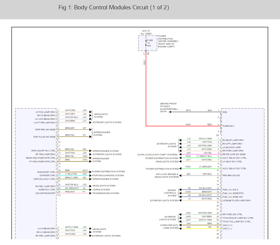

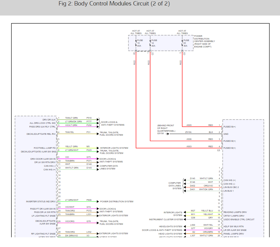

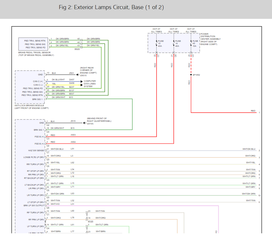

Nice work, there are fuses we should check for power before (#14, 10, 12 and 23) we replace the BCM which ties these systems together which you can see from the wiring diagrams below. The BCM must be programmed and is not plug and play like the TIPM is. Check for power and check out the BCM, door lock and blinker wiring diagrams below. Please let us know what you find.

okay, well those diagrams made me feel stupid. Because Lord knows I don't understand anything about what they mean! But, here's what I found: I checked on the fuses; now the small fuses light up on both test points, but the fuses that we needed to check are larger 30 and 40amp fuses. Well to you can't check those with a test light (or so I believe) I decided to take those out again, inspect them and then test the prongs that the fuse would sit on. I noticed that one prong lights up, but the other prong doesn't. all of them did that. now that must be normal because if power was being interrupted then things in the car wouldn't work. (Correct?)
