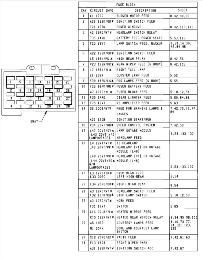

No lights on with the dashboard and alarm sometimes disables to turn on car.
Aug 4, 2022 at 6:30 AM
  • 55,594 POSTS

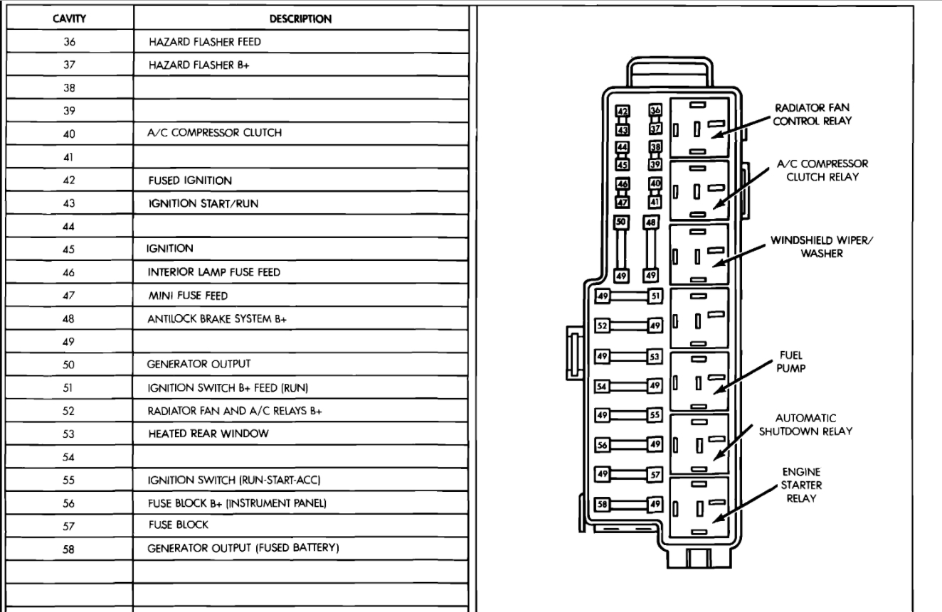

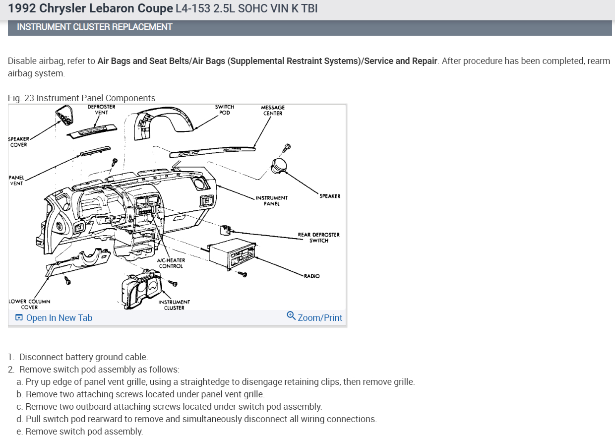

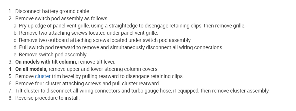

This can happen when the dash cluster shorts out, but we should check all fuses and then run the codes. here is a guide to help and I have left cluster replacement instructions in the diagrams below just in case:
and
