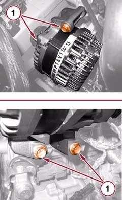

Remove the nut and disconnect the B+ electrical connection (1) from the generator.
pic 4
Remove the upper and lower generator mounting bolts (1).
Remove the generator from the engine compartment.

Install the upper and lower generator mounting bolts (1). Tighten the bolts to the proper (Torque Specifications) .
pic 6
Connect the B+ electrical connection to the generator stud, then install and tighten the nut to the proper (Torque Specifications) .
