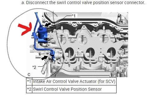

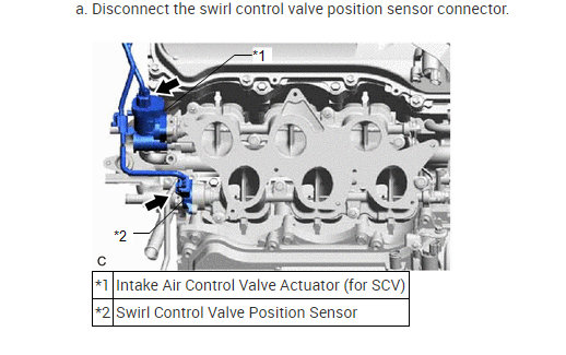

The code you indicate deals with swirl control valve position sensor voltage. Basically, the voltage is too high (above 4.8v). That shouldn't have anything to do with the hazard lights. The only thing I can think of is if somehow when replacing the coils/plugs, something was shorted, specifically the swirl sensor. That would indicate the high voltage, but not the lights.
I attached a pic below showing the location of the swirl control valve position sensor. It is in the rear of the engine. Check to see if anything has damaged the wiring to it and if something is shorted to it.

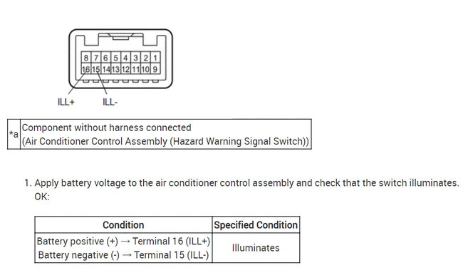

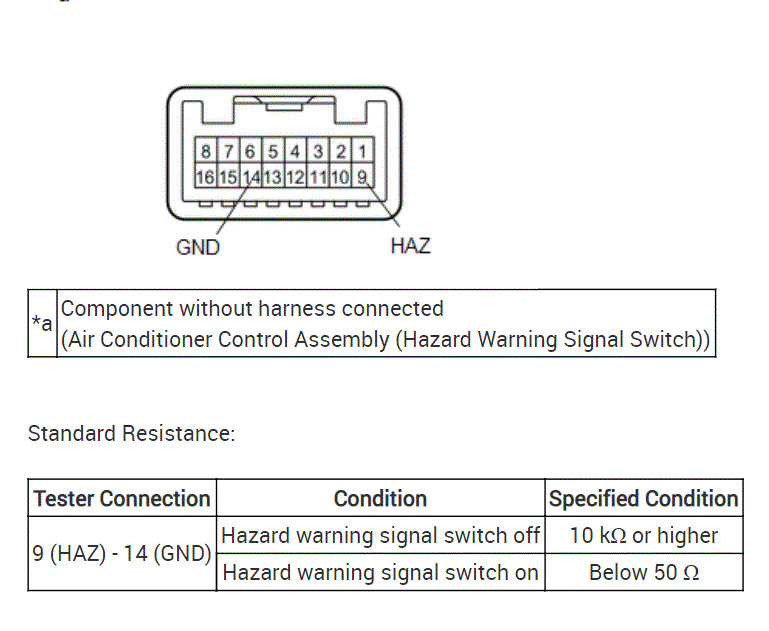

As far as the hazard lights, here are the diagnostics for testing. The remaining pics correlate with the directions.

INSPECT AIR CONDITIONER CONTROL ASSEMBLY (HAZARD WARNING SIGNAL SWITCH)
Measure the resistance according to the value(s) in the table below.
Pic 2
If the result is not as specified, replace the air conditioner control assembly.

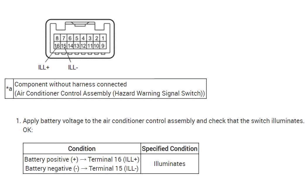

Illumination Inspection
Pic 3
Apply battery voltage to the air conditioner control assembly and check that the switch illuminates.

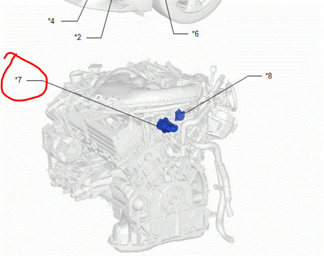

Okay, first i will like for you to check to see in front of the engine where the the intake manifold is to look for a three wire connector that you might have disconnected, connected make sure is seating correctly, then second is to snap a photo of the codes in system, and then clear codes, run engine and see if check engine light comes on again or it produces code, if it has a code for misfire (cylinder 6) then try to swap that sic cylinder coil with another, erase then run again for codes to see if the code misfire changes with the cyl that you changed with. remember there are two of them on each side of intake manifold.

The 3 wire connector is located at the back of the engine. I have seen many people pull the pigtail connector when removing the upper intake manifold to replace spark plugs/coils. The pigtail connector can be ordered separately from the dealer.
