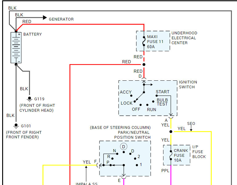

Background: car was mildly wrecked a few years ago, the hood, headlights, and grille crunched where it went under a jacked up truck. It still ran and drove and was parked in a shop with the intention of fixing the front. My neighbor bought it for $200 and had it towed here, but the keys are missing.
He replaced the ignition switch and new battery. Radio works, lights work, but nothing when you turn the key. I can hear a click under the passenger dash, and the electric water pump will come on, but nothing from the starter at all. We looked in all the fuse boxes and couldn't find anything related to the starter or ignition, where can we start troubleshooting?
Mar 14, 2024 at 8:23 AM
  • 110,244 POSTS

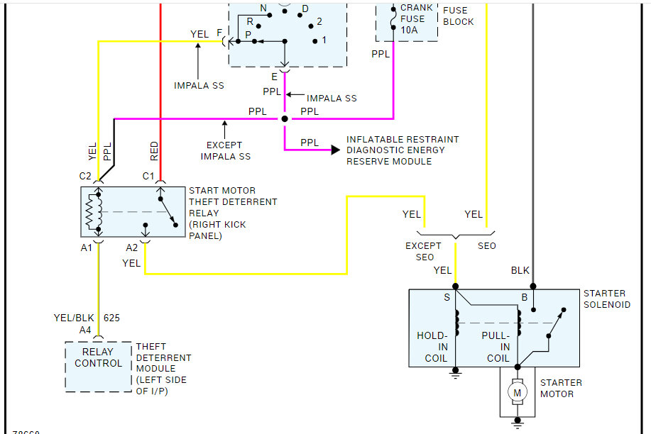

First, I attached the starting circuit wiring schematic below so that you would have a reference tool.
As far as the no crank, is the antitheft light staying on or flashing? Does placing it in neutral make any difference?
The idea that the ignition switch was replaced leads me to question if the new one was registered. There is a starter theft deterrent relay on the passenger side that I suspect is what you are hearing. If that is the case, then we need to check if there is power at the S terminal (yellow wire) at the starter itself when the key is in the start position. You will need a helper to do that. If there is power, then the starter motor is the likely issue.
See pics below. Note: I cut the schematic in half to make it readable. I did overlap the two so you can follow from one to the next.

We went through the relearn process multiple times. The pass key light just keeps blinking. I even unplugged the passkey wires from the ignition switch (two white wires) and it does the same thing. I suspect this ignition key switch doesn't have the passkey resistance, it's just a normal ignition switch that happens to fit.
I found the passkey resistance list on a Camero website and tried different ohm resistors from my electronics toolkit in the wire plug until I found one that made the passkey light go off entirely and the car cranks now! So, this new ignition switch definitely doesn't have passkey capabilities.

Sorry for the late response, we got the original ignition switch installed and it fires right up now. I think that the new switch be got didn't have the resistor in it and it didn't crank.
