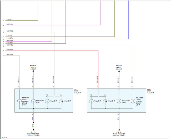

Hi

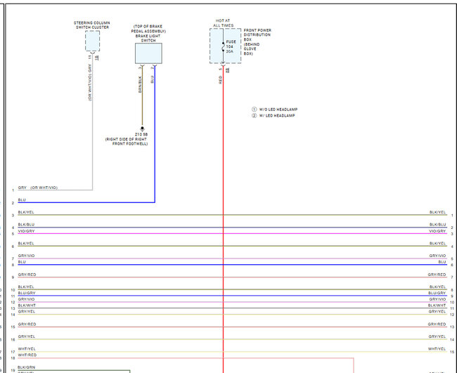

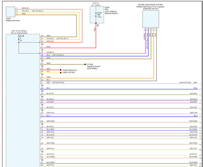

Hoping could help me out upon finding the interior and exterior fuse box locations ?
Along with workshop Manuel diagrams of the all lights and indicators wiring?
Am also need to know how to replace hood bonnet release cable as mine has snapped at the end of the cable to the release lever and I can not open the bonnet normally..
So that would really so much help me out majorly too ..
Truly greatly appreciate it ?
Thank you
Kind regards
Michael
Mar 18, 2026 at 6:13 AM
  • 54,840 POSTS

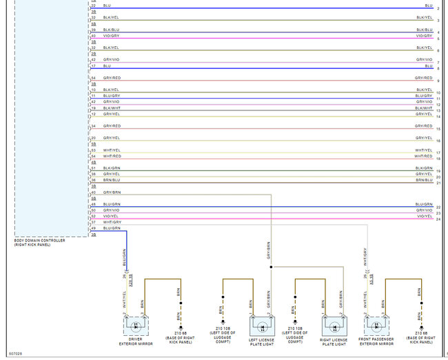

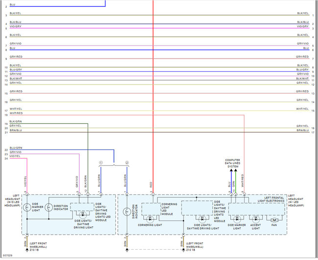

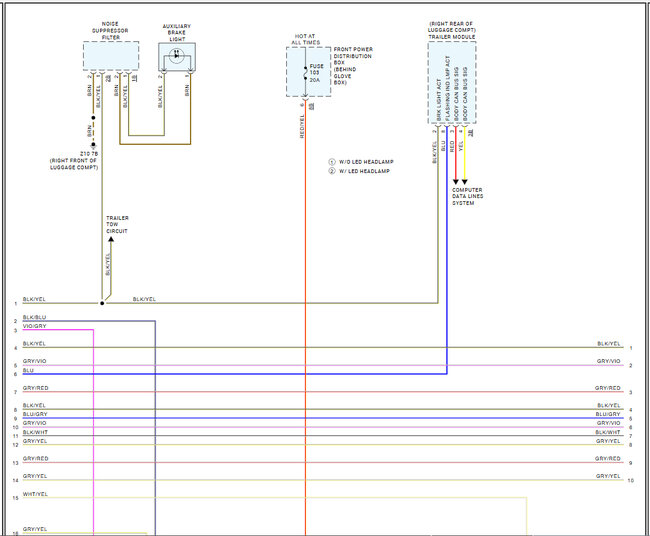

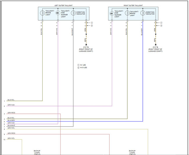

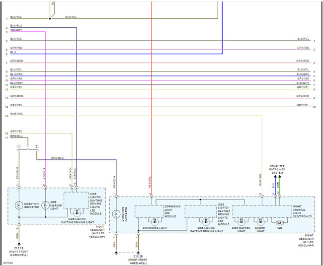

The main fuse access point is behind the glove compartment. Release the damper at the bottom, press the two tabs, and fold the glove compartment downward. You will see the fuse panel there. Here are the lighting wiring diagrams as requested, if you need more please use this link:
https://www.alldata.com/diy-us/en
Check out the images (below). Let us know what you find. Ken
