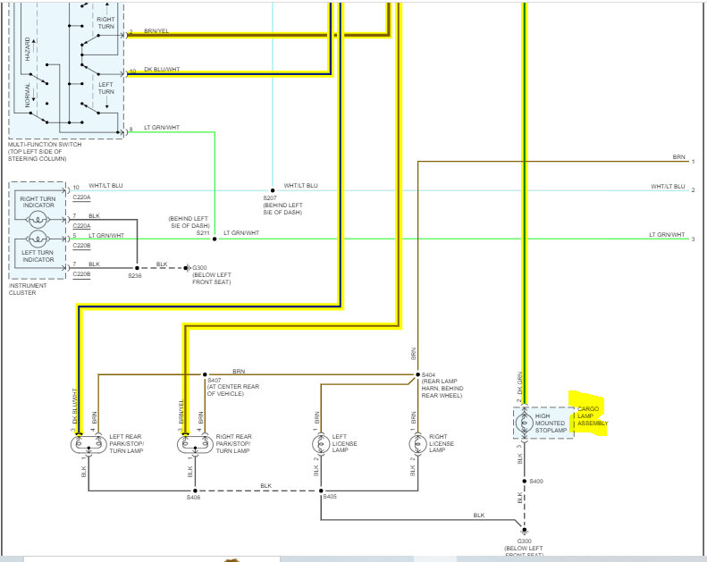

The idea that the center brake lamp (CHMSL) works tells me the circuit is likely okay, but there are different power supplies to the other lights not working.

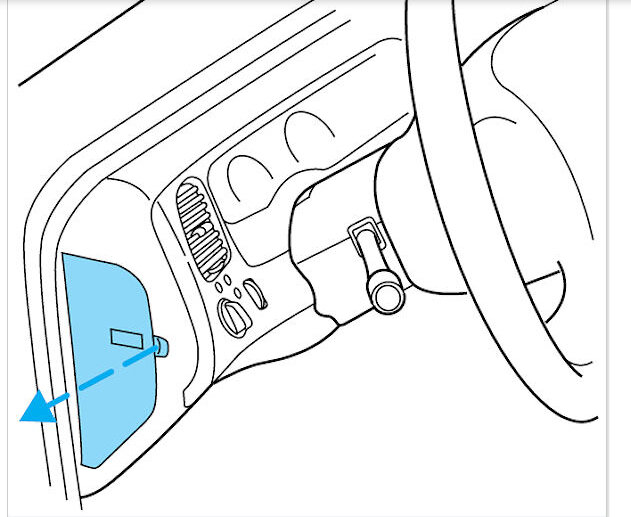

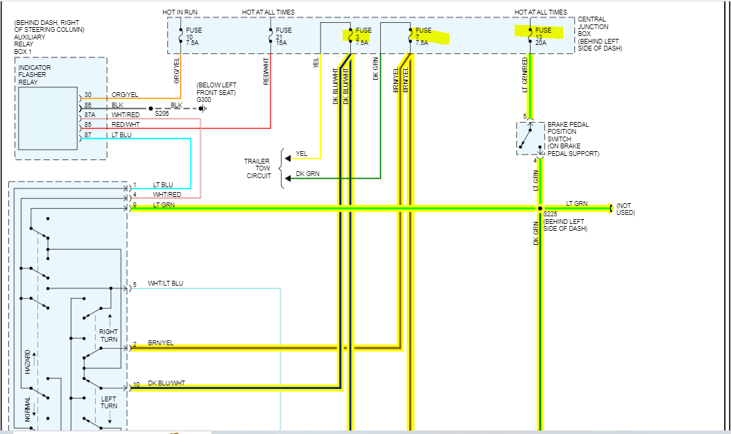

If you look below, I attached the wiring schematic. Note that there are three fuses I highlighted. Fuse 13 is the power source to the brake light switch (which works) and the CHMSL. Fuses 3 and 7 need to be functional as well. Check these first. They are in the central junction box under the dash. (See pics 3 and 4 below)
In addition to checking the fuses I mentioned, check all of the ones I highlighted in pic 4. It is important to make sure the fuse is good, but also, confirm there is power to and from them.

See pics below. Note: I highlighted the relevant wiring.
