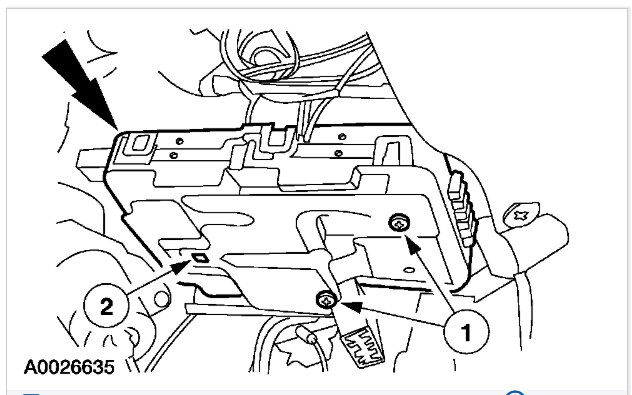

I have no brake lights. Parking lights intermittent. i check all the fuses. Gear shrift struck in park.

Yep, this happens when the lighting control module goes out, here is the location so you can swap it out. It is under the dash on the drivers side.

will LCM fix the stuck in park?

Maybe, can I ask if you checked the system fuses? Please go over this guide to check the fuses.
https://www.2carpros.com/articles/how-to-check-a-car-fuse/
and this video may help as well:
https://www.youtube.com/watch?v=G-xNK79Wa-w
If the fuses are okay replace the LCM and then start a new question oft he stuck in park problem. Sorry, we only handle one problem per thread, please post your new question here, you must be logged in.
