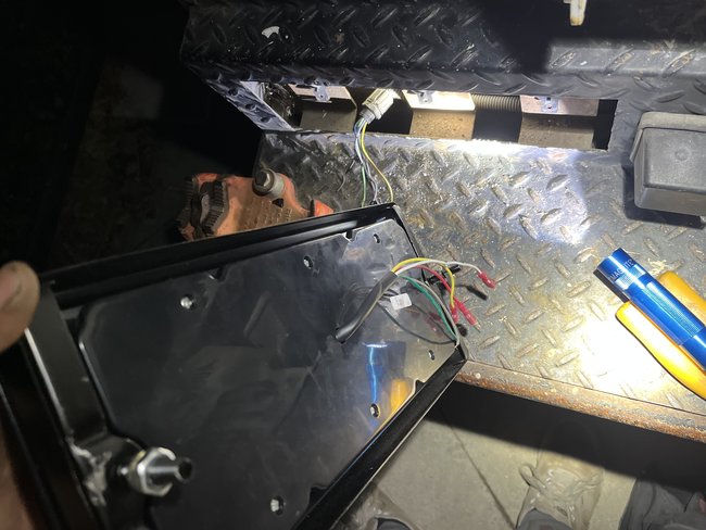

Originally there were seven wires to the reverse, brake, running, and turn signal lights, the new ones have five?
100,000 MILES • 8.1L • V8 • 4WD • AUTOMATIC
ARIANADANIELLE5345
  • 402 POSTS

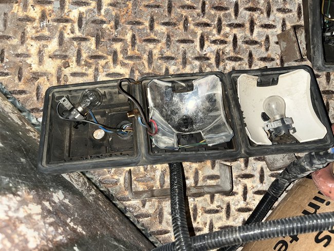

How do I connect them? On the new one red is brake light, white is reverse light, yellow is turn signal, grey is ground, and green is running light. On the original dark blue and black are reverse, brown, red, and light blue are running lights and brake lights, and green and yellow are turn signal. The first picture is the one on the driver side, the second picture is the one in the passenger side, and the third picture is the new one.

I think you got a light assembly for a different year or a different model. By chance, did you order a light assembly for a half-ton truck? There are differences between them.
Also, I need pic 3 to see what you purchased.

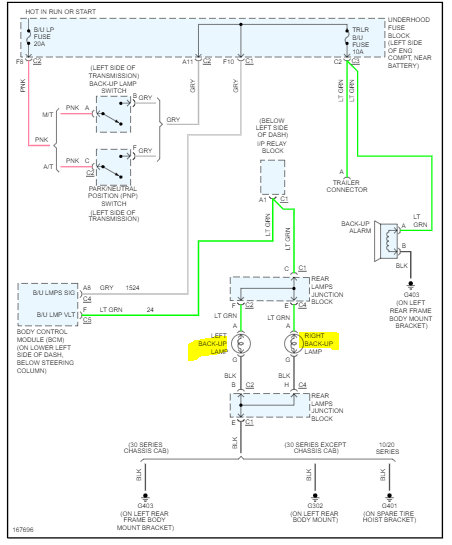

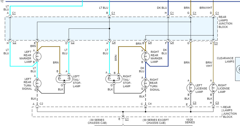

I attached what I'm showing for a 3/4 ton (2500) for the rear lights and the reverse lights on the vehicle you listed. Take a look at them and let me know if that is what you are seeing.

I got it all connected. I wasn’t the one who ordered the parts. I do always seem to get the cars with crazy problems lol. Speaking of which, I’m about to ask a new question about a Tiguan lol.
