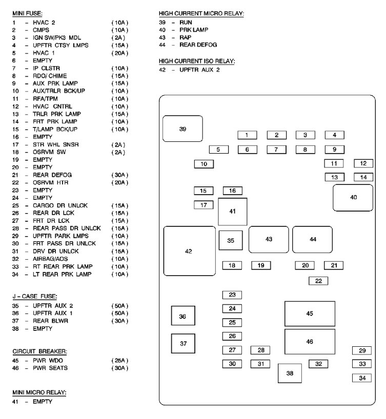

Rear left turn signal works but any other light on the right does not?
2009 GMC SAVANA
300,000 MILES
CONJAN
Bulbs are new, if you put them on the left, they work! which tells you no problem with lights... please help.
Dec 9, 2024 at 11:53 AM
  • 55,399 POSTS

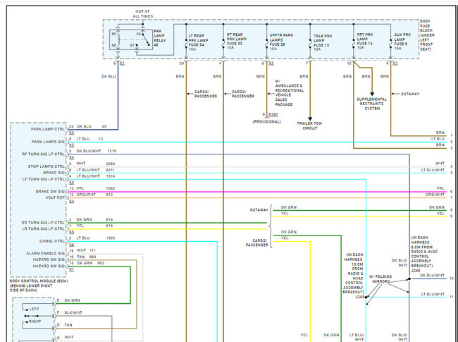

So no running lights (front or rear) or brake lights on the right operate, correct? There are a series of fuses that need to be checked. Here is a guide to help and the fuses listed below are the ones in question. If the fuses are good, it sounds like the BCM can be going out.
Check out the images (below). Let us know how it goes.
