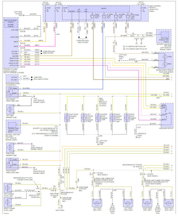

Front right turn signal blinks fast rear has no signal or brake working
89,756 MILES • 6.2L • V8 • 4WD • AUTOMATIC
VERNALEWIS
  • 8 POSTS
Checked for current none only ground. checked fuses okay checked wires for breakage couldn't fine any. I am confused.

DANNY L
  • 5,648 POSTS
Hello, I'm Danny.

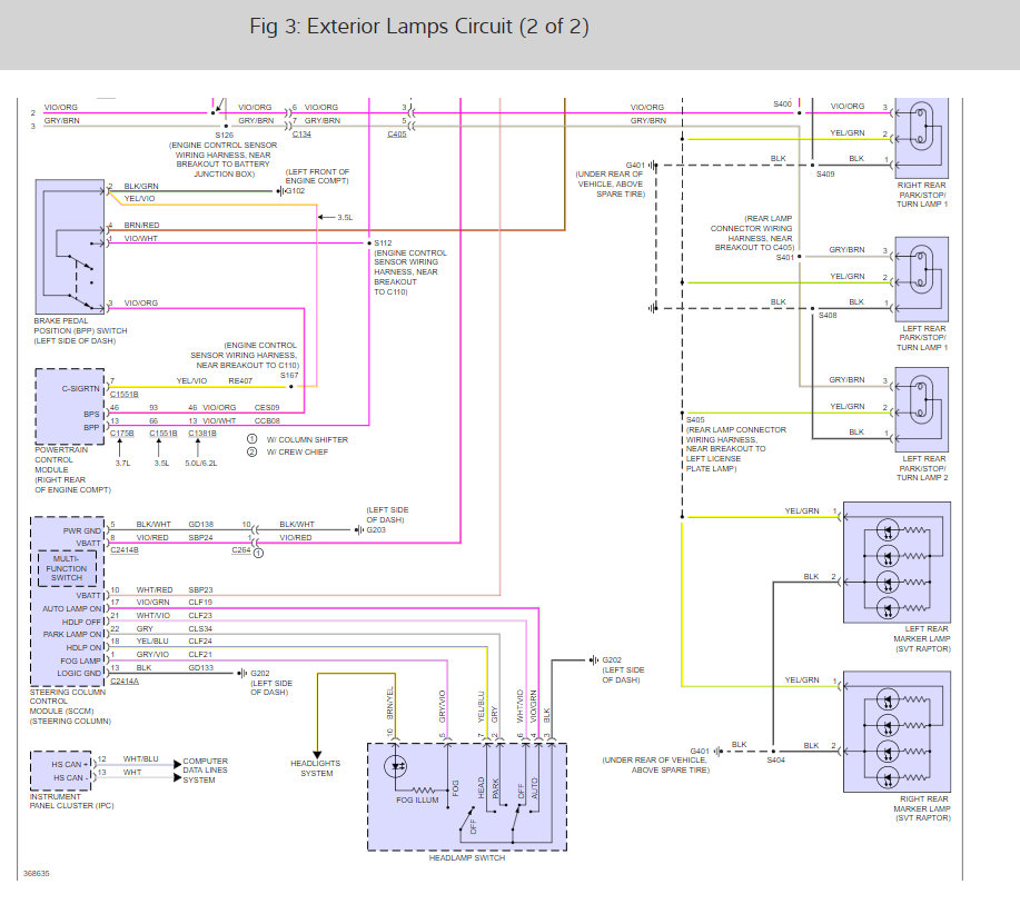

I'm just adding this diagram to help . This is for the rear lights to help check the circuit.There are more diagrams we can offer you. Hope this helps and thanks for using 2CarPros.

Thank-you, Danny. For the right side there is no power at brake switch only for left. So i jumped switch, brake light works. There are two relays for the left tt relay. you can hear or feel the right light relay nothing. can't fine signal flasher sounds like it is in the multi-switch. there is power and ground at the right tt relay.

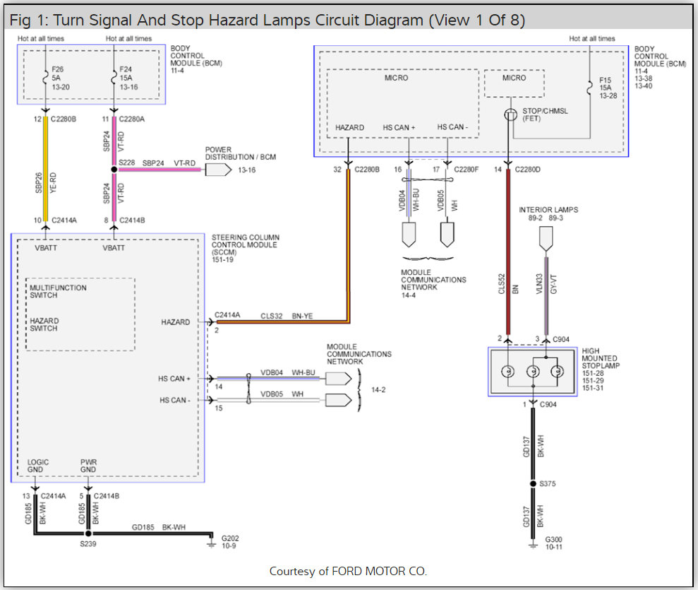

IS there any way i can bypass? shouldn't there be flashing signal coming from multi-switch on a wire?
Jan 22, 2019 at 8:54 PM
SCGRANTURISMO
  • 4,897 POSTS

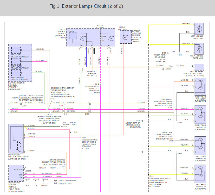

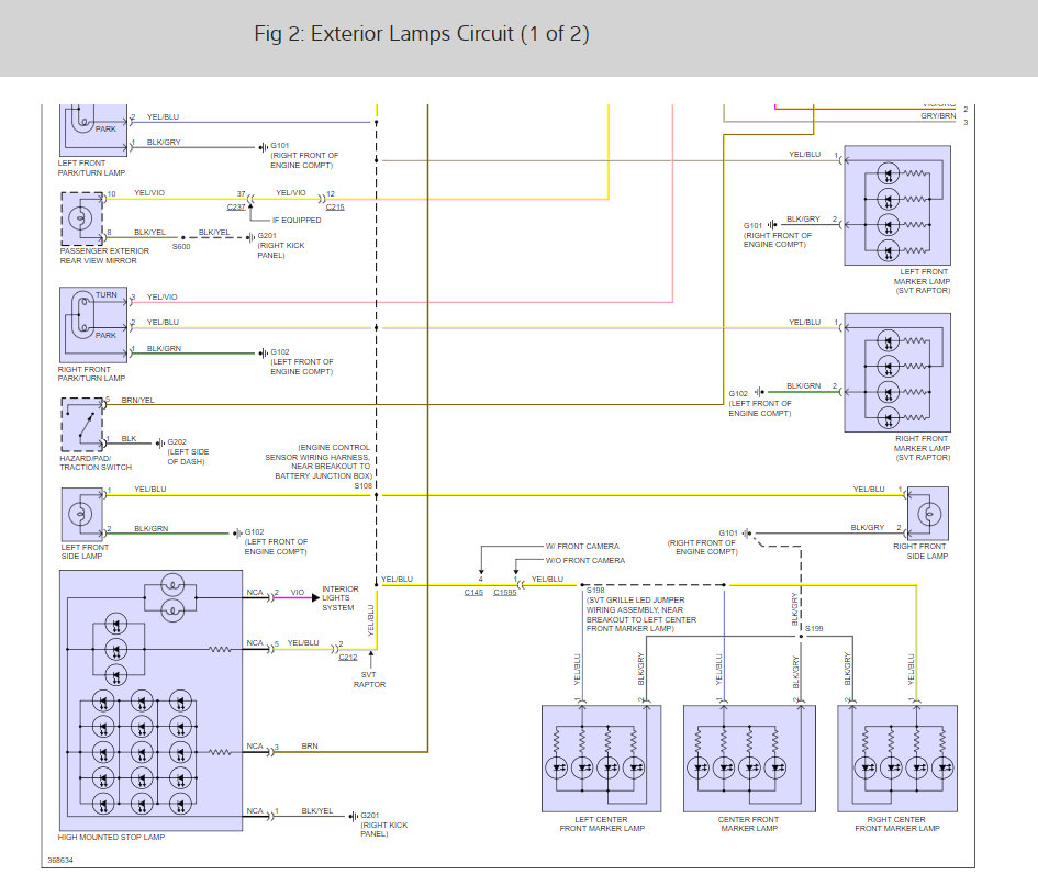

Hi Vernal, Here is a wiring diagram with the hazard switch in it. I hope this helps. Let me know if there anything else we can do for you. Thanks, Alex.

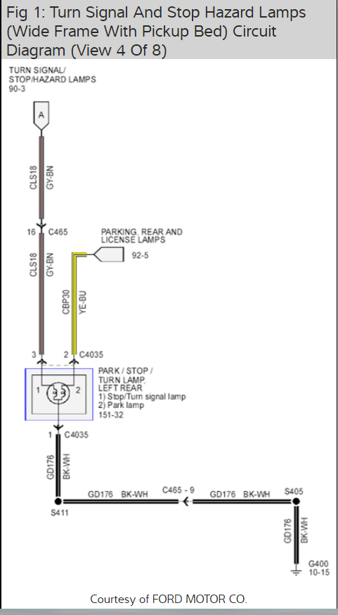

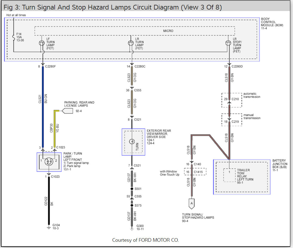

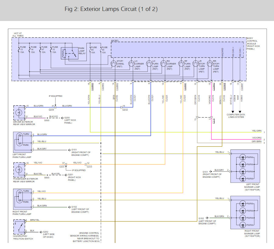

Thanks Alex,The diagram was to blurry for me to read.could i get another showing from the front to rear. thank-you
Jan 26, 2019 at 9:11 PM
SCGRANTURISMO
  • 4,897 POSTS

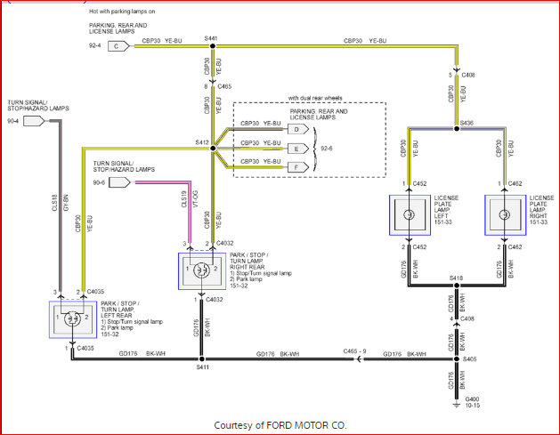

Hi Vernal, Here are the wiring diagrams you requested. I hope this helps. Thanks.

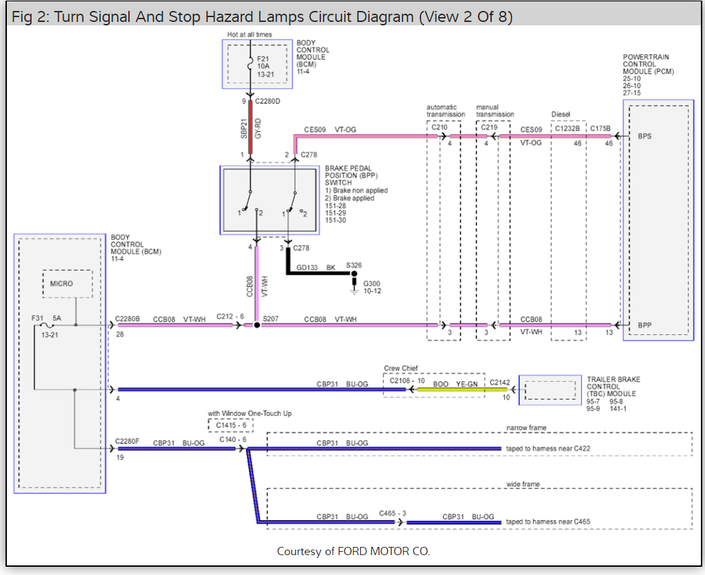

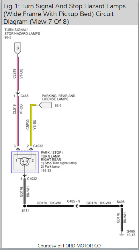

Will guys i'm back for more help. thank you for everything. I have got a short i believe with negative. Terminal off and test light connected to battery negative and negative. Cable tester lights. so i removed power wire from battery. Positive to pdb .and ran a new wire, still a short until i disconnected wires from brake master cylinder. Replaced power to pdb again test light came back on even with brake master plug still removed.wire from BCM flashes fast. thanks for your help.
Feb 19, 2019 at 5:47 AM
  • 55,743 POSTS

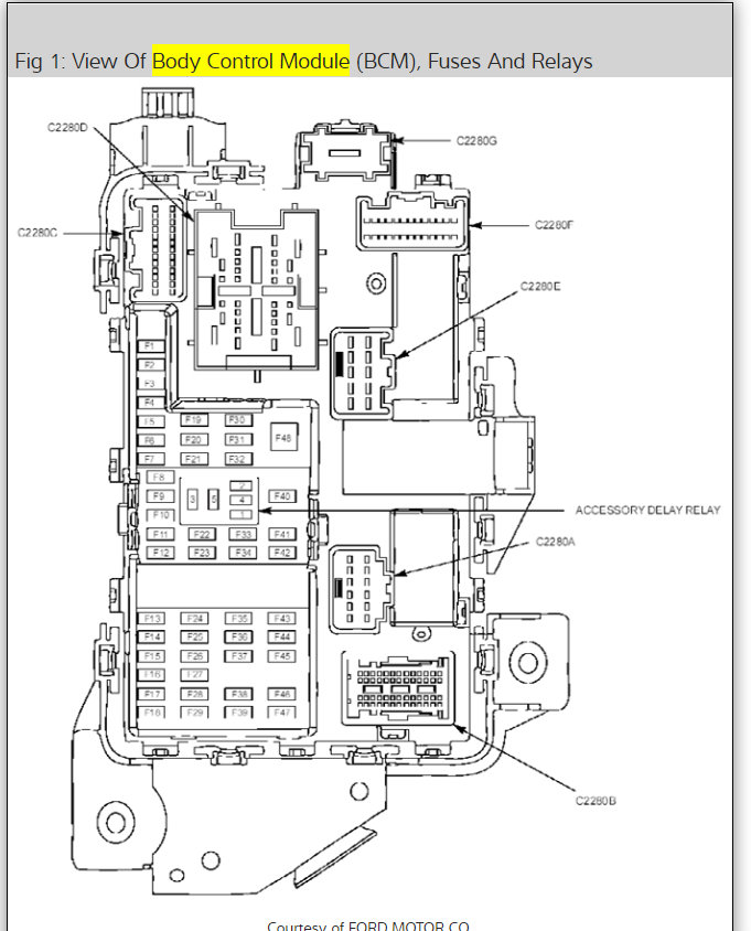

This sounds like a BCM failure to me but to be sure lets rung down the wiring diagrams flowing this guide:
You can do a CAN scan as well to help with the diagnosis.
https://youtu.be/InIlnsjOVFA
Check out the diagrams (below). Please let us know what happens. If the BCM is bad you will need to get it programmed which will run about $130.00 at a shop.
