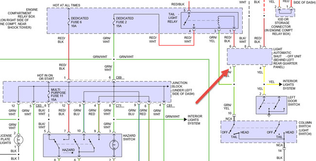

My dash, headlights, tail lights won't turn on its not the fuses or the switch I step on brake the brake lights work I signal they all work but lights won't come ?

I hope you have checked bulbs first. check the taillight relay and item in pic to see if it is sending power
