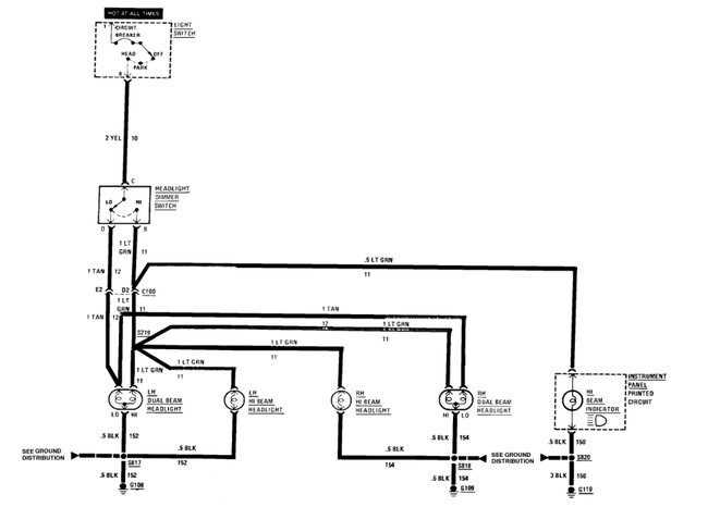

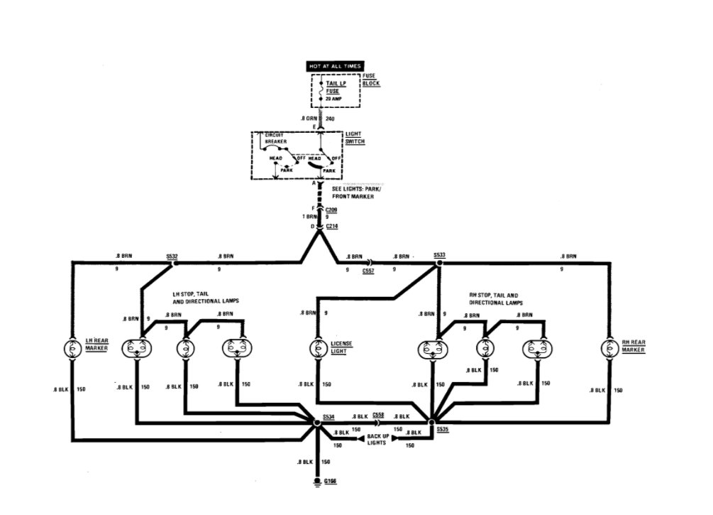

Are the head and tail lights connected by same wire?

Not on that car. The tail lights have a different power feed, the only part they share is the headlight switch itself.

Here is a guide to help you check the wiring with the headlight and tail light wiring diagrams so you can see how the system works:
