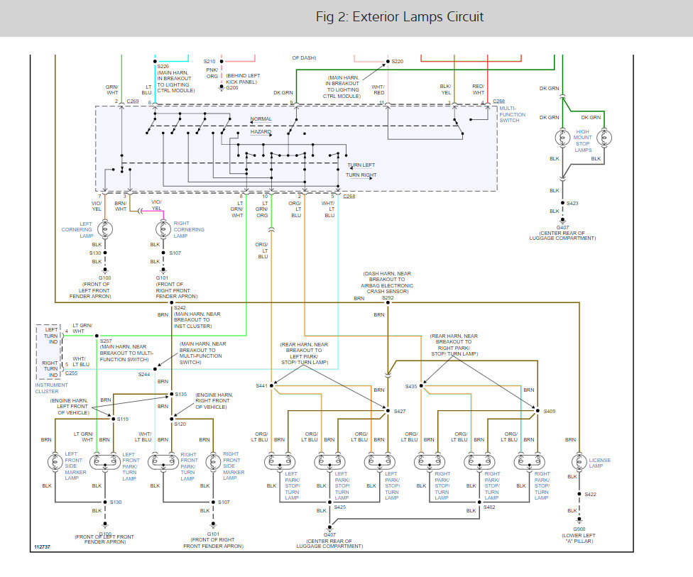

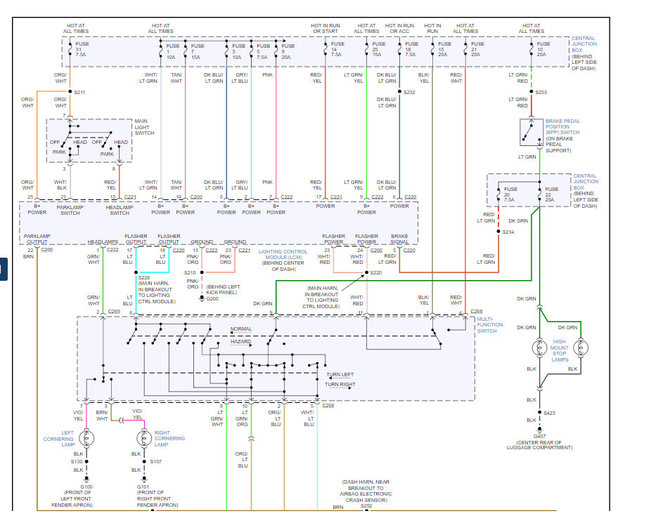

Brake lights, taillights only come on when headlights are turned on. When they are off, the taillights and brake lights are also off. Brake lights and taillights both stay on when headlights are on even when not depressing brake pedal.

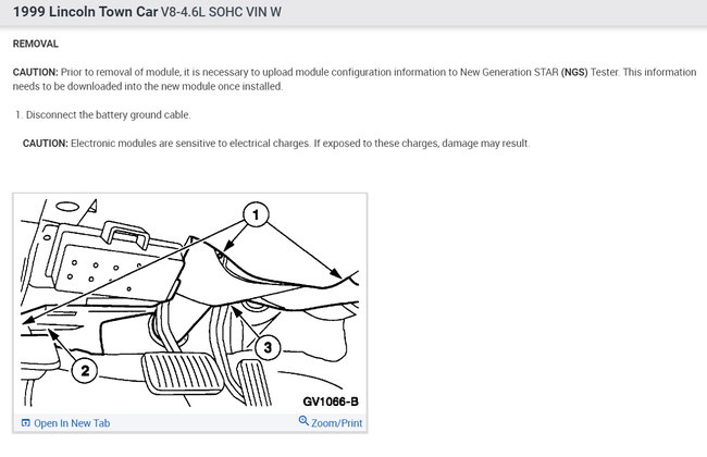

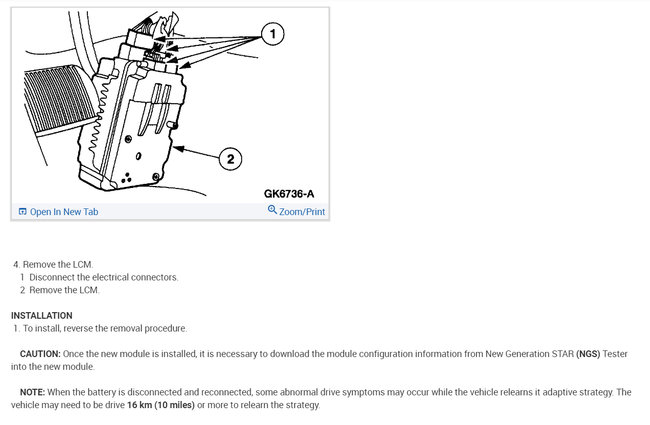

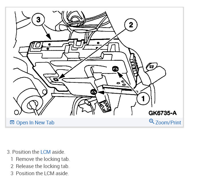

This is common when the lighting control goes out. Here is the blinker wiring diagrams so you can see how the system works and the location for the lighting module. Check out the diagrams (below). Please let us know what happens.
