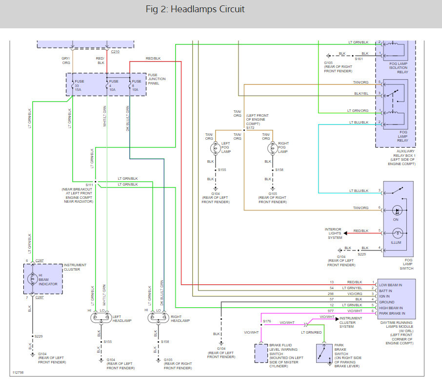

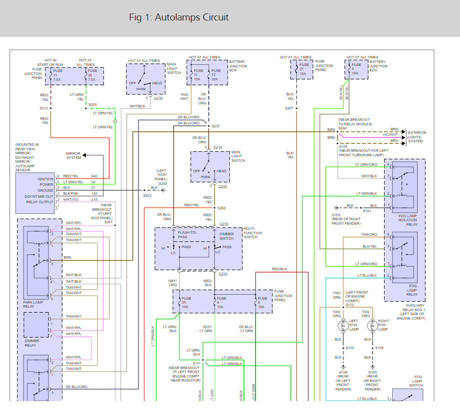

no headlights brake lights except for the third the dashboard lights won’t come on
1999 FORD EXPLORER
150,000 MILES • 4.0L • 4WD • AUTOMATIC
SHANERS34
I went out to start it. It fired right up. Went to turn the knob to turn the lights on and I had no lights. The only brake light I had that came on was the third one above the back glass. So there’s no headlights brake lights except for the third the dashboard lights won’t come on. No parking lights the turn signals work and the reverse light works. I’ve checked all the fuses replaced the relay. But when I started the car the knob where you turn the lights on that was lit. But when I turned it over to turn them on it went off. The bright lights work on when I pull and hold them back to me.
May 6, 2019 at 3:46 AM
  • 55,325 POSTS

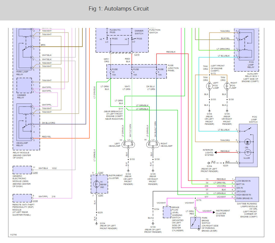

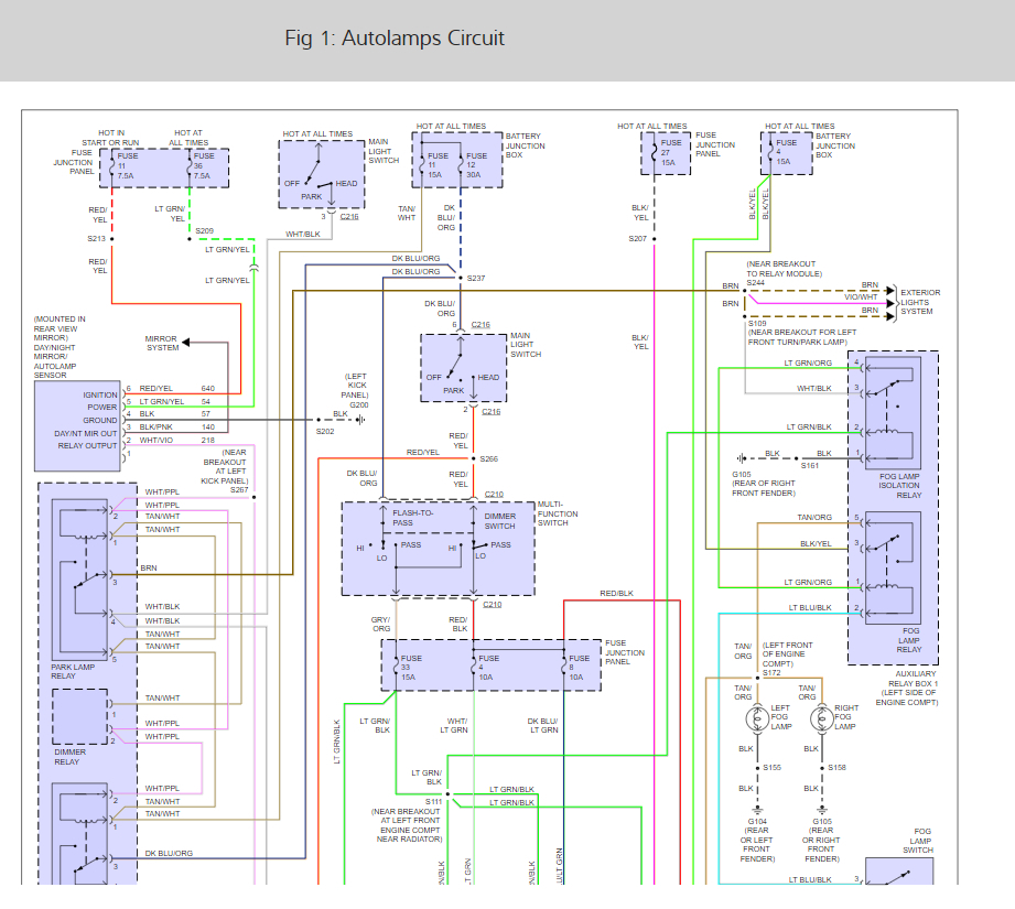

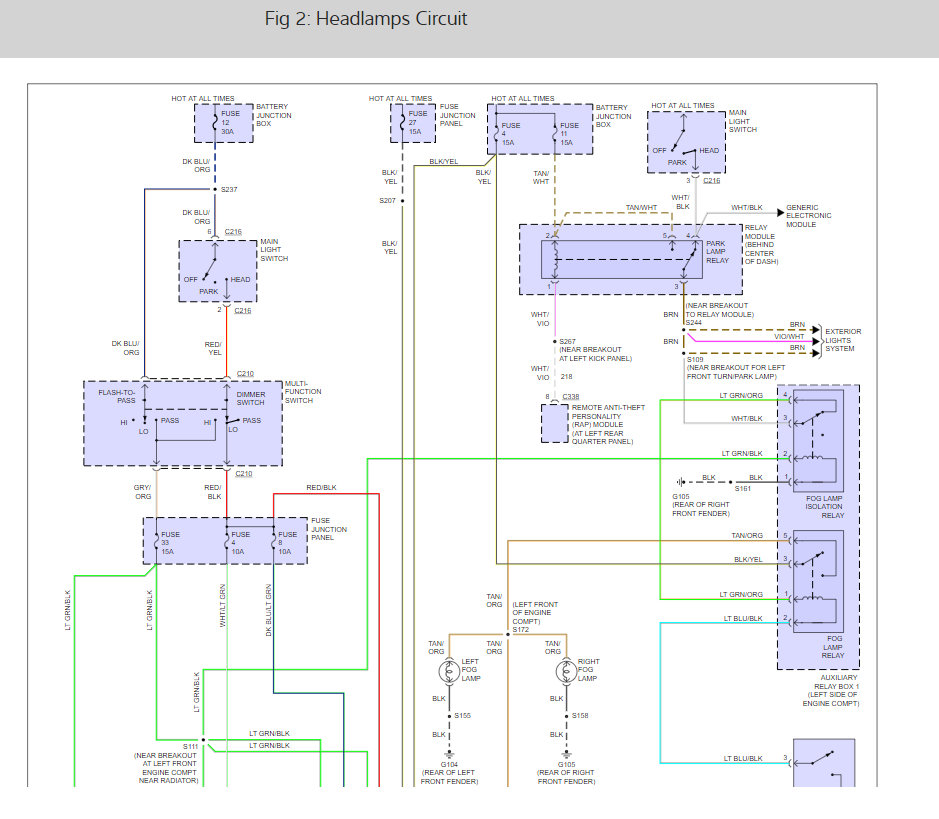

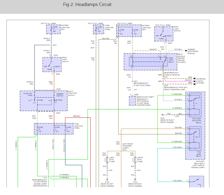

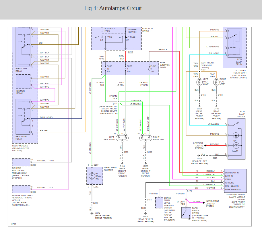

It sounds like the auto lamp sensor could have gone out in the drivers mirror. to be sure lets check for power at each one of the fuses that run the system. Here is a guide that will help and the headlight wiring diagrams so you can see how they work, once we fix the headlights the running lights should work:
See where you are losing power. Check out the diagrams (below). Please let us know what you find. We are interested to see what it is.
