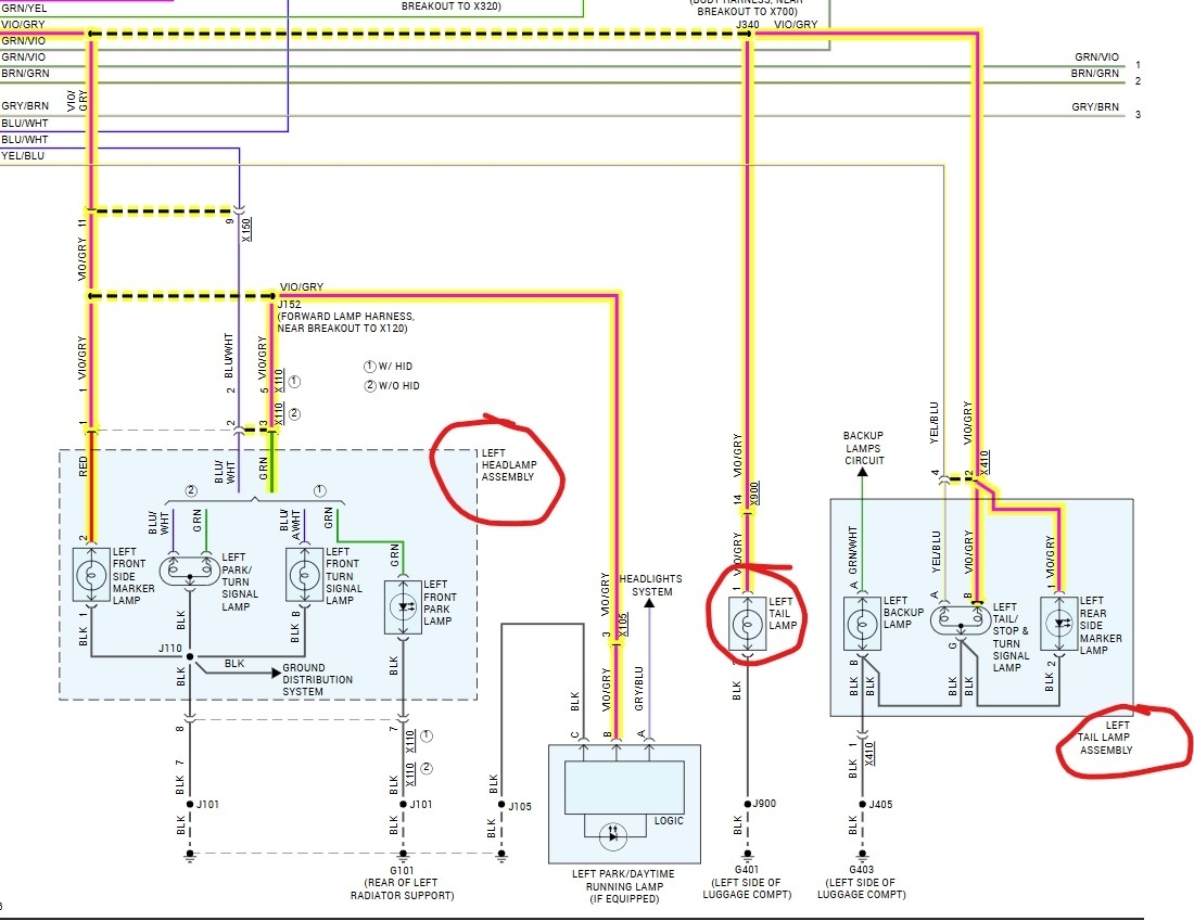

You said the left headlight, taillight and dash was out? Do you mean just the instrument panel or everything like radio, heater and those as well? Did those come back with the new switch? Looking at the wiring diagram the left lights all share a single power feed straight out of the body control module. The BCM also controls the instrument panel lighting. There are 4 fuses I would test 3 are labeled as BCM 2, 3 and 5 Those are in the fuse block at the left side of the dash, the other is displaying ignition fuse located in the fuse box under the hood. Testing them with a simple test lamp is fast and can show you that the fuse might look okay but be bad.

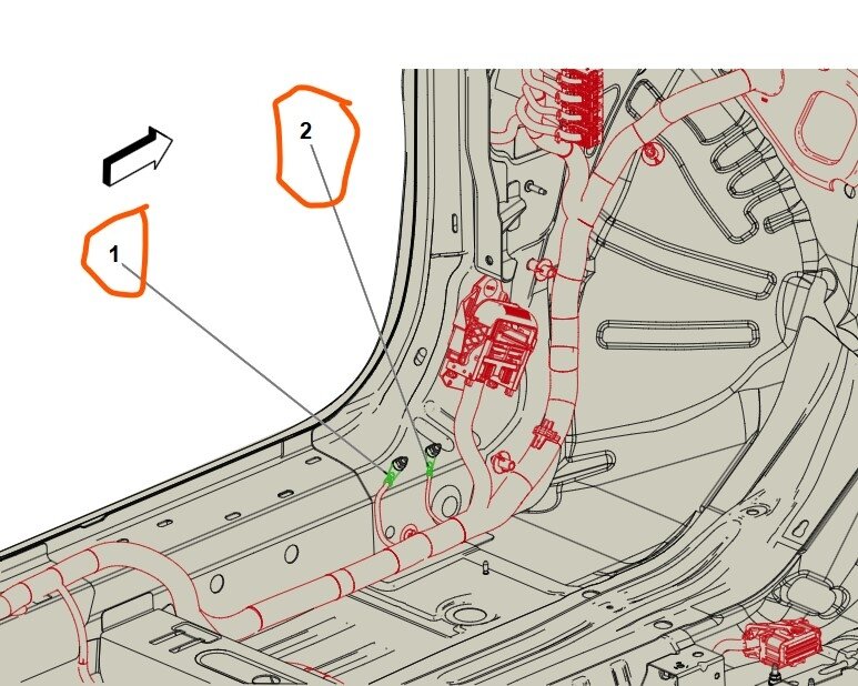

Okay, with the entire dash out, what actually works on the dash? No lights? Do the gauges work? Radio? Heater? There are a few circuits involved with different grounds but if it's the lights you would want to check grounds 203 and 305. Both are located under the left kick panel trim plate to the left of the driver's seat. They are in a spot that gets damp and can easily rust.
Jul 4, 2025 at 6:10 PM

No dash lights, gauges, no radio, no heat. And this is for my 2018 Chevy Impala?

Yes, there are other grounds as well. These two are the primary grounds for those items though. I would start by checking them. Because of the location and how they are installed they get corroded. GM like others likes to take multiple wires from different items, then they bundle them, crimp on the terminal and call it done. Then after a few years the wires corrode or the body they bolt to gets corroded and odd things happen. If you remove that trim panel you should find the grounds, both will have 3-4 wires in them at least. If the steel they bolt to is rusted you may be able to unbolt them, grind off the rust and reconnect them. Or if it's the wires you can cut them, strip the ends and install a different terminal and attach them that way.

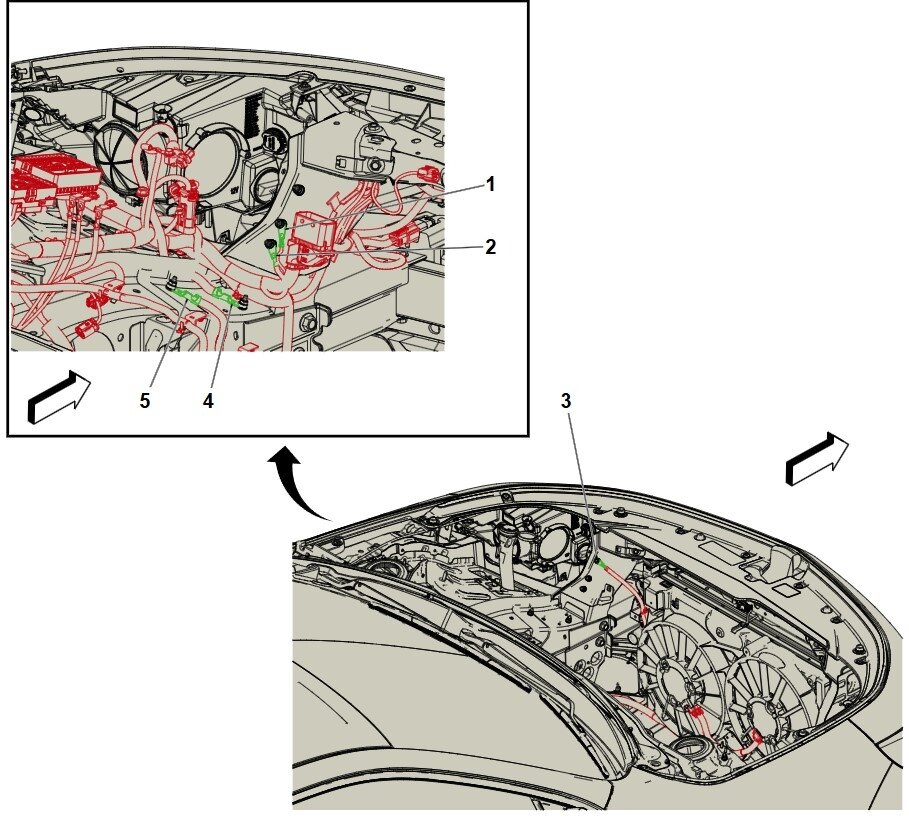

Where is the ground for my left front headlight? I got everything but that fixed.

It's on the back of the radiator support on the left side, ground 101. That grounds the headlight, marker and turn signal in that assembly. If the turn and marker work but no headlight it isn't the ground. If they are all out, then it could be. It's hard to see but it's on the panel below and in front of the battery tray.

Thank you for your help the diagrams really helped, and I really couldn't find any diagrams.
