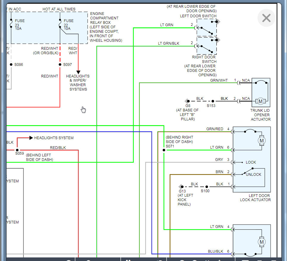

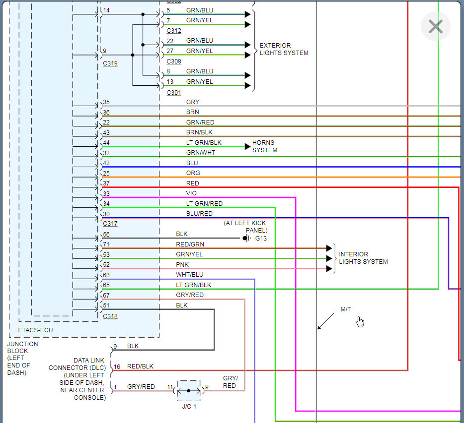

Started out with my tail light blowing was replaced blowed again, fuses replaced. Now the brake lights, dash tail lights and radio not working. Along with the power locks. Windows still working.
Feb 25, 2021 at 12:49 AM

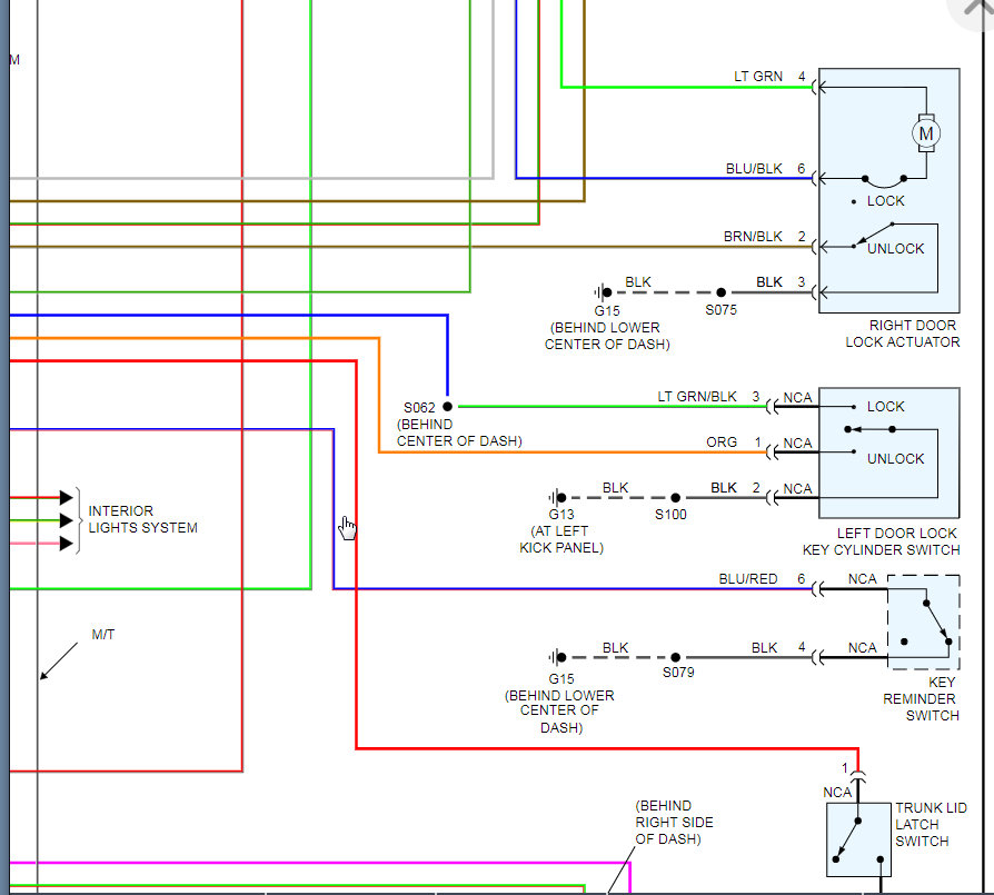

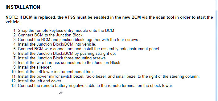

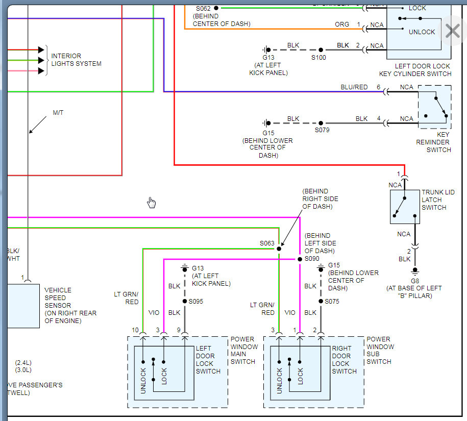

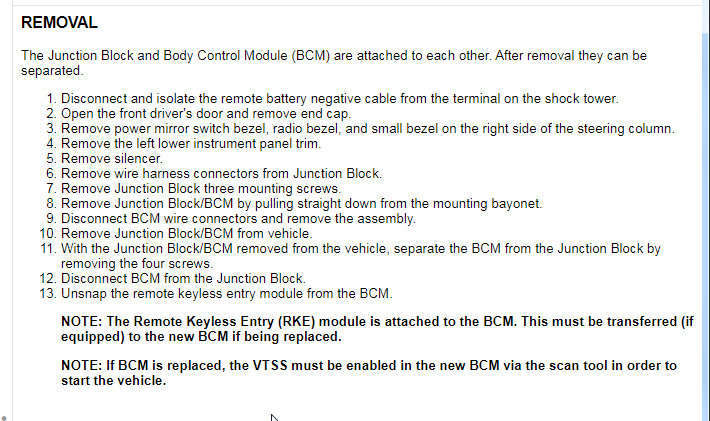

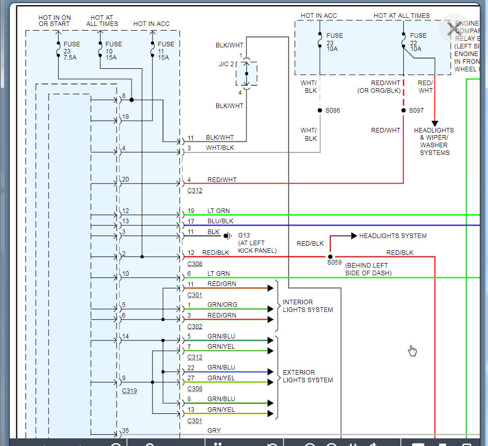

More then likely this is the Junction Block ECU however, it is not called the TIPM, it is actually called the BCM.
I attached the info below from the manual. The way to confirm this is to test one of the systems for voltage at the actuator or leaving the BCM. I suspect it will not be there.
If that is the case and it fixes the other issues then that is a bonus. However, if not we can move onto the next one.
Let us know if you have questions. Thanks

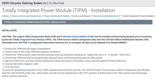

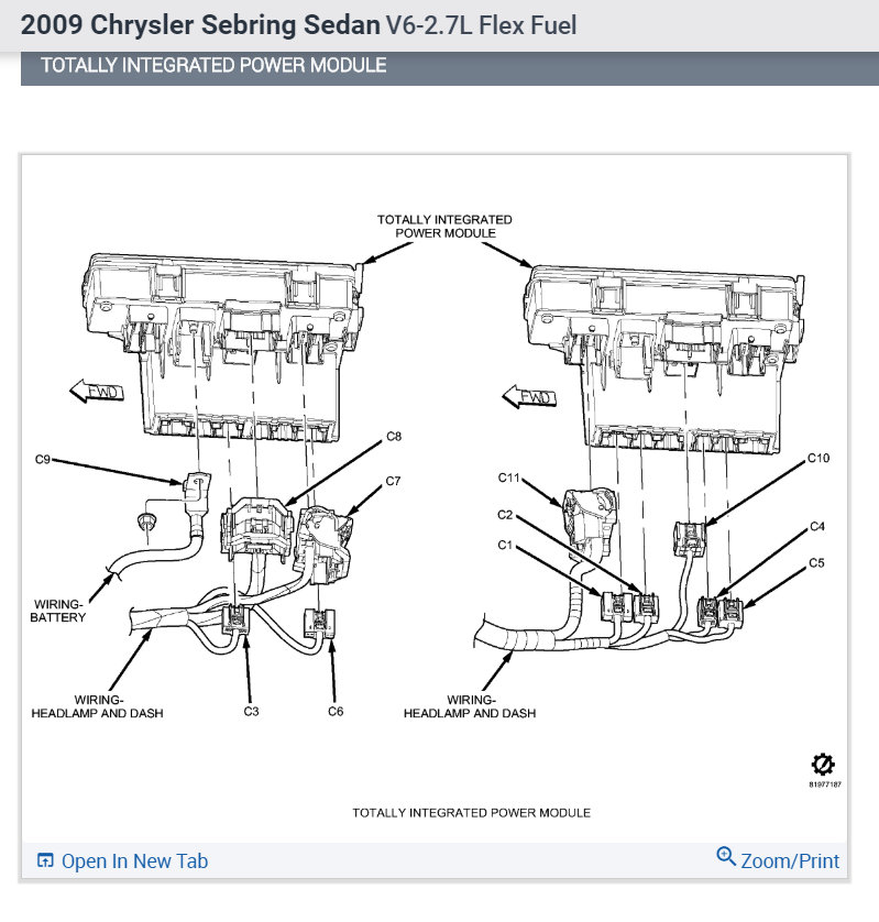

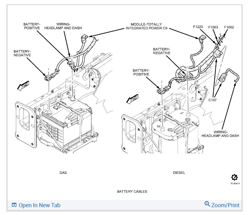

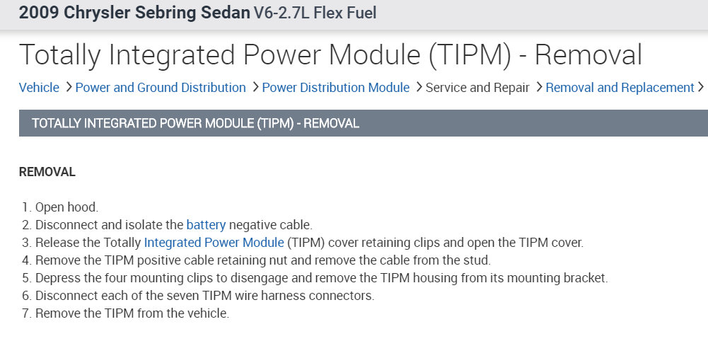

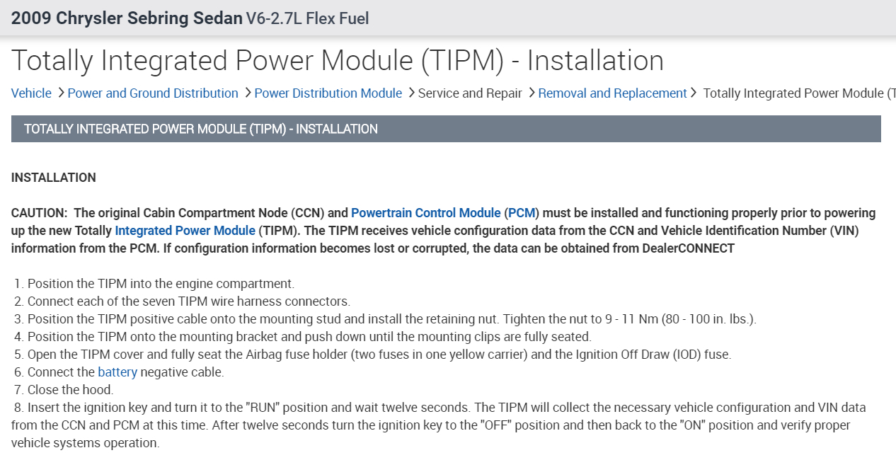

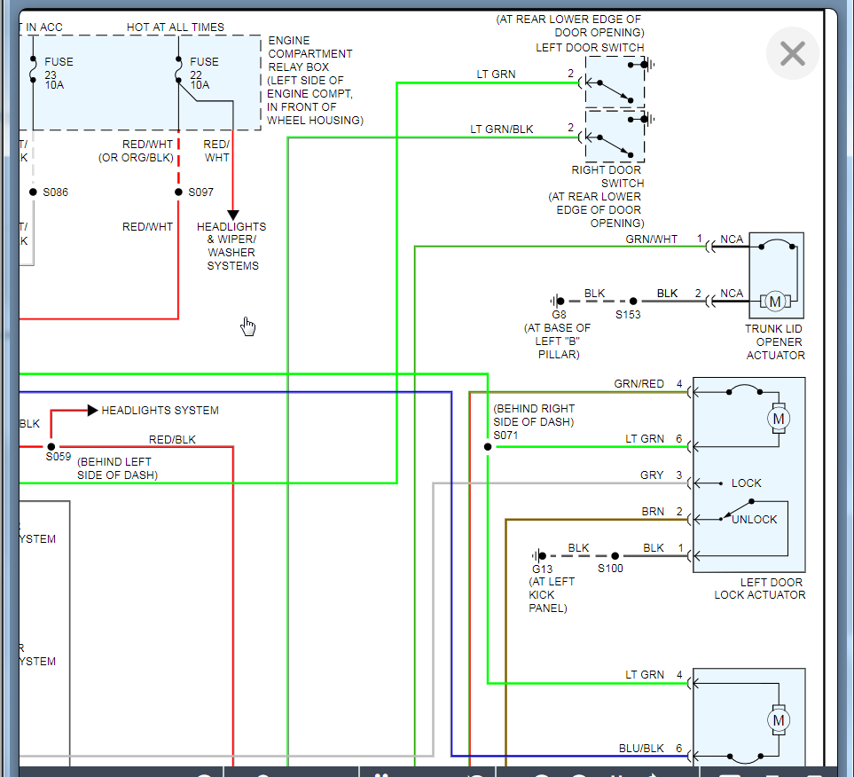

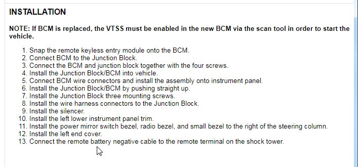

Here are instructions on how to replace the TIPM module. Check out the diagrams (below). Let us know what happens and please upload pictures or videos of the problem.
