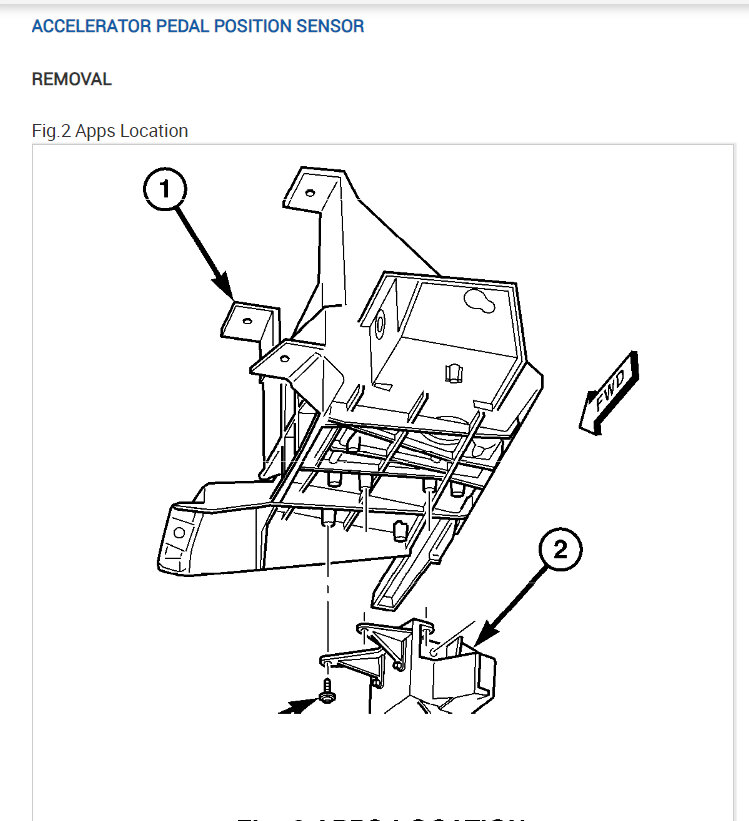

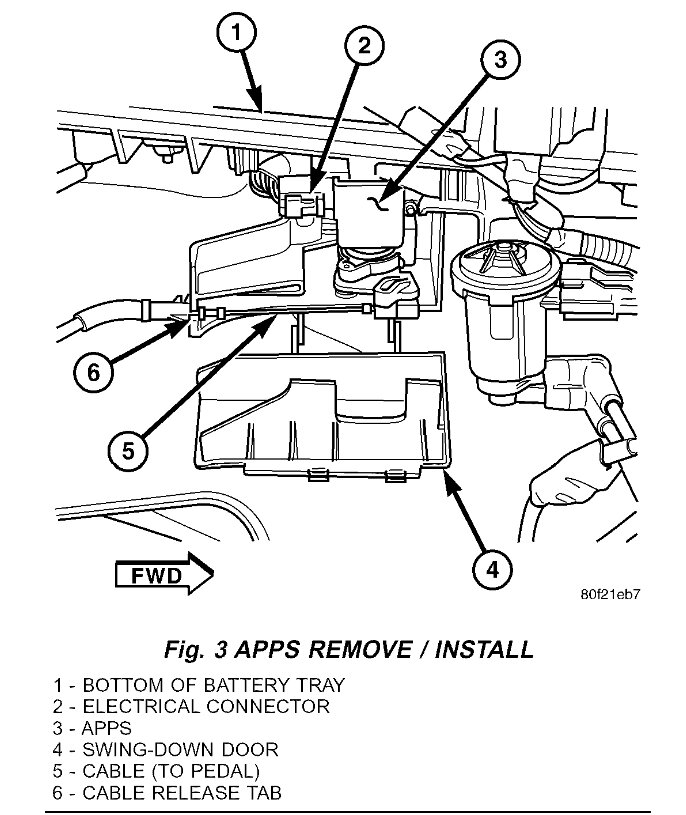

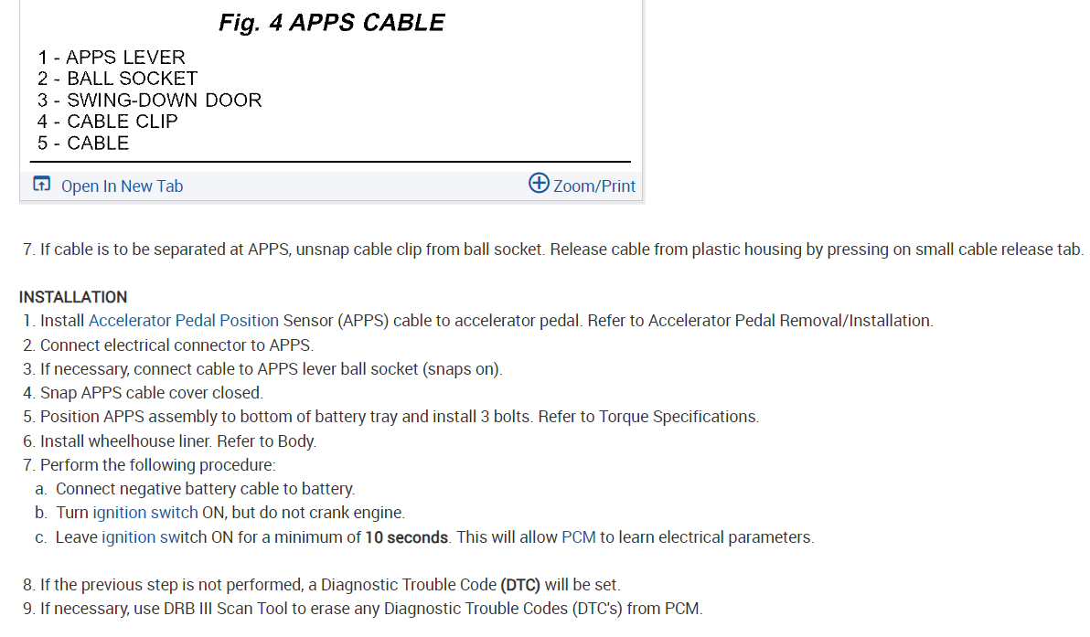

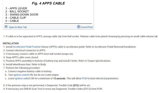

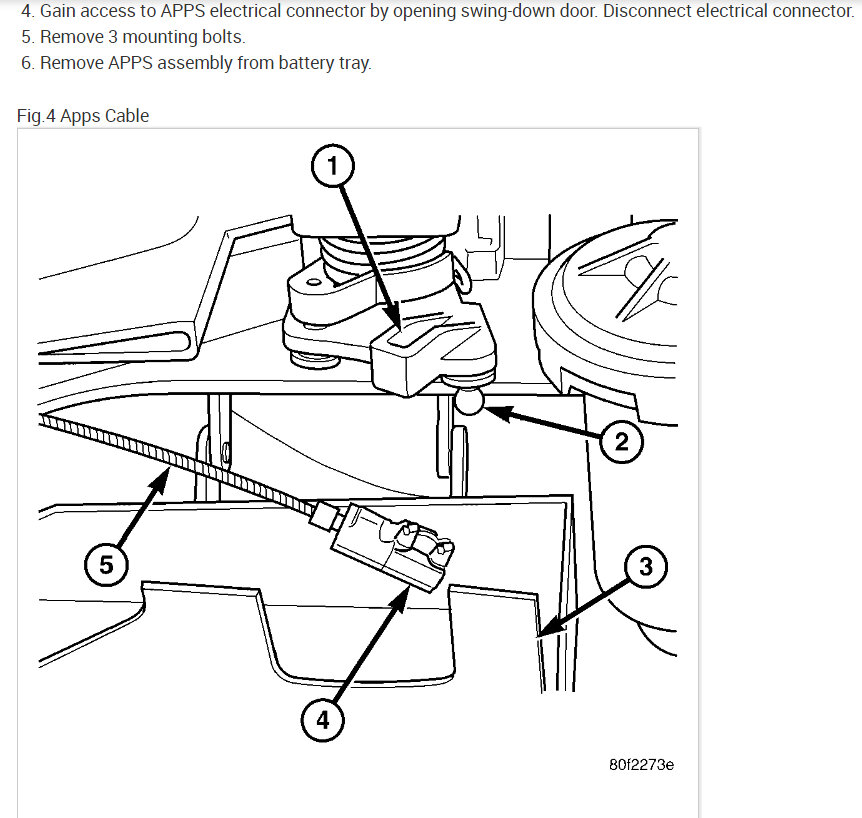

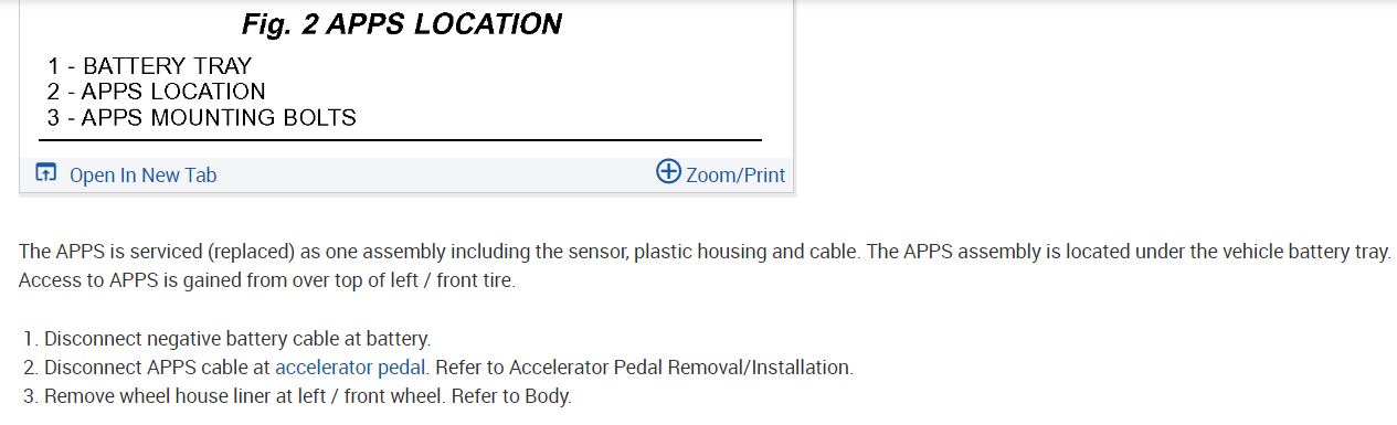

Yep, this happens when the accelerator pedal sensor goes out, if there is a glitch in this sensor the truck will go into limp mode. This sensor is under the battery tray, here is the location and how to change it out. Check out the images (below). Let us know if you need anything else.
