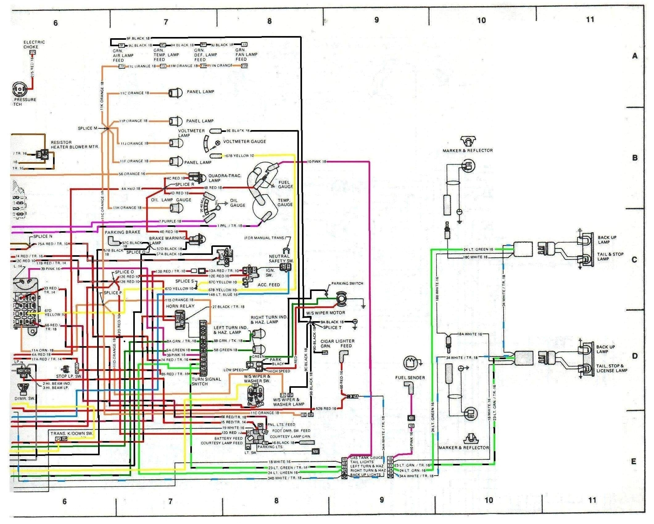

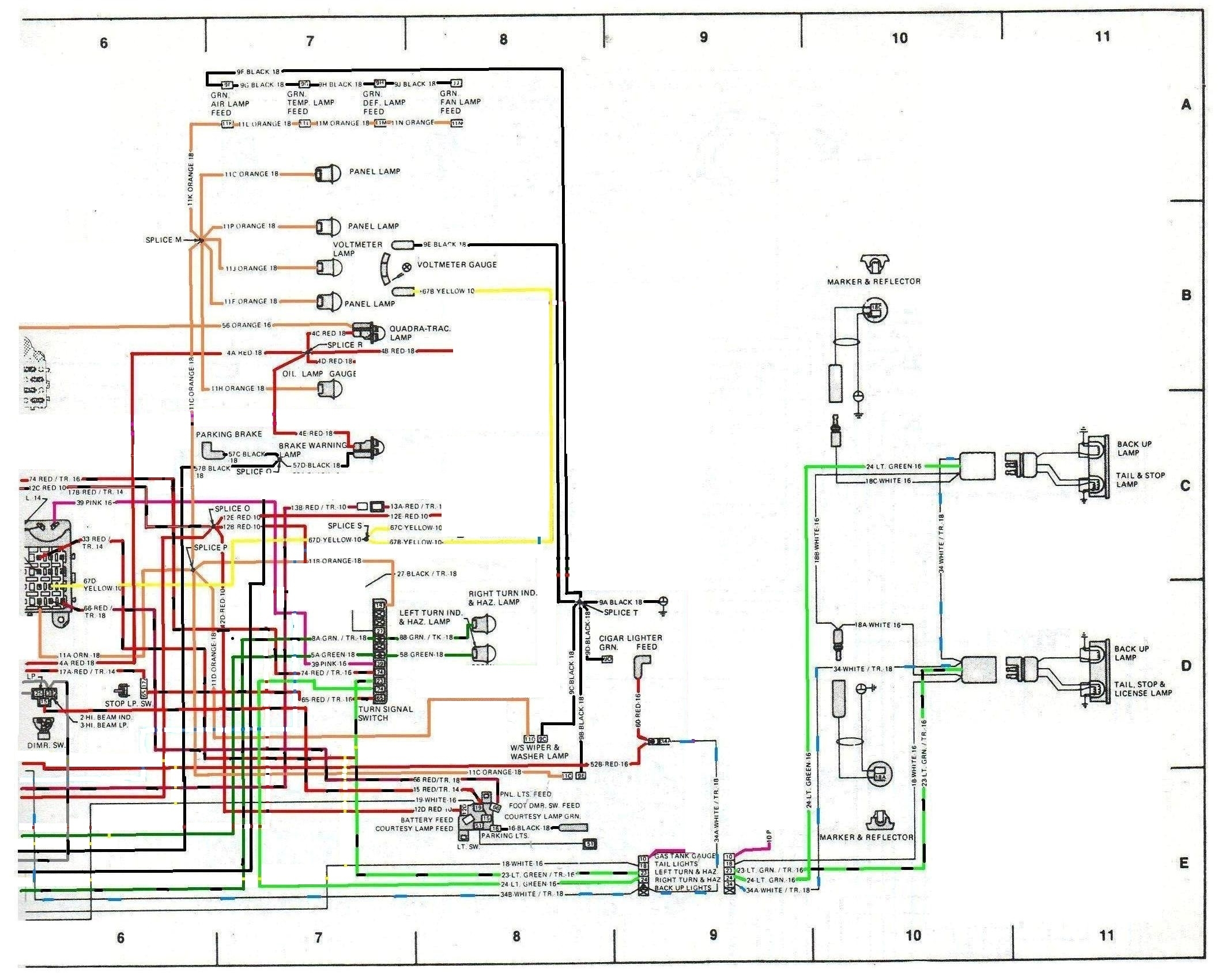

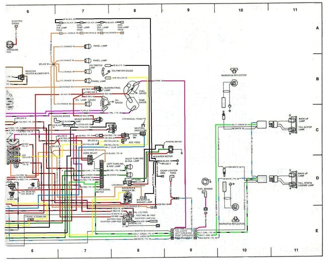

Here's the only thing I see that could be wrong:
The front turn signal/ park lights and the rear turn signals and rear lights all share a one each bulb.
The turn signals and brake light all use the "brighter" filament within the bulb. Thus the brighter filament is controlled by the turn signal switch and the brake switch only/ half of the bulb i used this way.
Same bulb, when you pull the light switch to on, the dimmer element is now on (running lights and park lights) this is the other half of the bulb.
The only thing common to these four bulbs is the ground.
We have one more light issue to consider, that would be the side markers. They are a one filament bulb. They work with the light switch as well as blink with the turn signals.
I think that it's not a ground, somebody crossed up two of the wires.

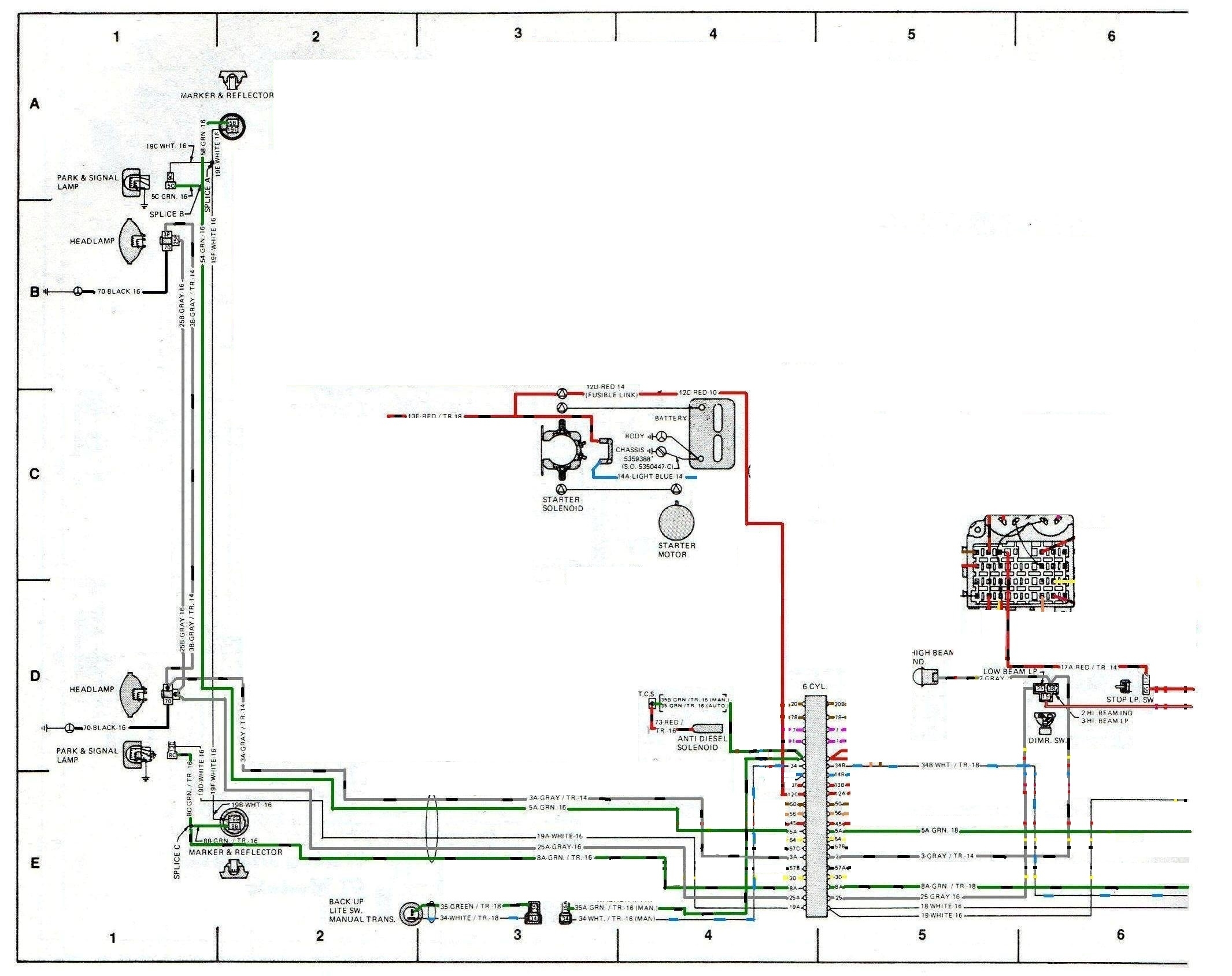

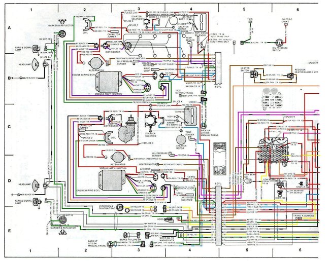

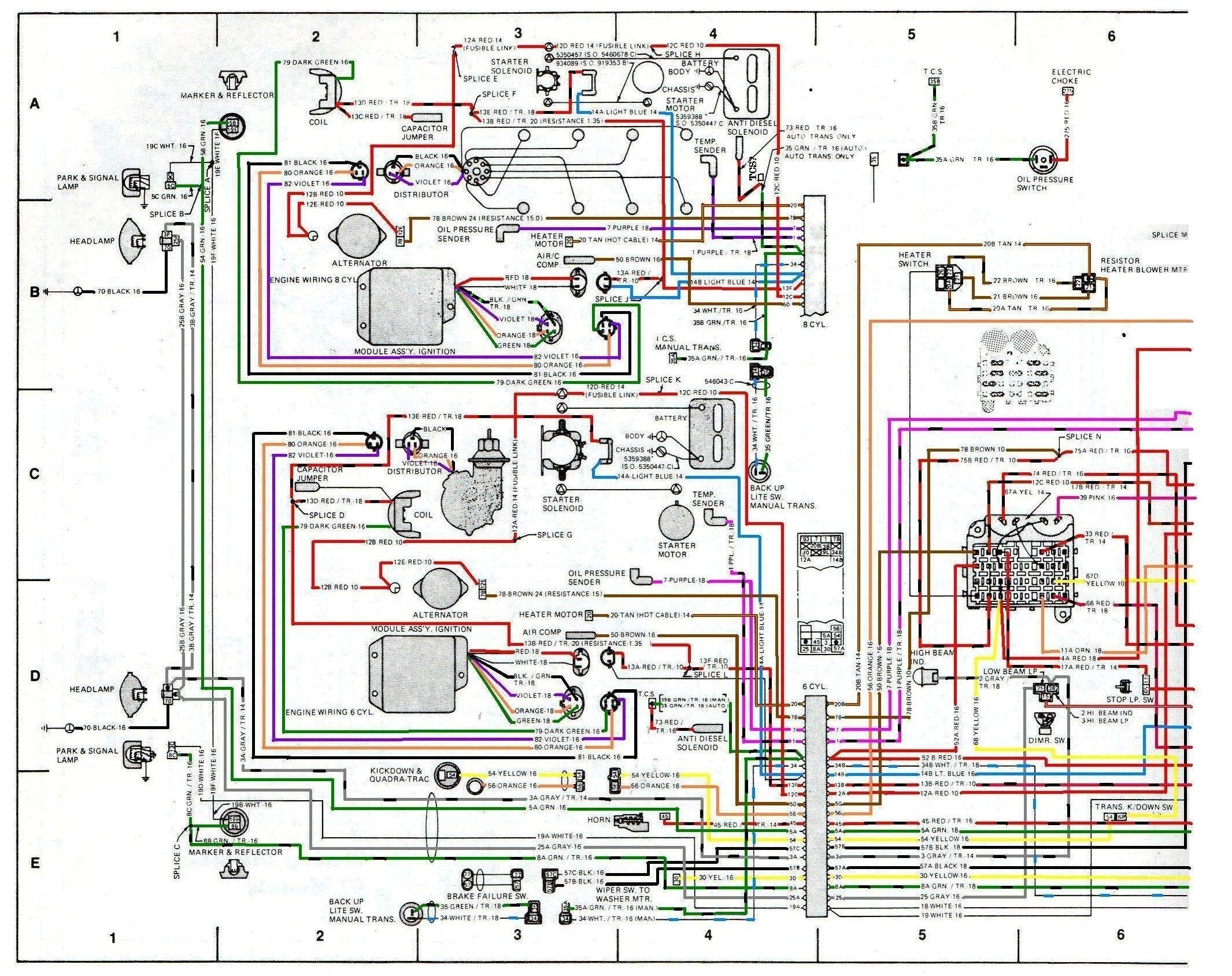

I'm going to chop up a diagram to only show the lighting. I will also provide you the whole diagram as well.
I scanned and colored this diagram the best I could.
Tracer stripe colors on wires were not labeled with a color, so I used the base color that was listed. I "dashed" these tracer wires to denote they were tracers. You will be able to pick out the real wire and it's stripe color as you dig into your wires. Sorry! The only way for me to have gotten the tracers colors would have been to take my whole Jeep apart and look! White wires are drawn with black lines!
Here they are. I may have missed something. You can double check me with the original diagrams. Even though this is a 1979 diagram I think the lighting is the same through the nearby years.

Hi all. Back to it I am. So did all of the mentioned checks from both of you and the voltages are correct as you laid out. I disconnected the RR from any of the circuit and still have the same problem. Also my 84 scrambler I had many years ago the front side marker lights I think did flash with the turn signals. This one does not. Maybe because of the aftermarket harness? Anyway looking for some more guidance. Maybe it will be the last thing that gets checked....thanks Hunter

So I have not seen a reply lately from anyone....so here iswhat I finally found. Not just 2 wires crossed but 4..... drove me nuts for many hours chasing my tail. after finding the issue with the left rear crossed wires I started operating the lights checking with and without lights on and found the right front turn/ marker light not working correctly. So 4 wires crossed now fixed and all light are working 100%. I still have no idea how 4 wires got crossed when the vehicle was restored..
