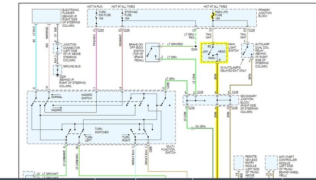

dash lights and running lights do not work.

Good afternoon,

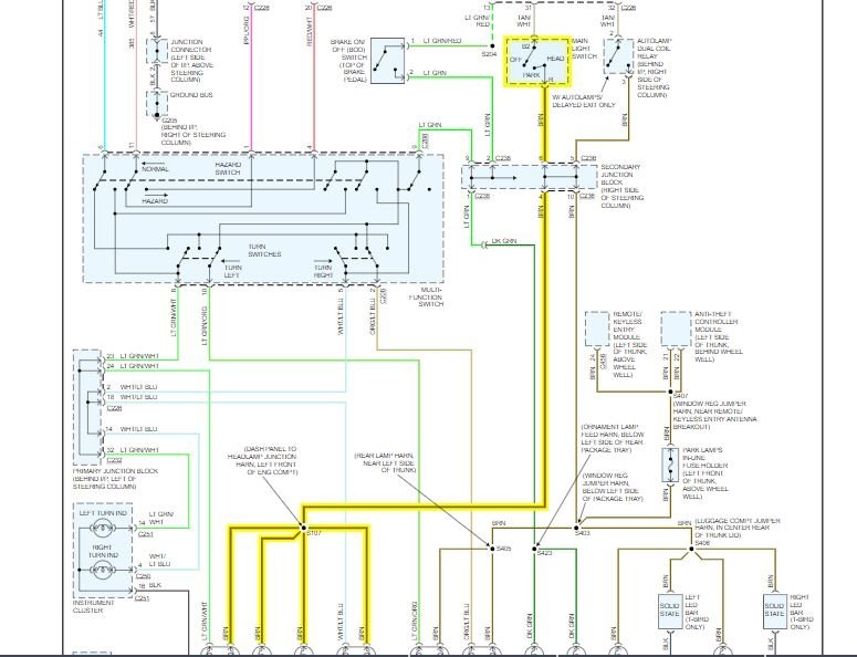

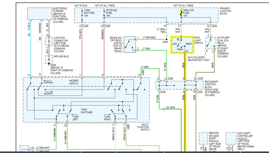

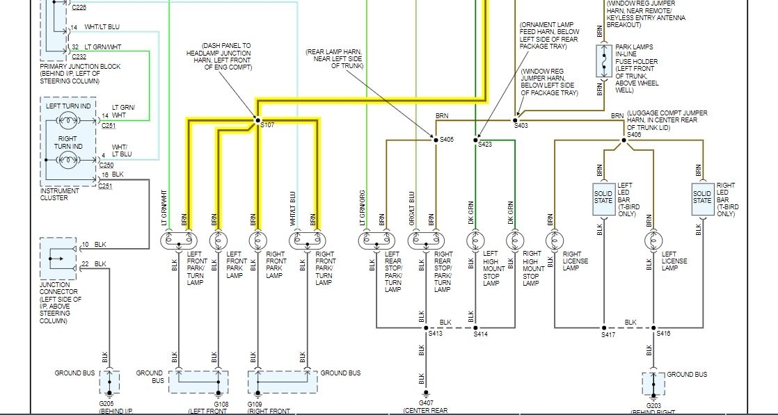

I attached a wiring diagram for you to view. Check the fuse for power on both sides.
Check for power to the headlight switch and out on the wire highlighted.
https://www.2carpros.com/articles/no-tail-lights-exterior-running-lights-tail-lights-out
Hopefully, it is only a blown fuse.
