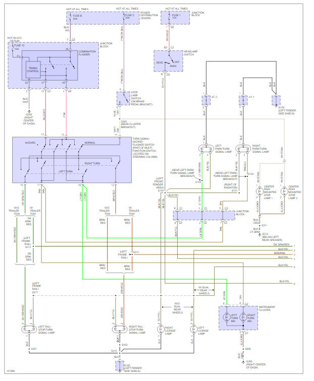

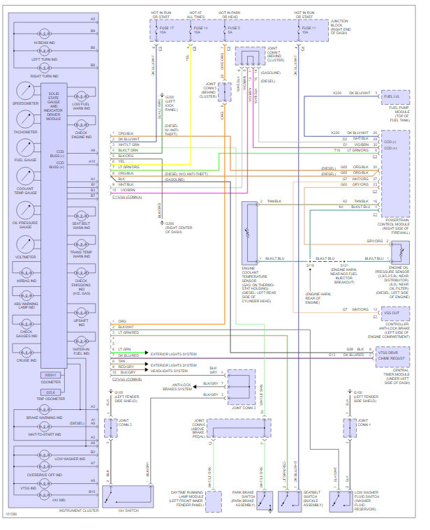

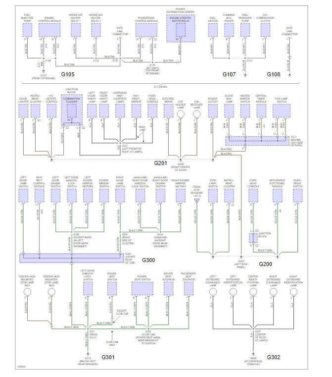

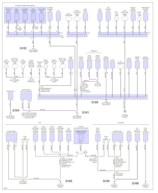

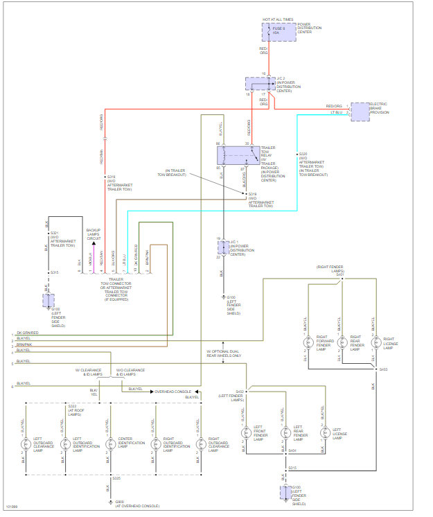

Before I start explaining I would like to note relays, fuses, bulbs, and the head lamp switch is new. This being said, my headlights, turn signals and brake lights work. However, my tail lights, dash lights, and fog lamps do not work. What could be wrong?
Feb 7, 2019 at 2:37 AM
SCGRANTURISMO
  • 4,897 POSTS
It sounds to me like you might have a loose or corroded ground. I have included in the diagrams below the exterior lighting, instrument cluster wiring diagrams as well as a ground distribution chart to help you track down the problem. Get back to us and let us know what you find out.
