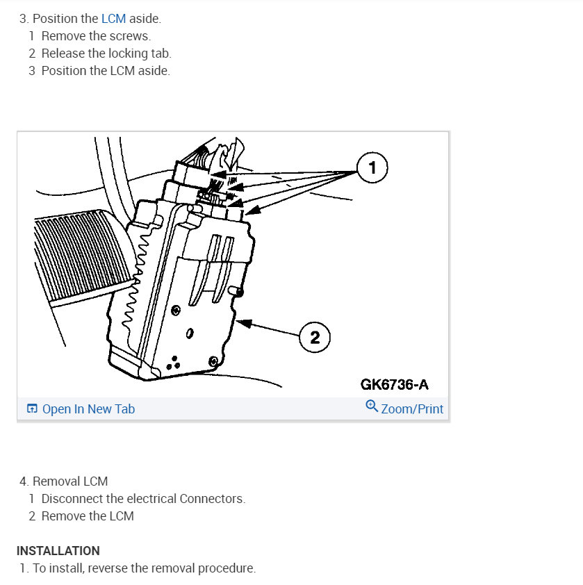

I told shop i had a battery drain, interior light on. The shop said they scanned car, checked fuses and relays. found two fuses that had high amp draw and checked for wiring, this took 3.75 labor hours. shouldn't the scan found both the bad fuses and LCM being bad. aren't scans less than one hour?

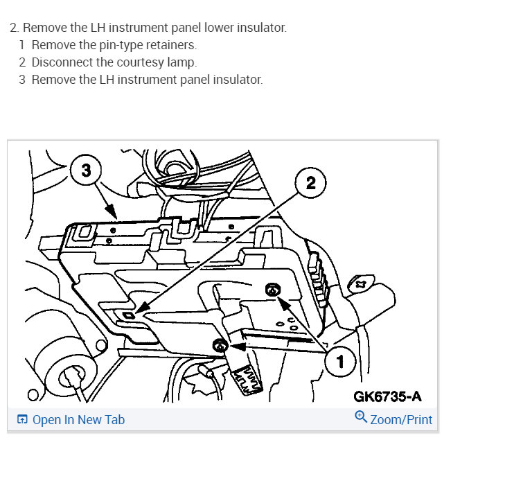

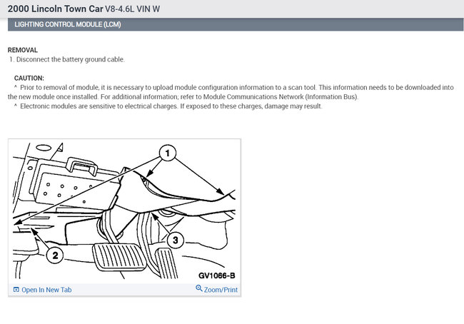

Yes, this seems excessive, a simple CAN scan (1 hour) would tell them the problem, here is how to replace the LCM in the diagrams below.
