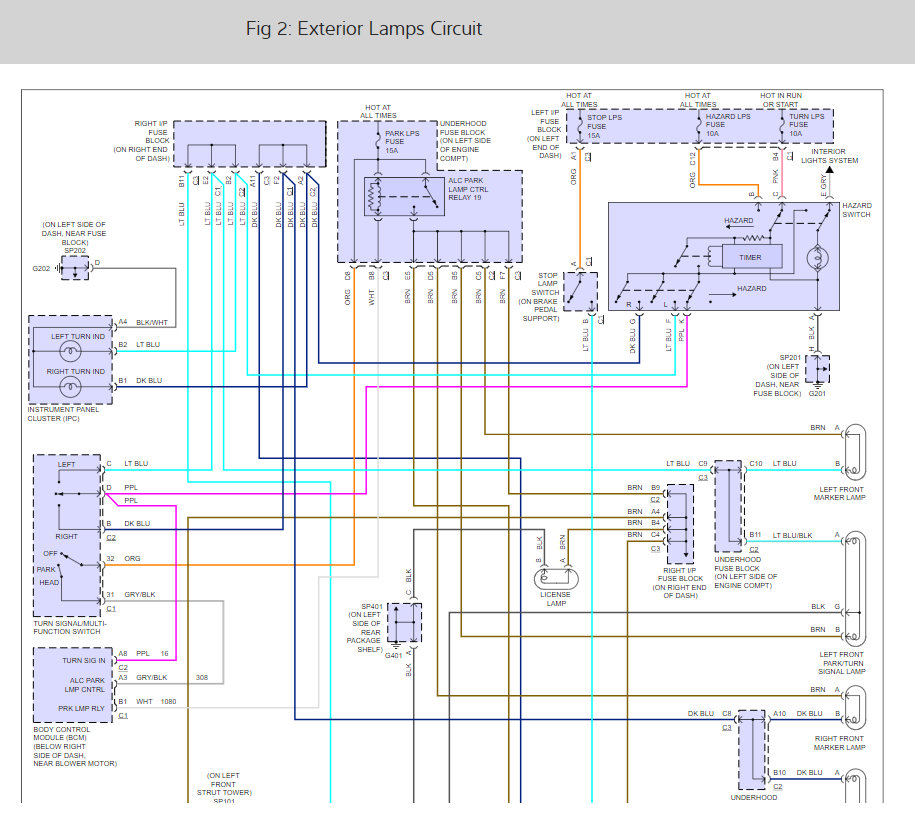

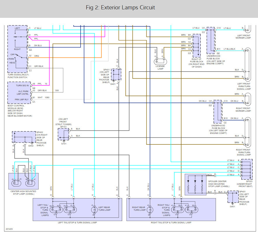

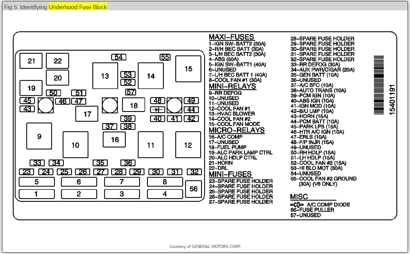

My driver's side front and rear lights will not work. Running, turn, brake and high beams. No front and rear driver's side lights. Is there a fuse or a group of fuses/relays that control just a certain side of the car's lighting?

I would try cycling the emergency flasher switch multiple times to clean the contacts. Next there is an ACL relay that needs to be checked as well. Here is a guide and the running light wiring diagrams so we can test to see where you are losing power:
