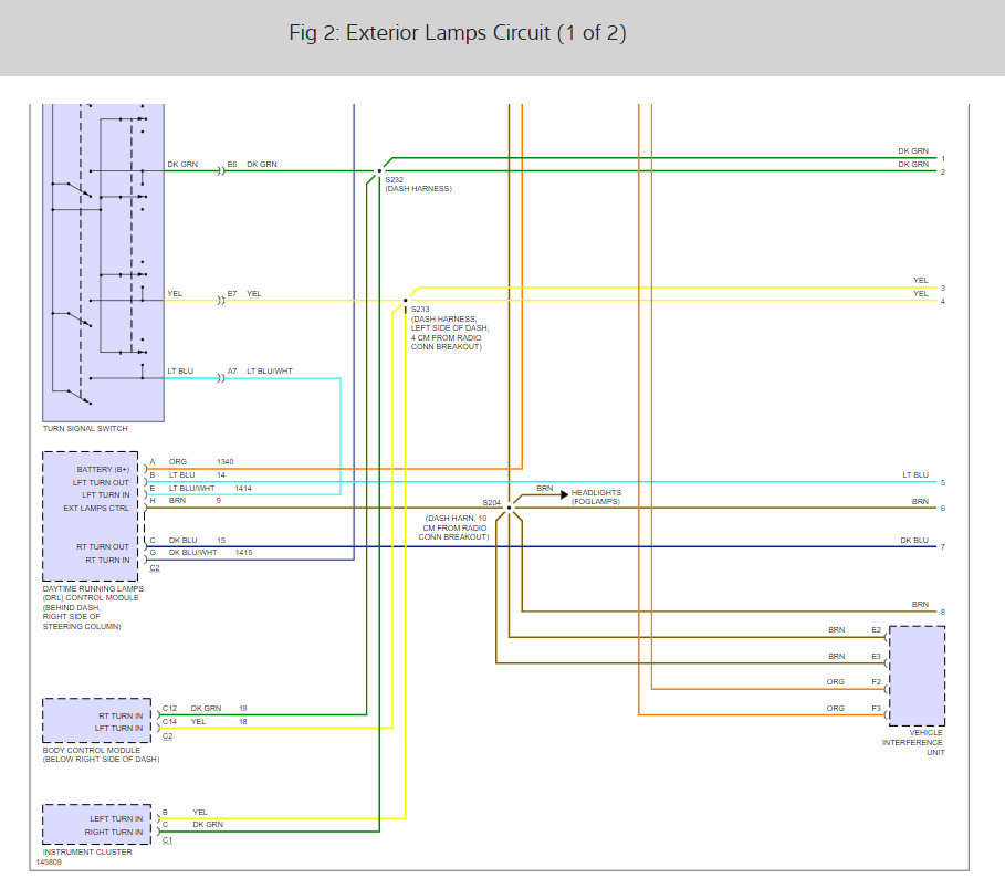

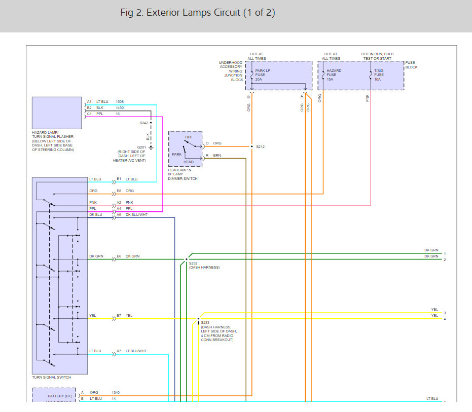

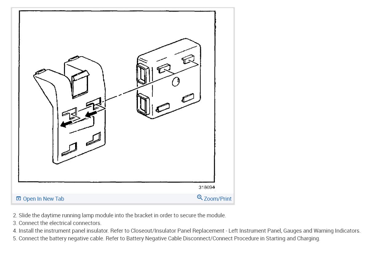

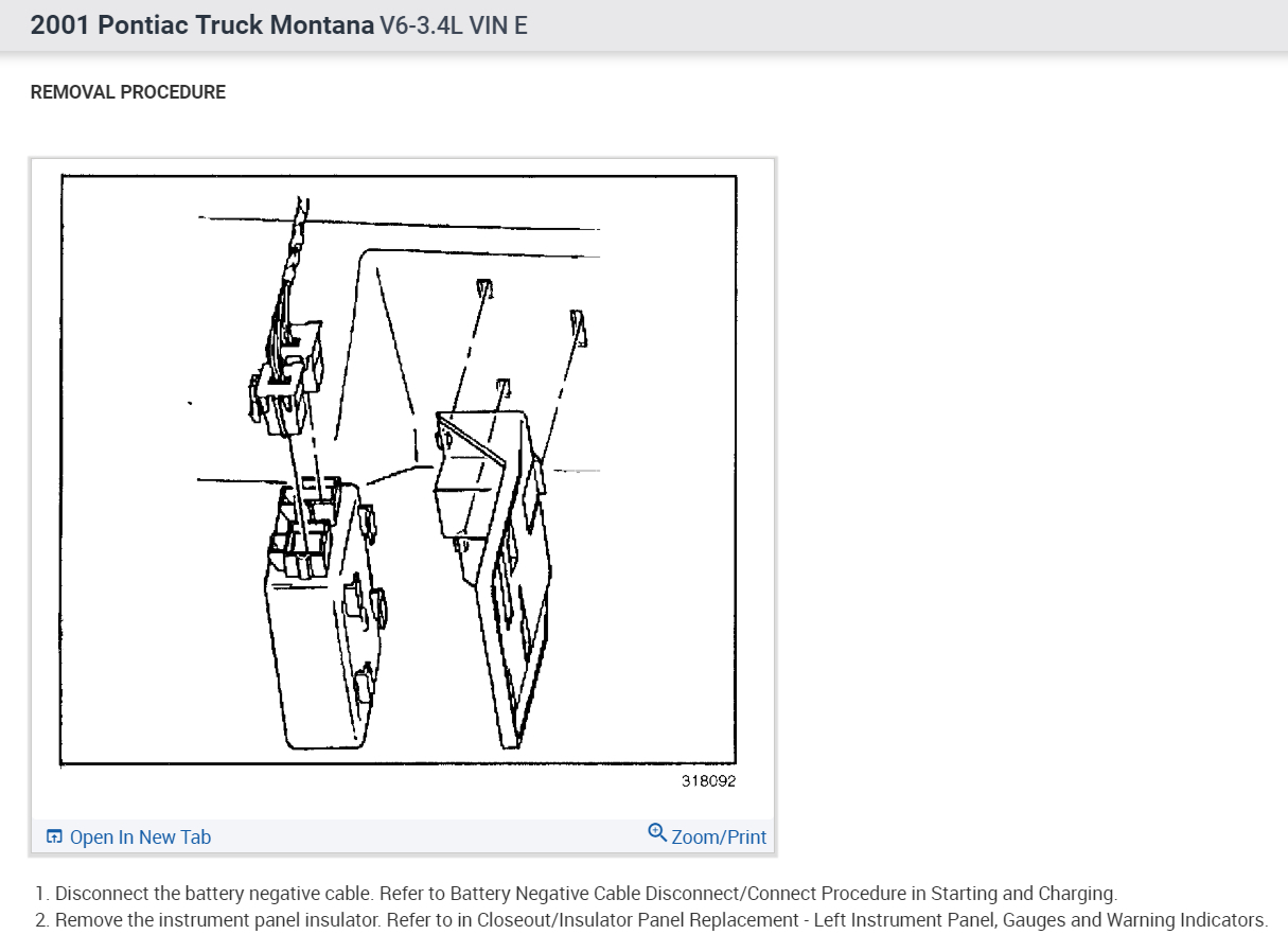

On dash panel both blinker light indicators light up. when vehicle is in park blinkers work front and back. When driving with headlights no lights at all at the rear but everything at the front works! Any ideas? Has this happened to anyone else?
Apr 7, 2019 at 8:13 AM
  • 54,878 POSTS

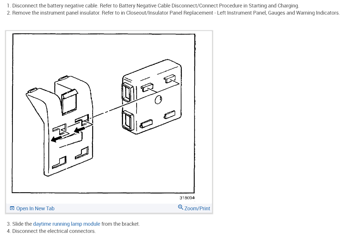

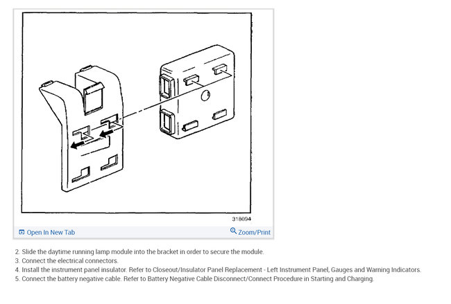

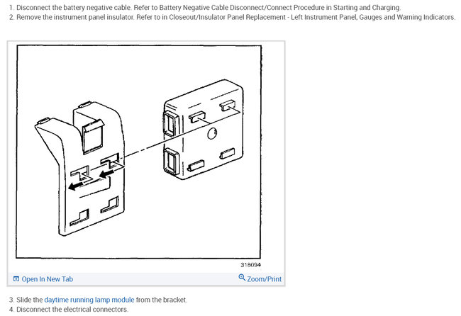

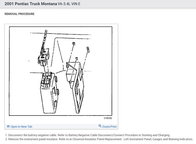

It sound like the DRL module has gone out. but to be sure here is a guide to help check the power output and the brake light wiring diagrams so you can see how the system works with the DRL module location and instructions on how to fix it below:
