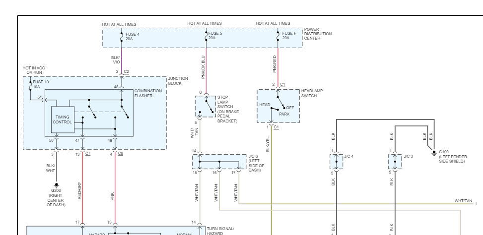

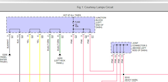

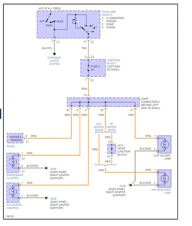

Recently replaced the bed on my truck then. No running lights, overhead lights or cluster lights. I do have brake lights and headlights. Fuses look okay and the ground between the cab and fuse was not attached on the first bed, so I did not replace them.
Apr 26, 2023 at 4:04 AM
  • 55,721 POSTS

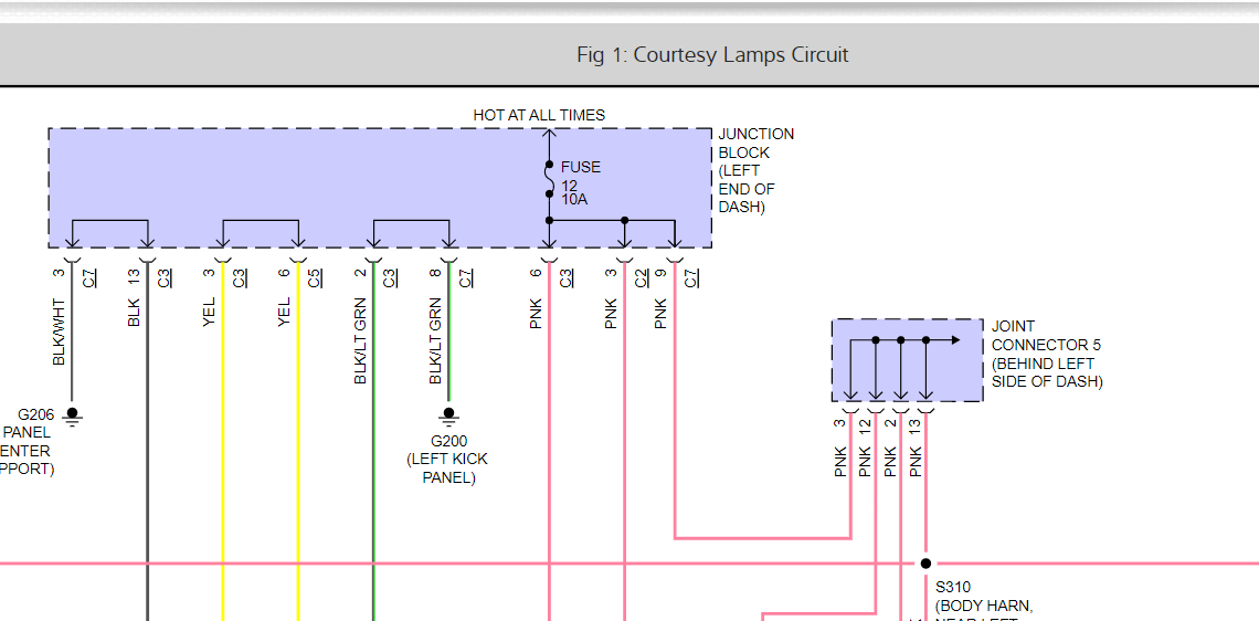

We need to check for power at the fuses. This guide can help us get started and the fuses that need to be checked are in the images below:
