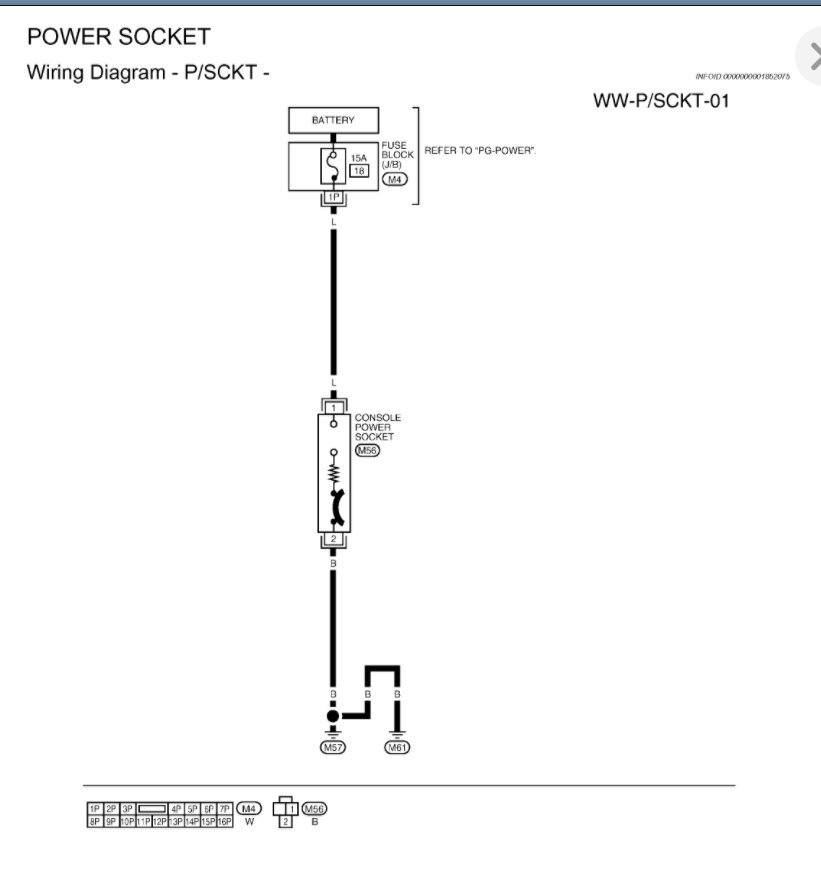

My lighter went out in my car. I do not see where that fuse is on my fuse box is located.
May 11, 2018 at 10:48 AM

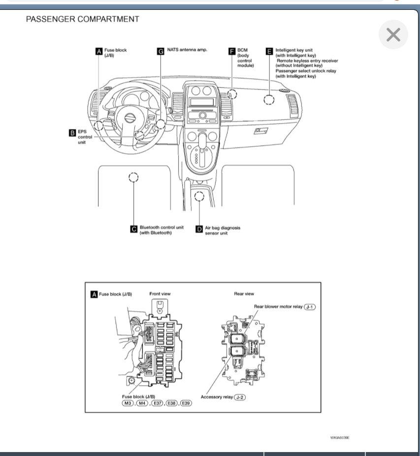

The issue may be due to them not calling this a lighter any more. You may be using it for that but they called these power sockets which will accept one of those lighter inserts.
So it is fuse 18 in the fuse block on the inside of the vehicle, left side of the dash.

Below you will find the info from the manual on this fuse. Please run through this material and let us know if you have other questions. Thanks
