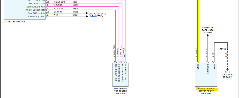

After replacing the humidity sensor replacement lost all power to the car?
2012 CHRYSLER 300
70,000 MILES • 5.7L • V8 • 4WD • AUTOMATIC
MOHAMMAD ALAHMAD
The circulation wasn't working so I replaced the humidity sensor and shortly after a couple of minutes the lightning bolt showed up and it’s not going, and I lost all power to the car.
May 14, 2024 at 6:34 AM
AL514
  • 5,671 POSTS

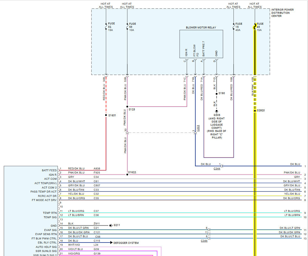

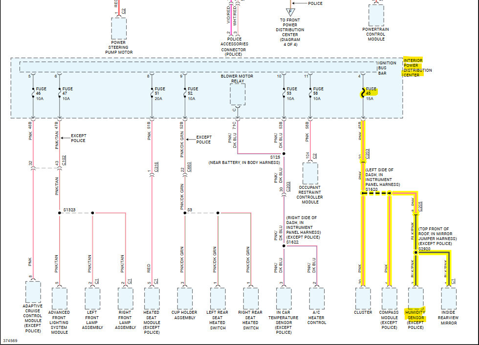

Hello, try unplugging the humidity sensor and see if the vehicle will start. The sensor is on the Lin bus data network, its possible you have a bad new sensor and its pulling the network down. I would also check Fuse 45 15amp, its the ignition fuse to the humidity sensor, was this an aftermarket sensor or did you get it at a dealership?
May 14, 2024 at 12:05 PM
AL514
  • 5,671 POSTS
Here is the wiring diagram for the sensor and its power feed.

These are the other components on Fuse 45, of the interior fuse panel.
