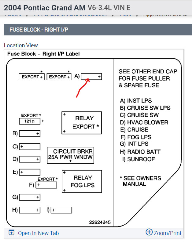

Happy new year to you all. I am in need of those little light bulbs that go in the door lock and window switch, backside. Need parts # and where to buy. Thank you.

Happy new year to you as well! I don't think and can change the bulbs in the switch, at least I have never done it. We just get a new switch. I guess there are lights inside of the switch, but I would not know where to buy them, did all of the lights go out at once? It might not be the bulbs then. I would check the INST LPS fuse in the fuse panel on the right side of the dash. Here is a guide to help and he fuse location below:
