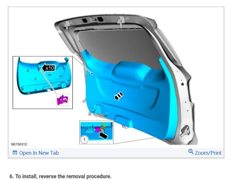

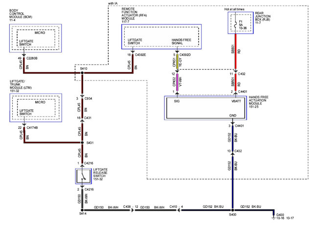

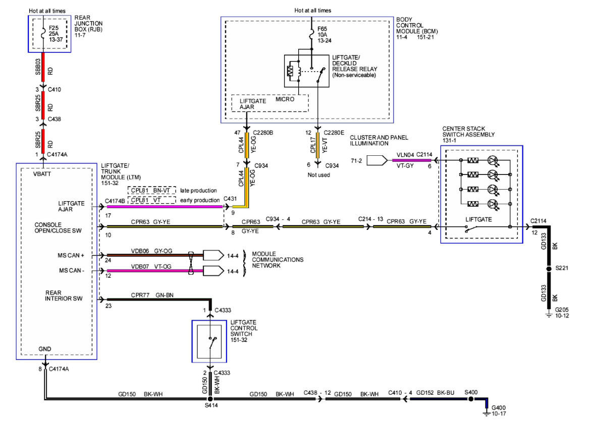

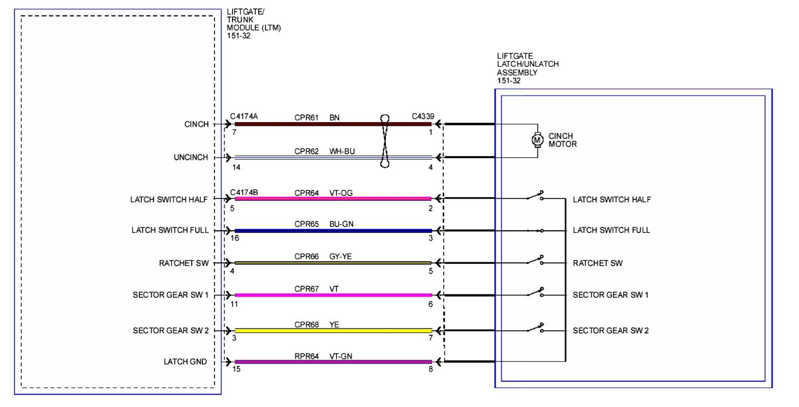

The lock we can hear when unlocked but it doesn't. We try from the inside of panel but it is like the second lock doesn't release.
Feb 4, 2019 at 4:09 AM
  • 55,561 POSTS

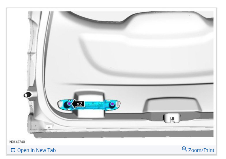

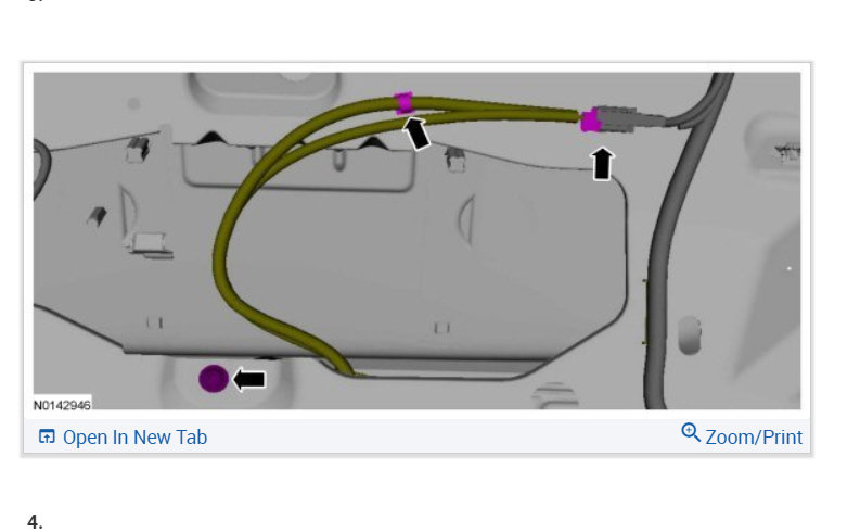

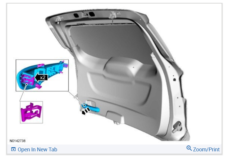

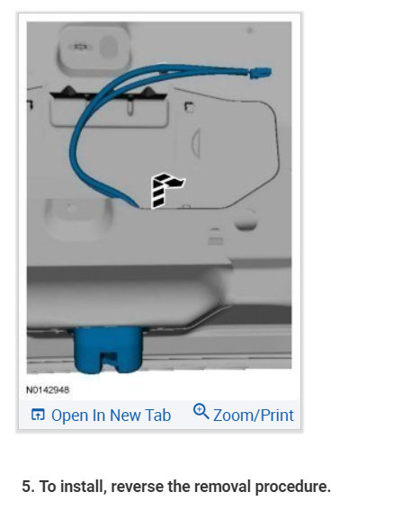

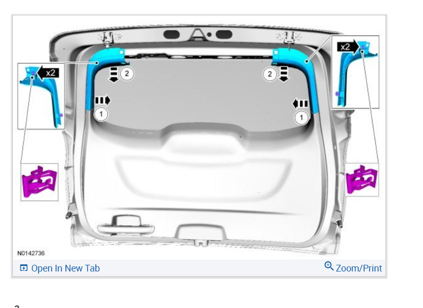

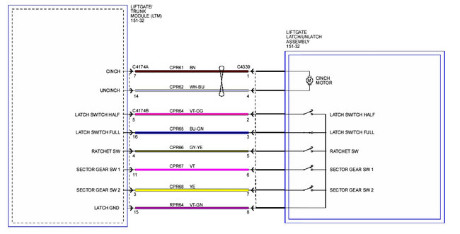

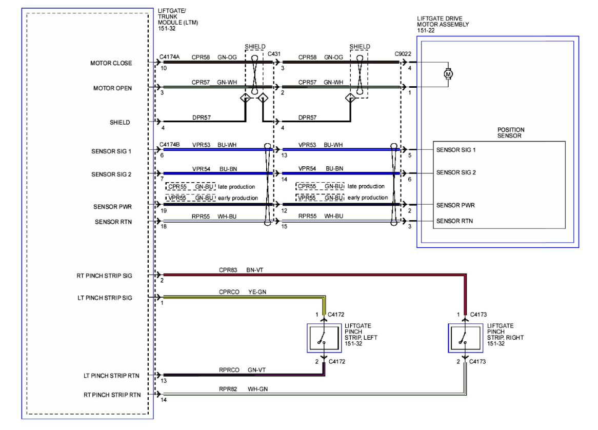

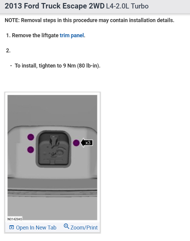

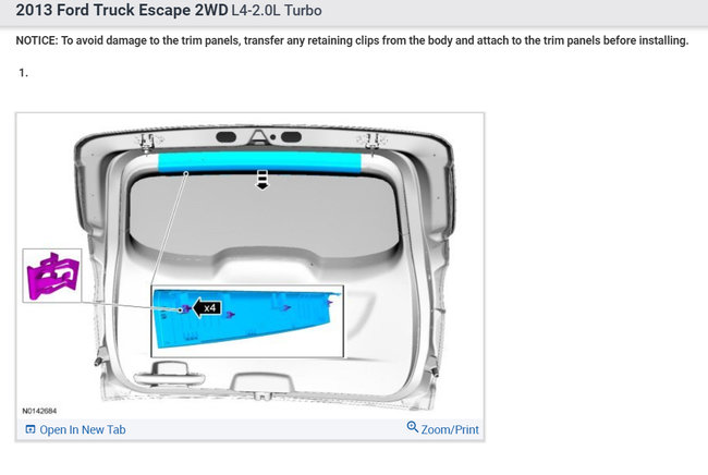

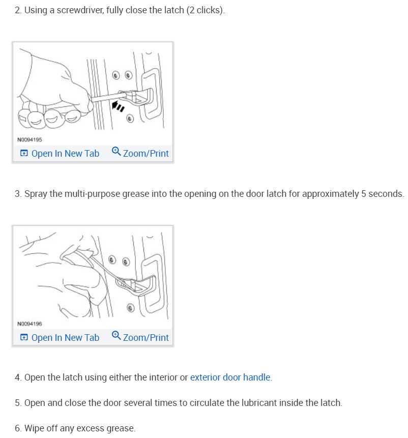

I would try working the switch while a helper pushes inward on the lift-gate. It sounds like the system is working but you may need to lube the latch. I have diagrams and instructions below on how to remove the inner panel to inspect and the latch wiring diagrams so you can see how the system works.
