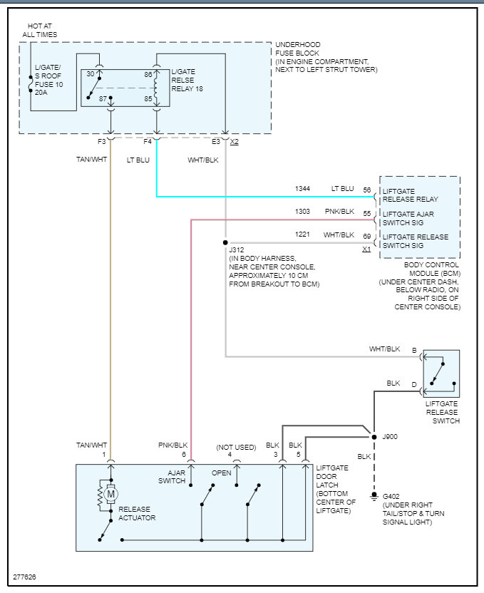

Is there a way to check if #18 liftgate relay is good? I'm disabled and can't afford much. Thanks

Yes, this guide can help:
Here are the wiring diagrams to help with the test. Check out the images (below). Please let us know how it goes.
