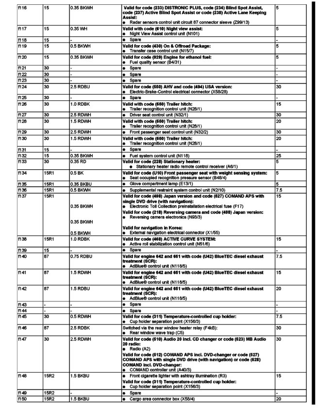

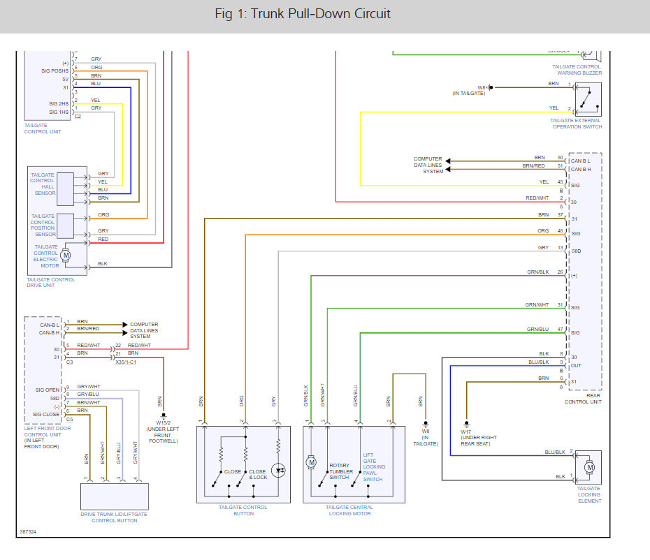

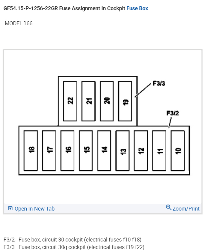

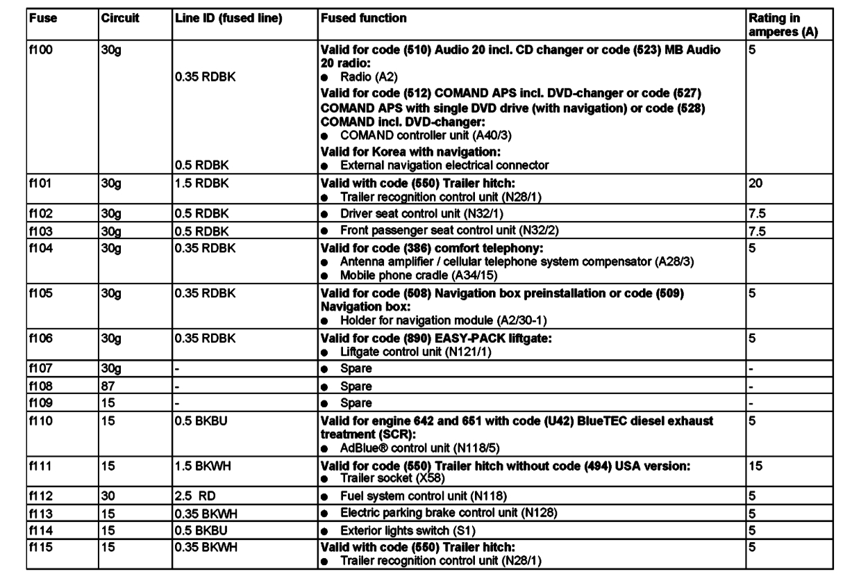

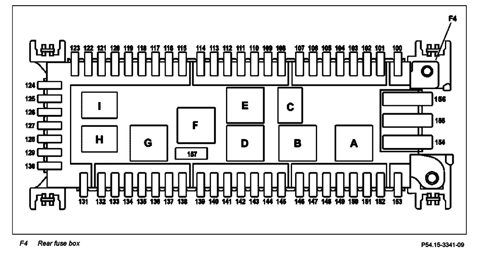

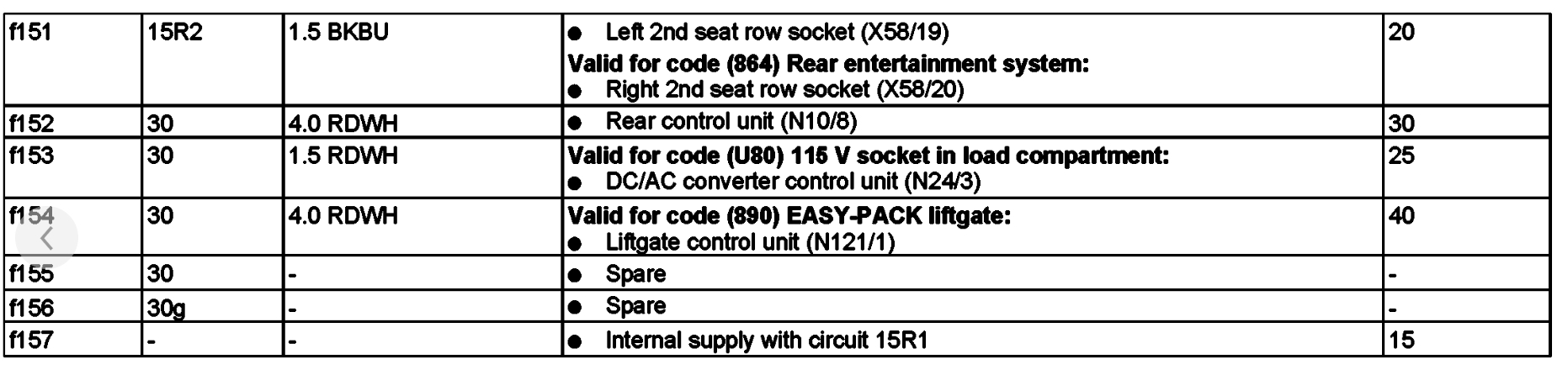

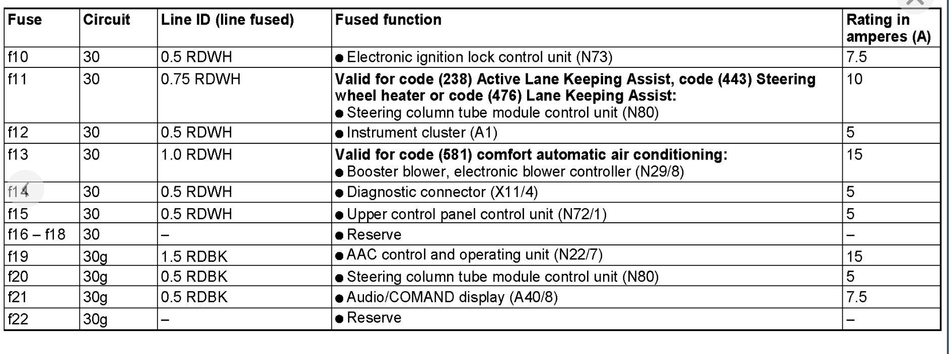

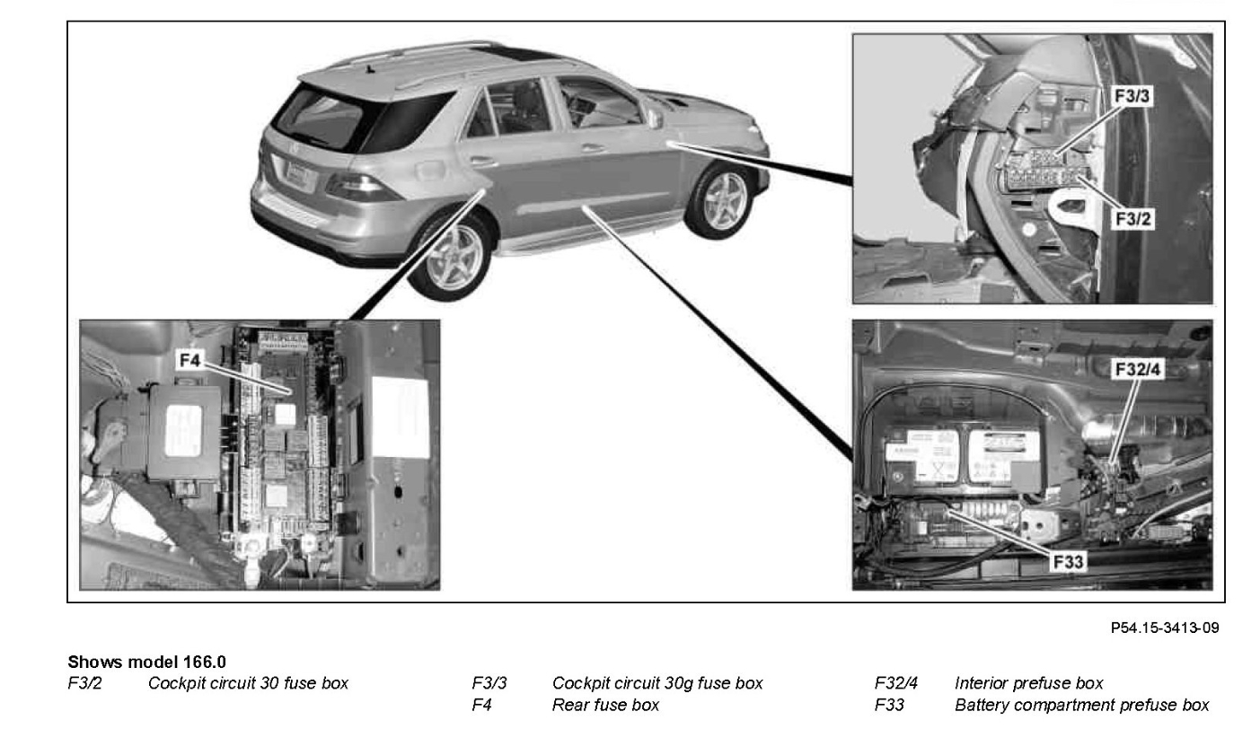

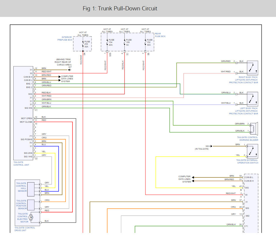

Lift gate module changed with new one and still not working. Maybe the strut must be change also. I’m just wondering?
Jan 31, 2020 at 1:21 PM
  • 55,732 POSTS

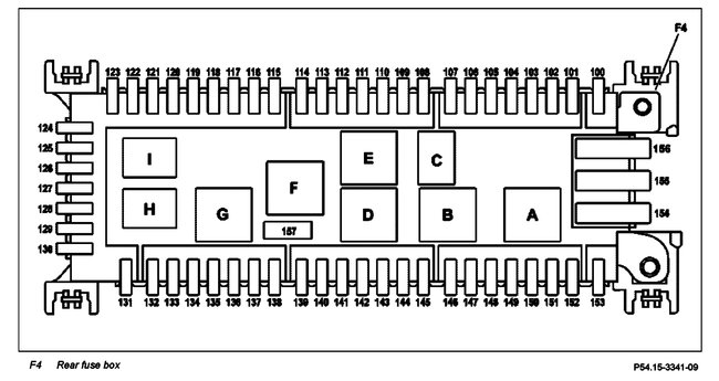

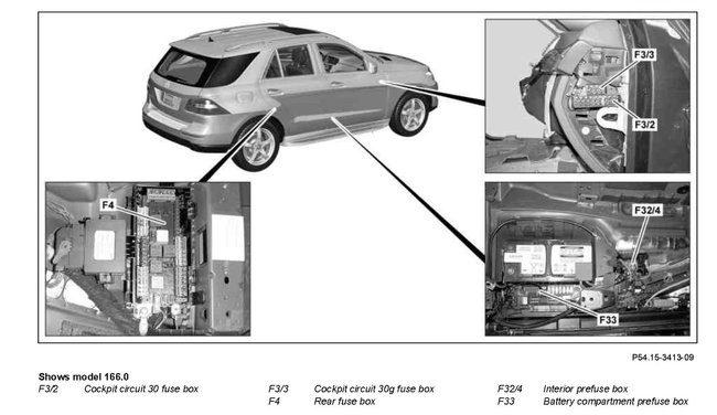

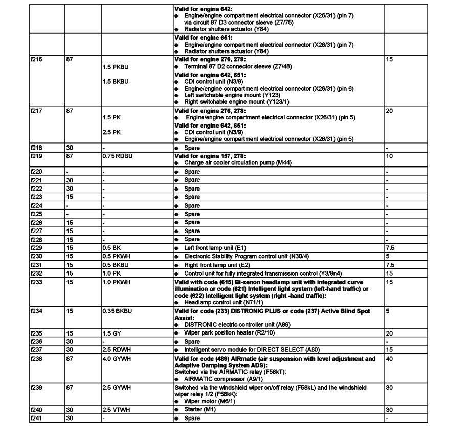

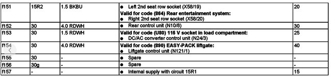

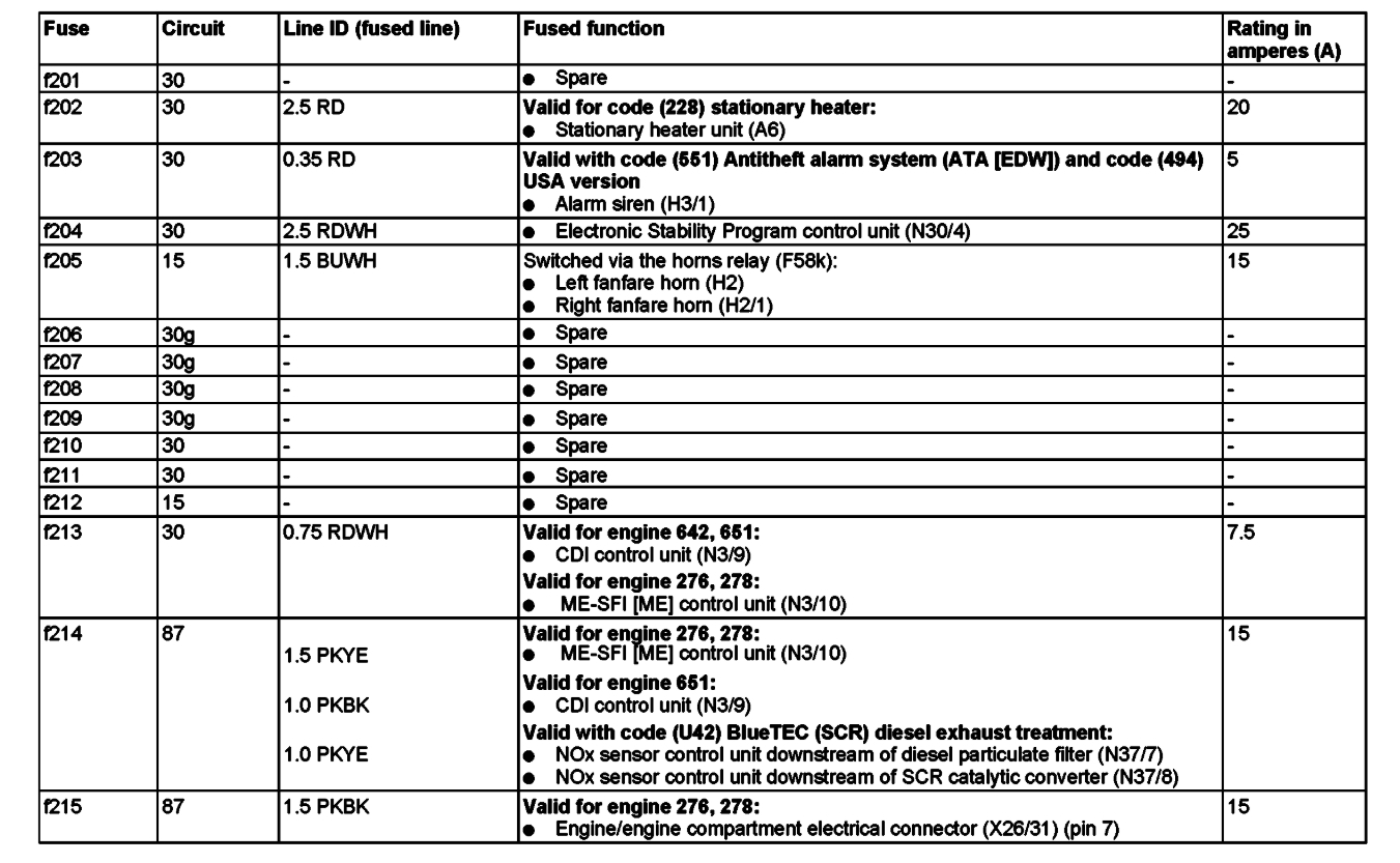

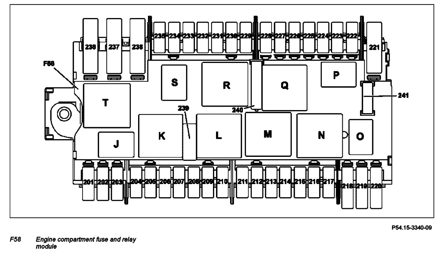

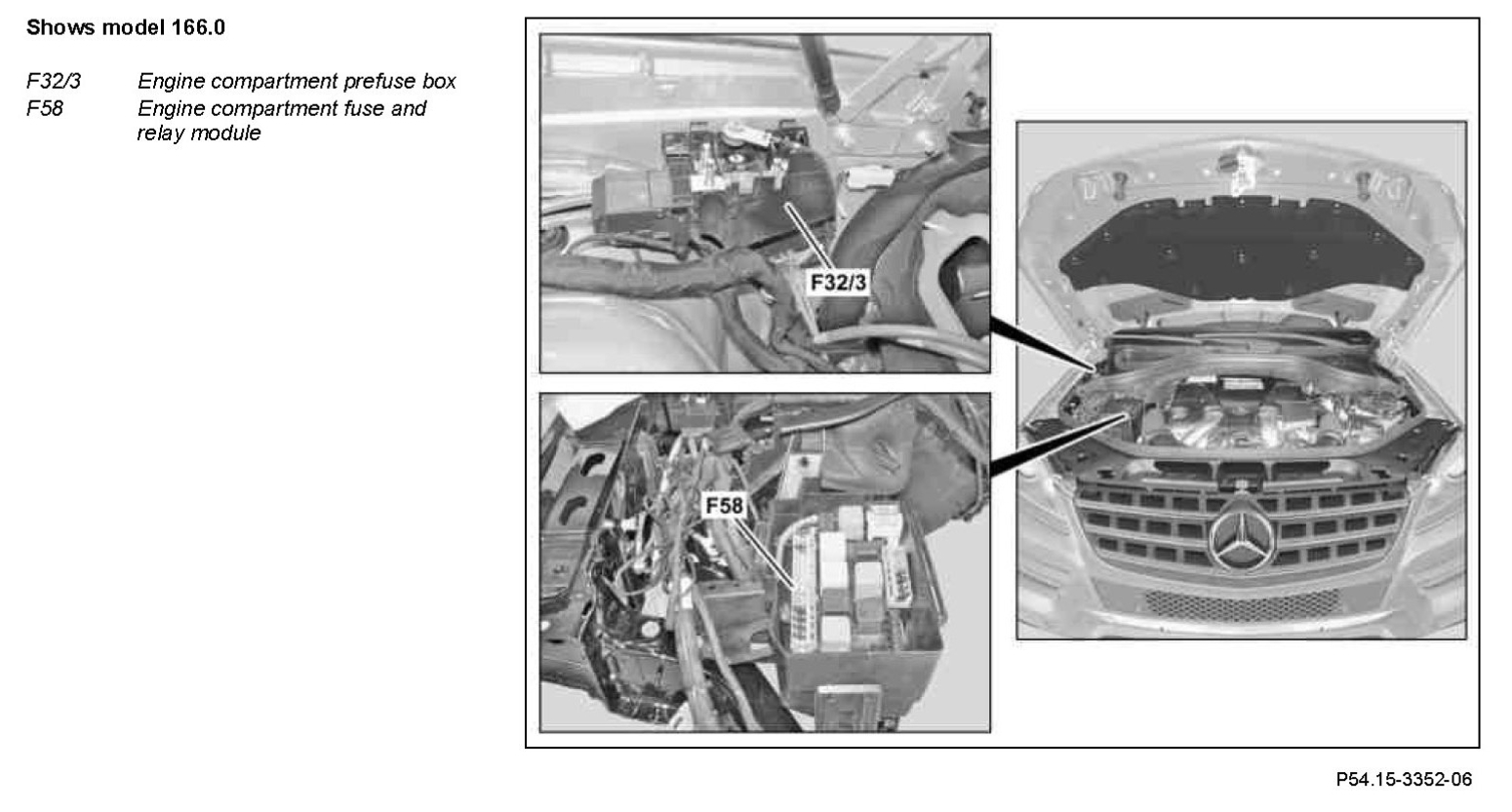

Let's start by checking the fuses. here is the tailgate wiring diagrams so you can see how the system works and which fuses the check. here is a guide to help with that and the fuse location as well:
