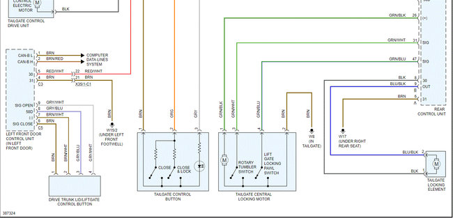

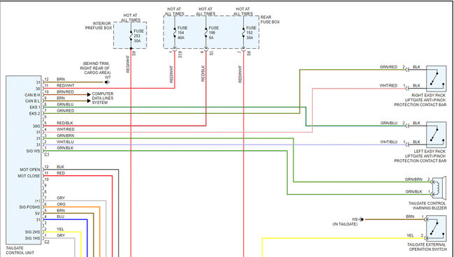

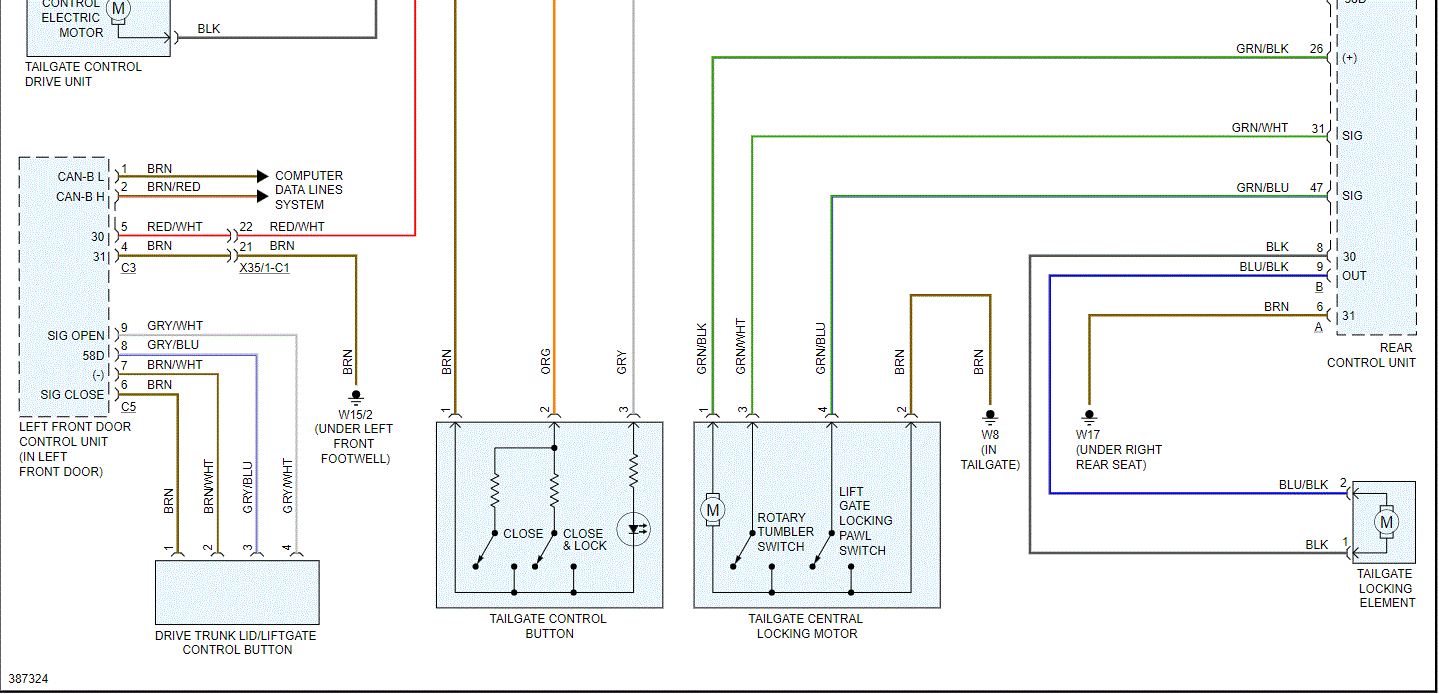

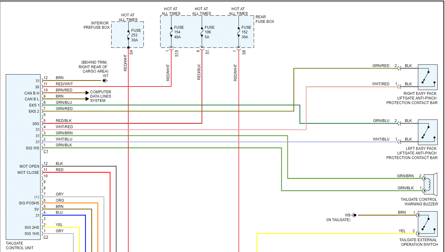

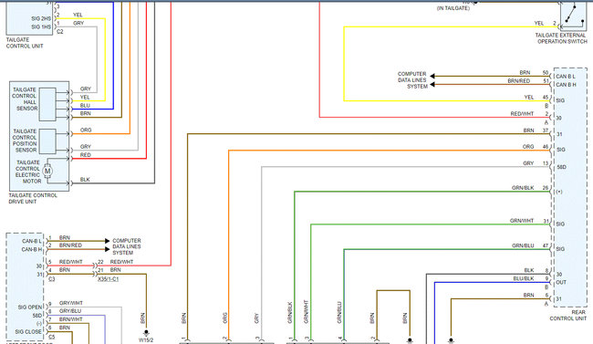

Wiring diagram for lift-gate motor.
Feb 20, 2020 at 8:24 PM
Experienced Mechanic
110,248 POSTS
I attached the wiring schematics you requested. I had to break it into three pictures to make it readable. I did overlap the pictures so you could follow them.
Let me know if this helps.
