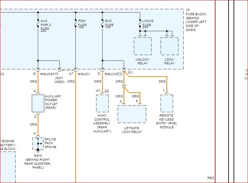

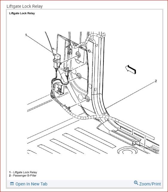

Manual lift-gate does not work . Which fuses to check? I replaced 10 amp, which was not defective, in interior driver's side fuse box. Is there an LGM fuse somewhere to check? There is no keyhole outside for the lift-gate either.
Jun 10, 2019 at 5:32 AM
Hi Corkallen,
Are you referring to the lock system is not working? There is a relay after the fuse. I attached the diagram and the location view of relay.
Let me know if you need anything else. Thanks
