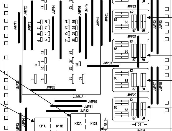

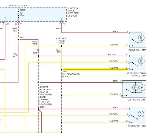

My lift-gate light is on I want to find the fuse or fuses where are they exactly at when looking at the fuse box under the hood and else where?
Dec 31, 2018 at 5:13 PM
  • 110,240 POSTS
The fuse is number 12 on the left hand side fuse box in the vehicle. I attached both a schematic showing where the power comes from as well as a partial picture of the fuse box showing fuse 12 location.
Keep in mind, that fuse powers all internal convenience lighting. It is powered regardless of the ignition key position.
