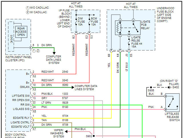

No Power to Fuse 44 under hood. Lift-gate latch does work when 12vdc is applied directly to it by applying 12vdc to fuse 44. All related fuses in left instrument panel are good.

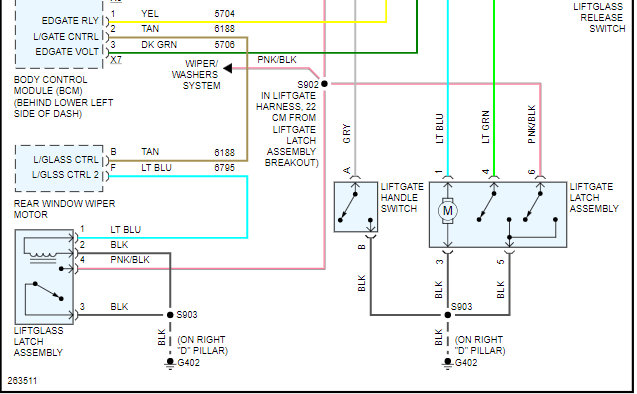

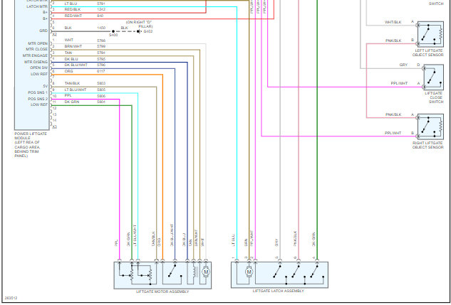

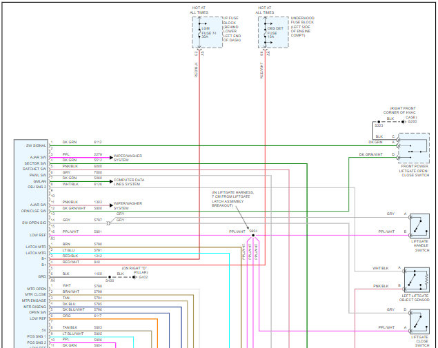

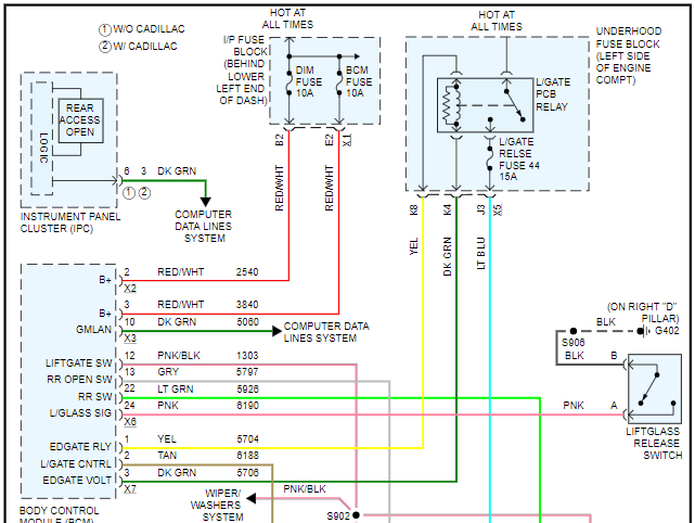

It sounds like you have a faulty wire leading to fuse 44 then possibly. I've attached a wiring diagram below of the lift-gate circuit. I've cut both pictures in half for you to view larger.Hope this helps and thanks for using 2CarPros.
