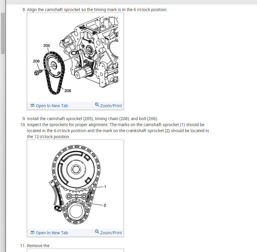

How much would it cost for new lifters and camshaft plus labor and parts?
Nov 28, 2018 at 7:43 AM

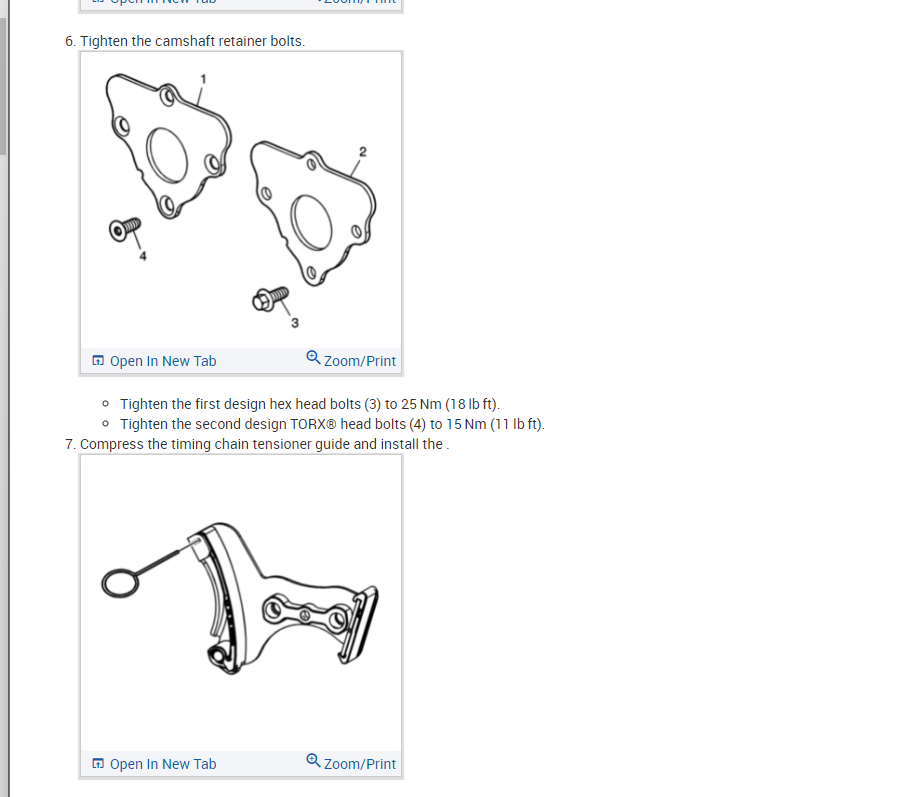

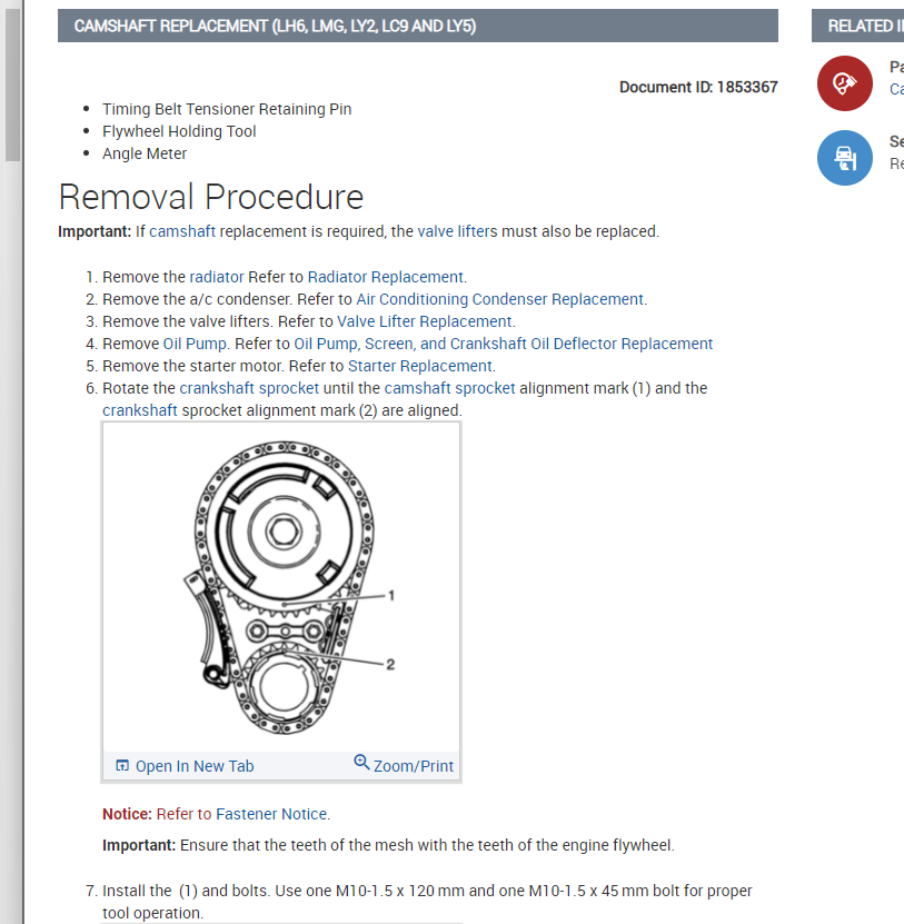

According to AllData, here are part prices and labor times:.
New Camshaft $344.00
new lifters $1,140.00 (with Active Fuel Management)
Labor runs at 22.5 hours book time.

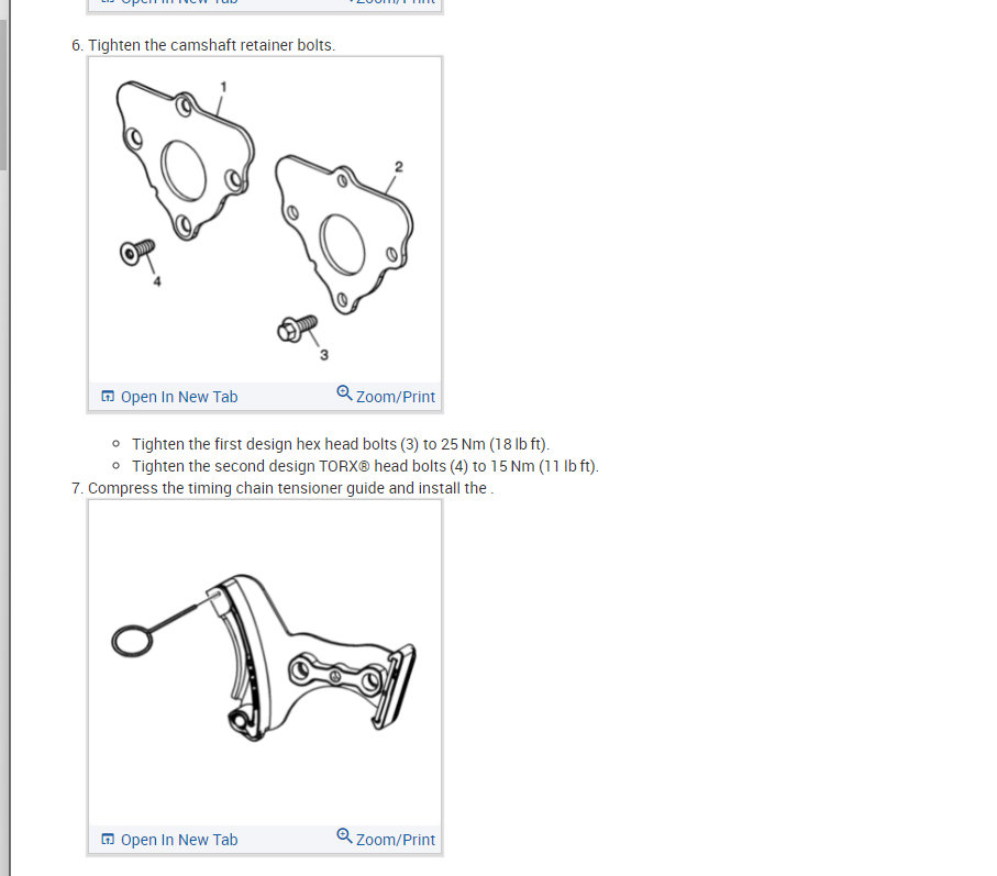

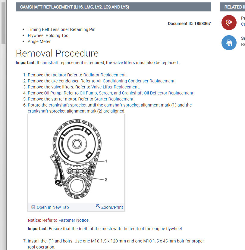

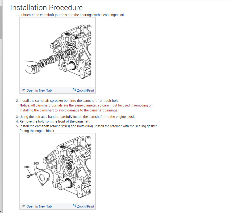

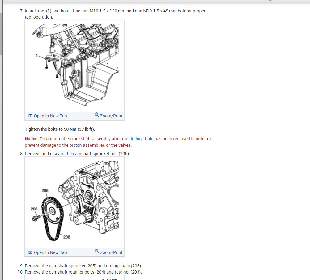

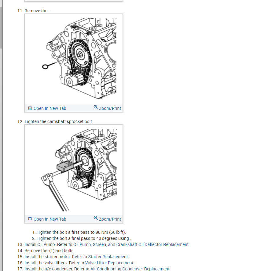

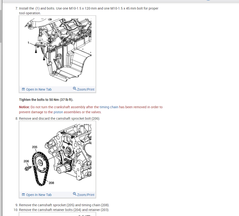

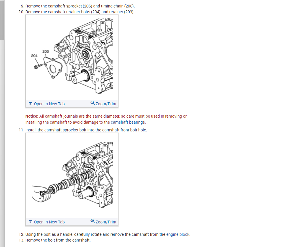

I am also attaching the entire process below on how to change the cam as this is a large job but can be done without a lift.
Please run through this info and let us know if you have other questions or need more info on this. Thanks
