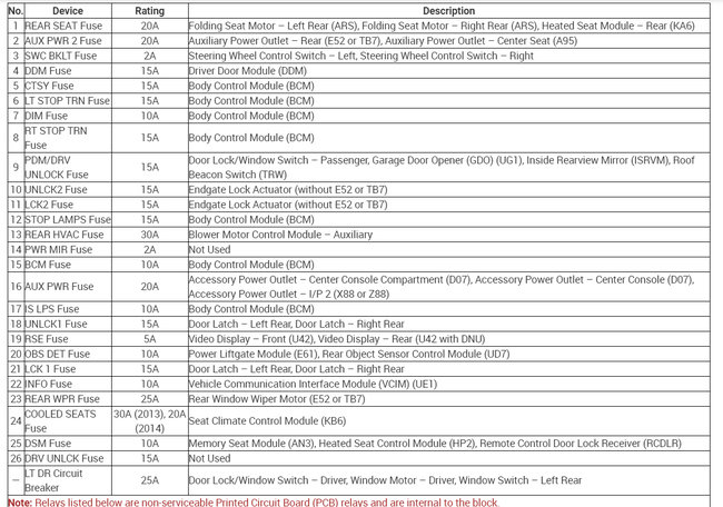

The rear lift gate will not open when the engine is off and the key is out. Neither the key fob,the gate switch button or the overhead dash switch.
Dec 7, 2019 at 5:33 AM
  • 55,627 POSTS

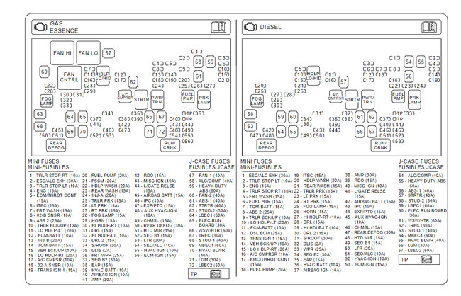

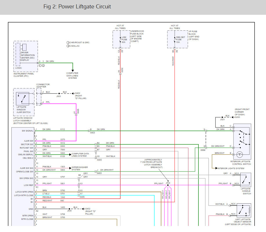

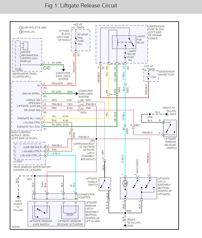

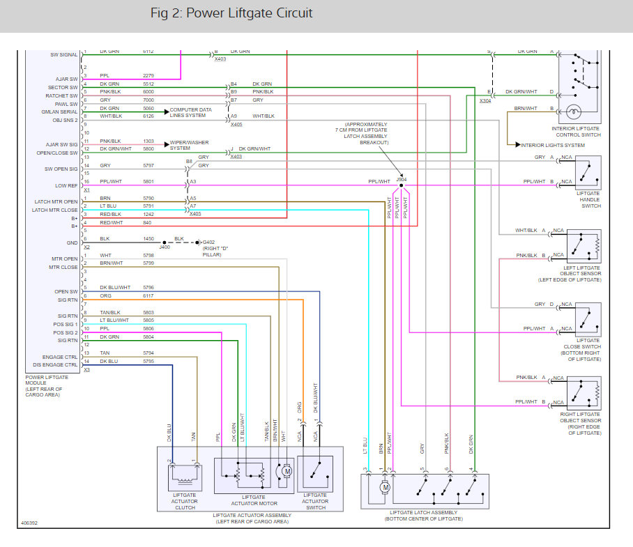

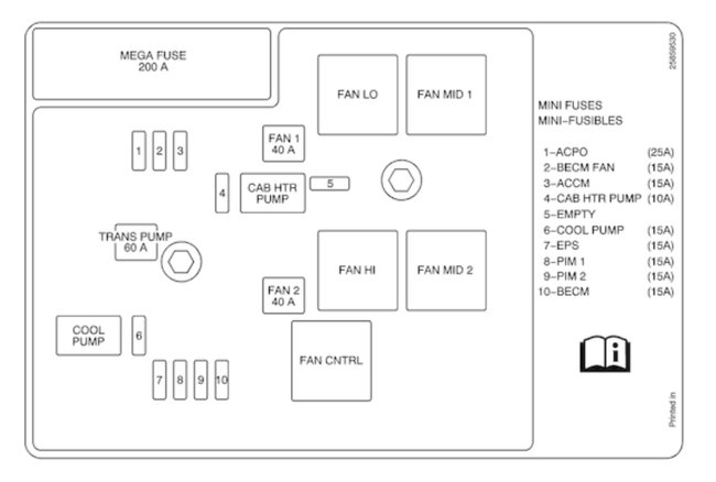

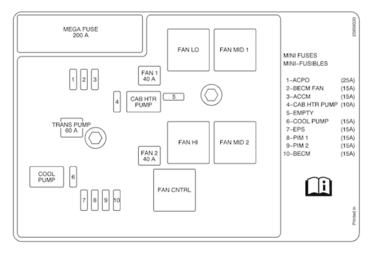

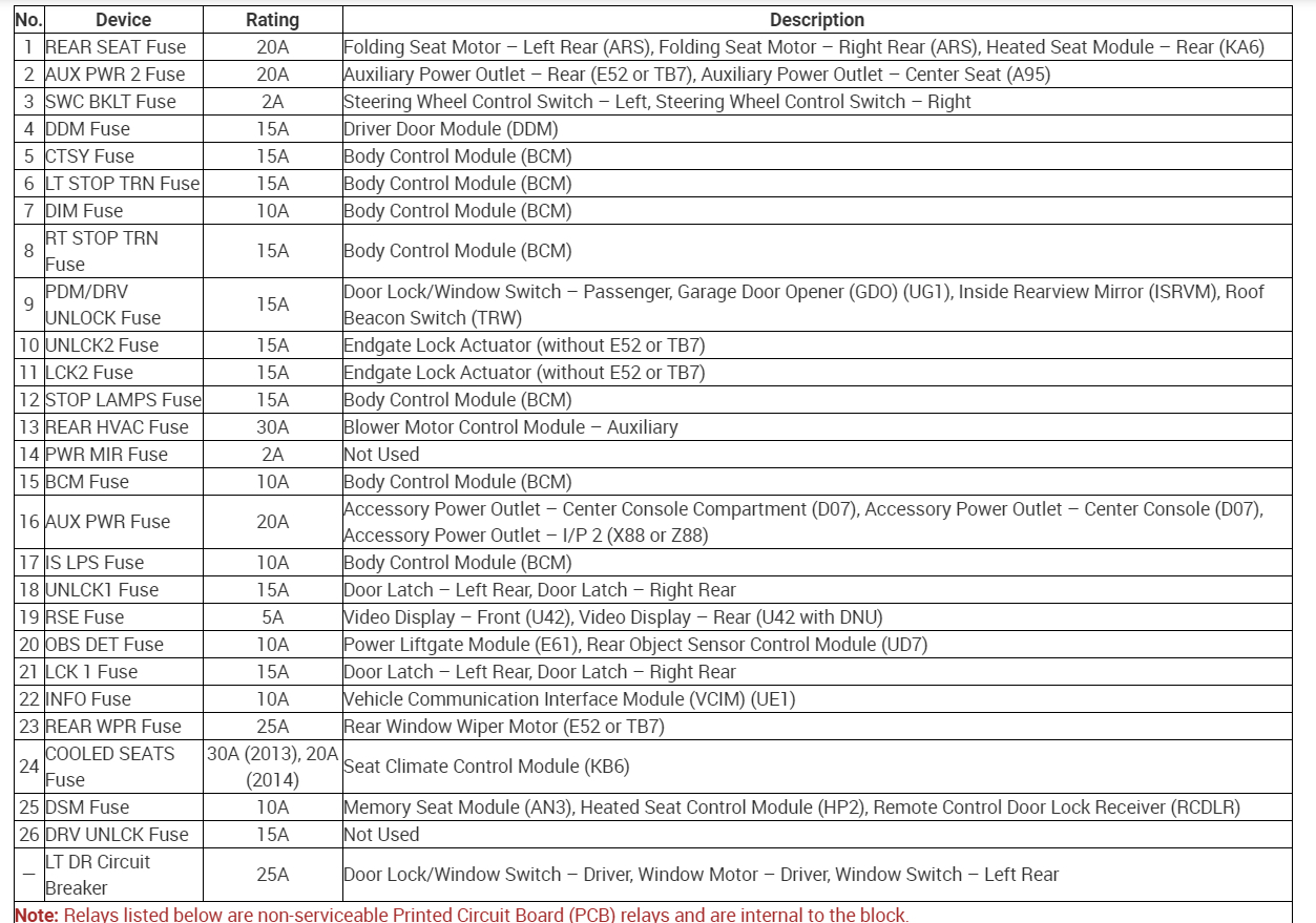

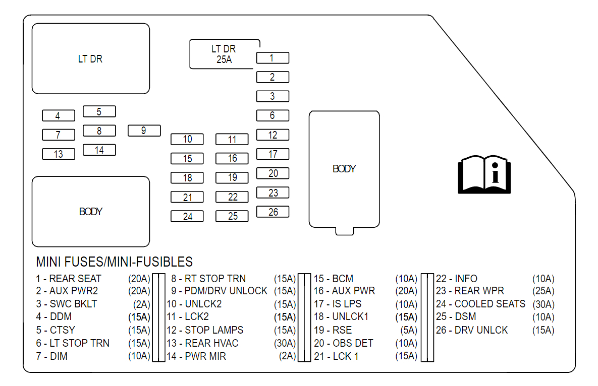

It sounds like the motor or module could be bad. To be sure lets run some simple tests, first let's check for power at the LGM and OBS DET fuses under the hood and inside the car. Here is a guide to help us and the fuse locations along with the lift-gate wiring diagrams so you can see how the system works:

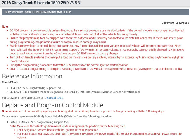

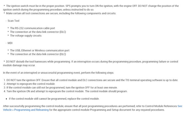

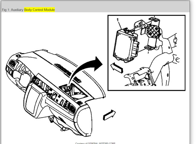

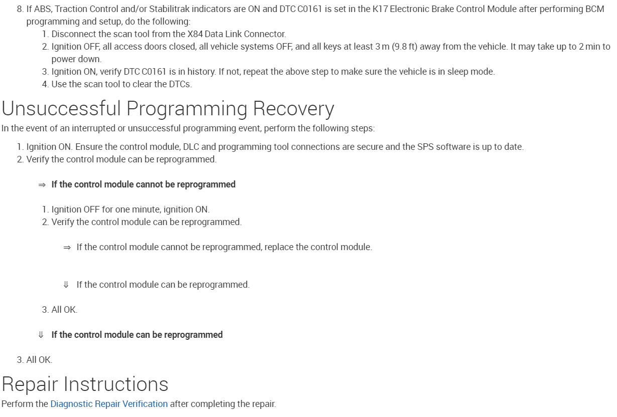

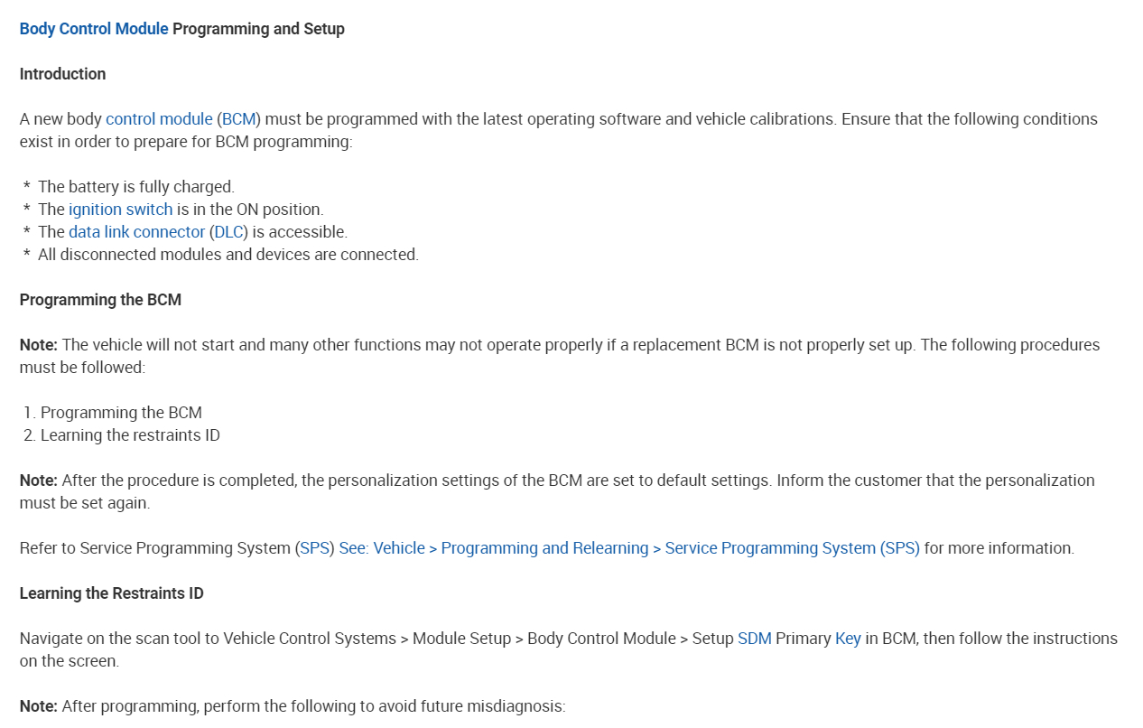

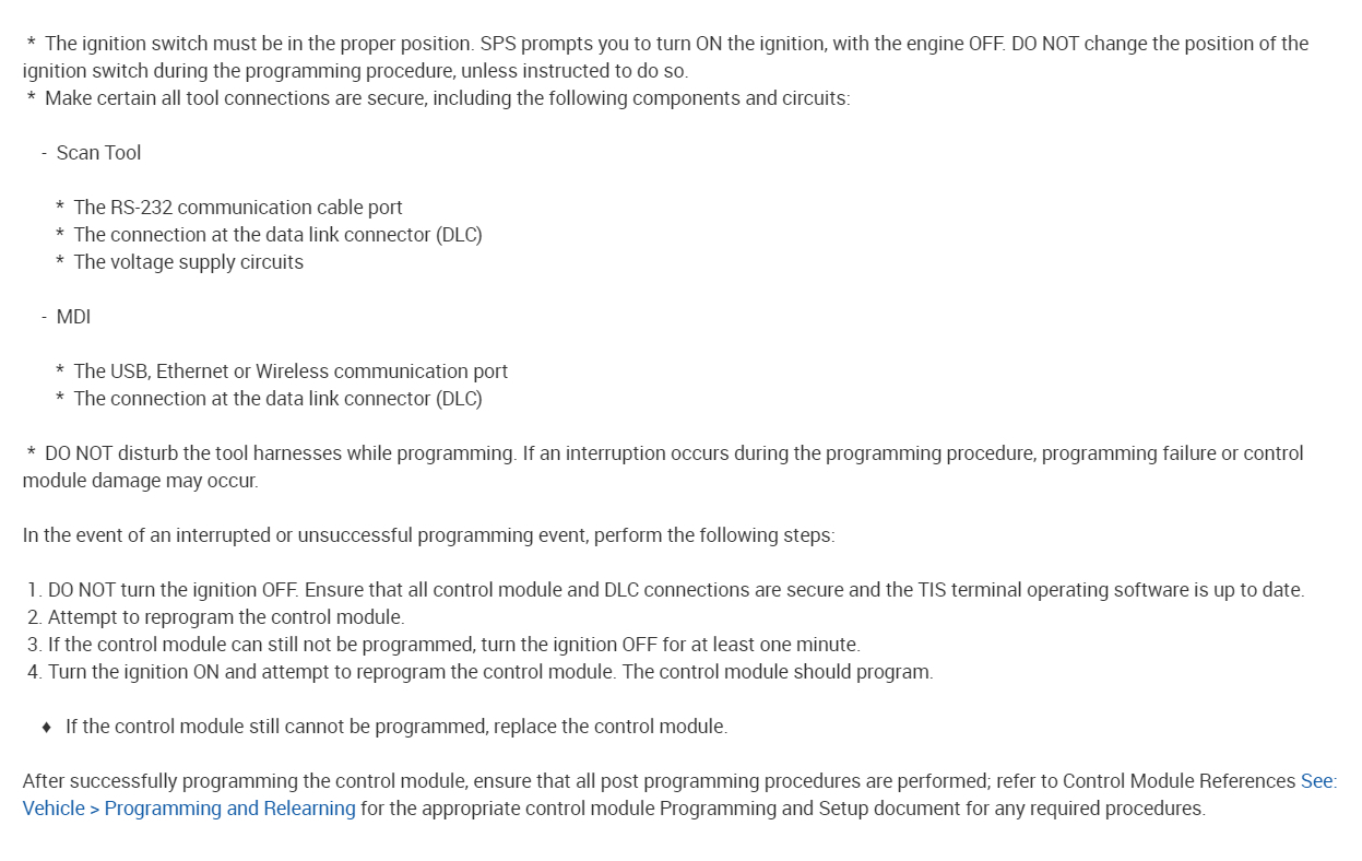

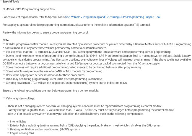

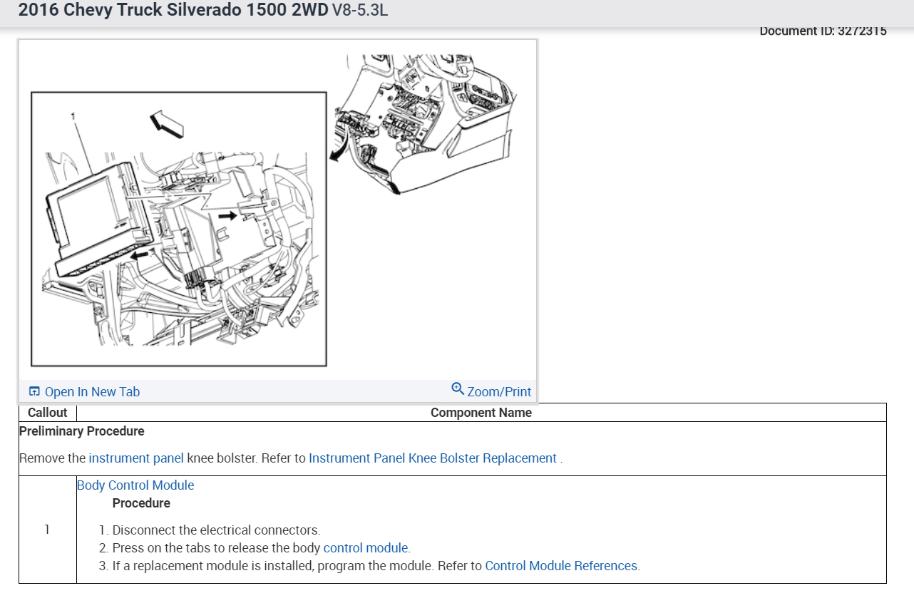

Okay, this sounds like an operational error which the BCM handled which could be going bad. To be sure lets do a CAN scan which is the future of automotive repair. you can get a CAN scanner from Amazon for about $40.00. here is a video to show you how:
https://youtu.be/InIlnsjOVFA

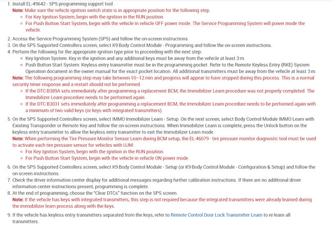

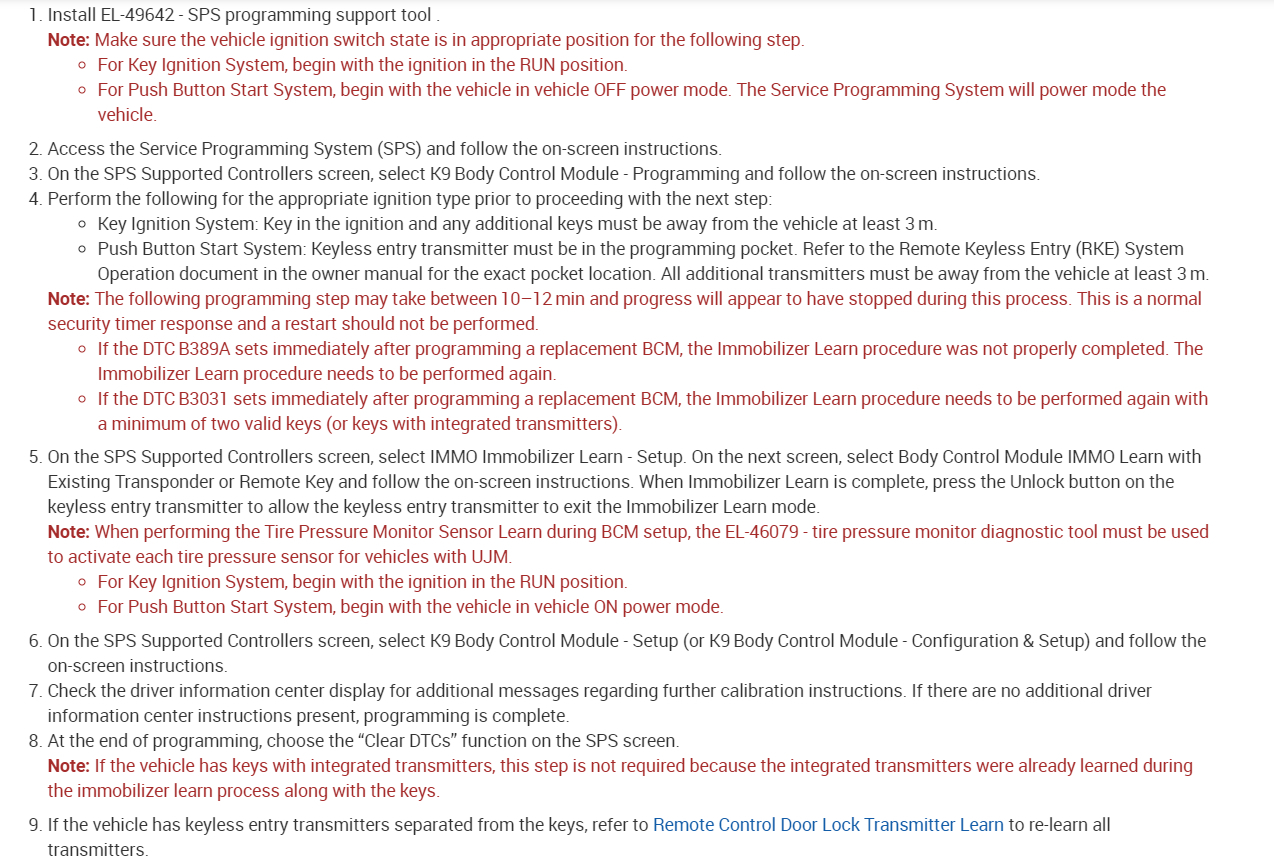

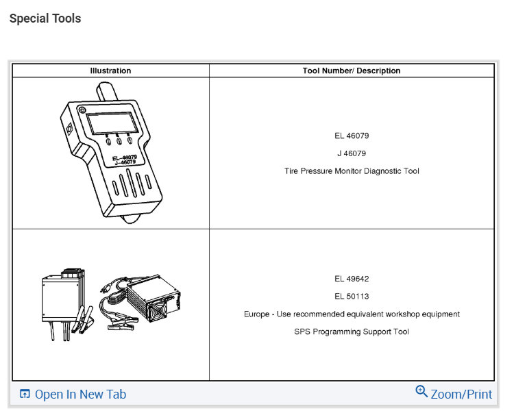

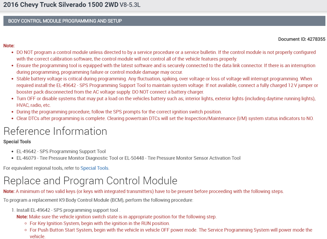

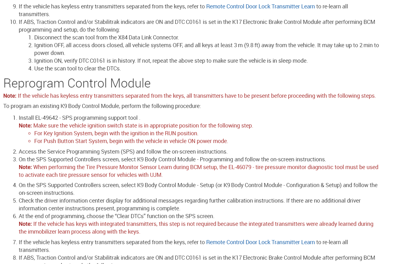

If confirmed here is how you can change out the BCM. Check out the diagrams (below). Please let us know what happens.
