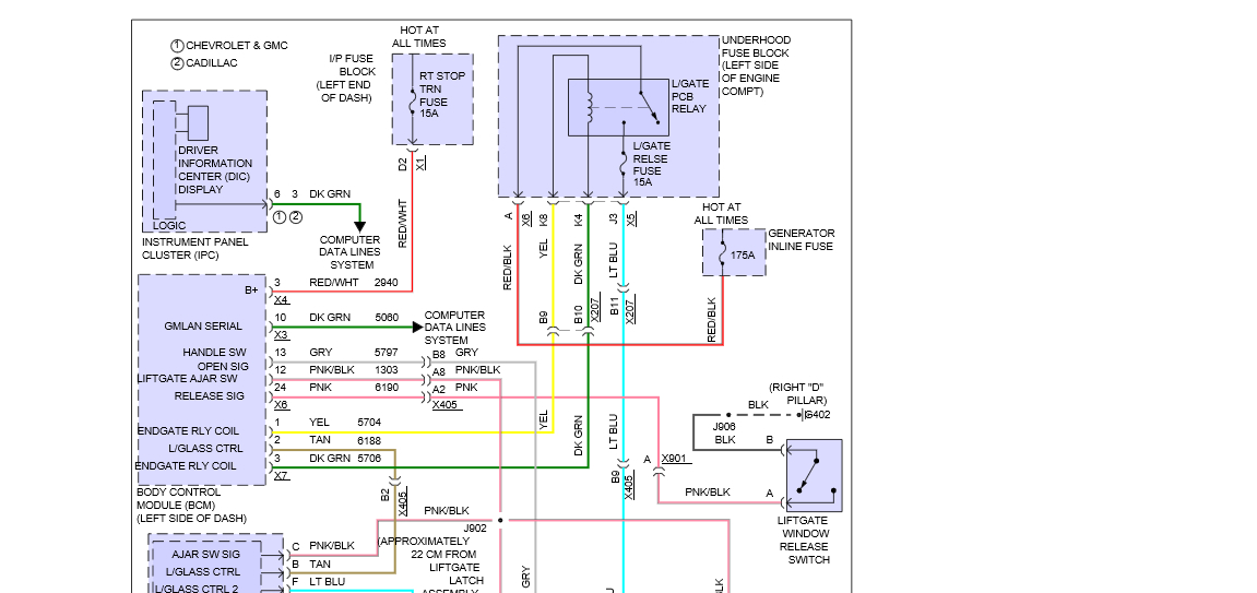

Okay, I have to tell you up front this is a very complex system, it uses Data lines to communicate with the ECM and other control modules in the truck. Okay, so is the Lift Gate Window release switch working, the rear window wiper motor, or any lights on the dash on for any of this systems?
There also is a 175 amp inline fuse that protects the tailgate relay coming from the alternator. The relay for the lift gate is located in a fuse panel under the hood, here is a diagram of that also.
The rear wiper and window release switch get power from the same junction. That is why I ask.

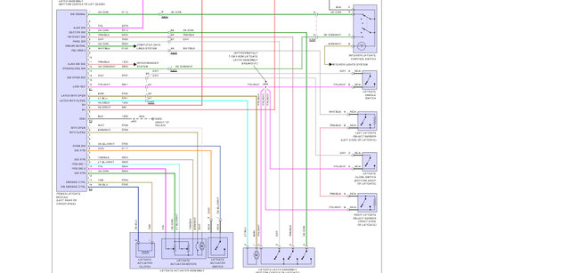

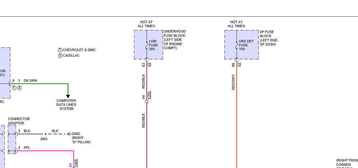

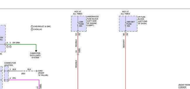

There is also a Power Lift Gate Module (which may be the problem) , this controls all the lift gate functions from the interior control switch. yes its confusing, Its located somewhere in the left hand side of the cargo area. There are two wires that power this module, you can actually check them for power at their fuses if you would like. They are hot at all times. Here are those two fuses. Ones under the hood, the other is in the Ignition fuse panel, under the left hand side of the dash. LGM fuse and OBS fuse.
Oct 19, 2016 at 8:18 AM
AL514
  • 5,669 POSTS

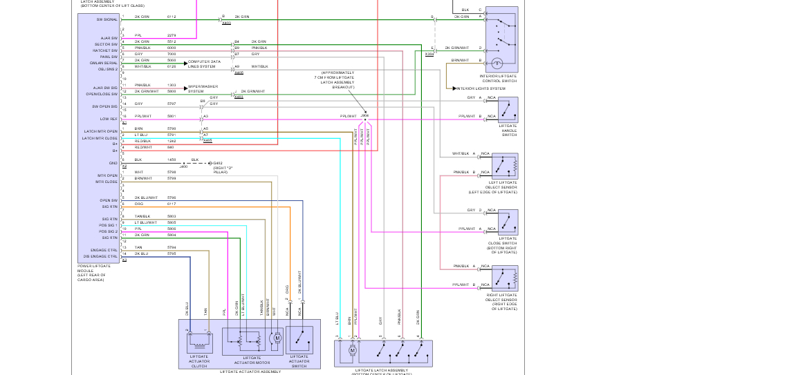

Here is a diagram of the control module for the lift gate, you can see all the switches and actuators go right to it. Just trying to show you what you're dealing with. This module may be the problem, but you have to make sure there is power to those two wires and a good ground first.
