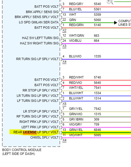

Where is the fuse for license plate lights located?
104,000 MILES • 4 CYL • 2WD • AUTOMATIC
DDAVE71
I've replaced the bulbs and they still won't work. Looked in manual and there isn't a specific fuse stating it's for license plate lights.
Apr 28, 2023 at 8:56 AM
  • 110,251 POSTS
There isn't a fuse for them. Power to the license plate lamps comes directly from the body control module. See pic 1
So, do me a favor. Using a test lamp, see if there is power to the light socket. If there is, check for continuity to ground via the black wire at the sockets.
Let me know what you find.
