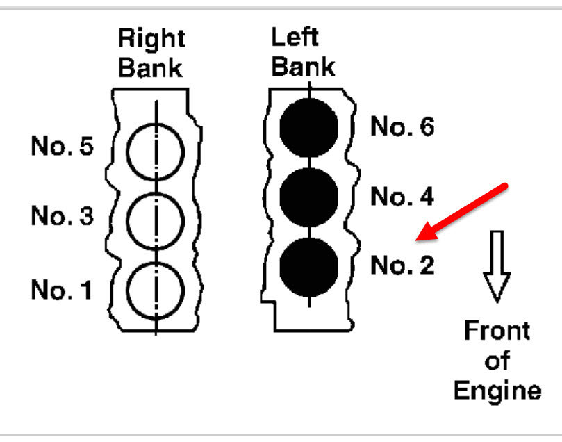

Lexus told me I need my ignition coil fix
2007 LEXUS ES 350
154,000 MILES • V6 • 4WD • AUTOMATIC
WILLAAAAAY
When I asked which one all they told me was it was ignition coil number two and on side b. Is that the front left or front right or in the back? I just want to know.
May 31, 2017 at 1:22 PM
HMAC300
  • 48,601 POSTS
see picture that should explain the problem better for you b is whatever bank even cylinders are.
