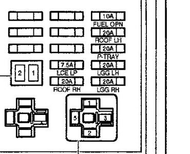

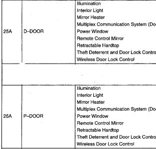

THere are codes stored in the pcm that will give DTC or Diagnostic Trouble Codes. A scanner is required to get them out of the pcm. However we may be able to get through this otherwise. Check these fuses:
https://images.2carpros.com/forum/automotive_pictures/30961_pddoor1_1.jpg
https://images.2carpros.com/forum/automotive_pictures/30961_pddoor_1.jpg
They are located on the passenger side.
https://images.2carpros.com/forum/automotive_pictures/30961_pddoor2_1.jpg
In the #1 jusnction block.

Ok I checked those two and they look to be ok.

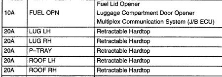

Also check all of these in the trunk:
https://images.2carpros.com/forum/automotive_pictures/30961_pddoor3_1.jpg
https://images.2carpros.com/forum/automotive_pictures/30961_pddoor4_1.jpg
Apr 17, 2008 at 7:50 PM

all those seem to be good as well.

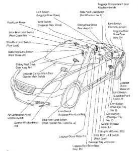

There are 55 different trouble codes associated with this system as it is complex:
https://images.2carpros.com/forum/automotive_pictures/30961_lexus_1.jpg
These are the vairious components. The trouble codes give a start to diagnosing this system and after looking at this, I need to know them. Maybe autozone can read them, as they do this for free or may need a special scanner for the Lexus, not sure on this. But without codes the field is too large to go after.
