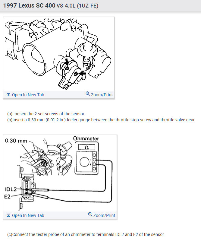

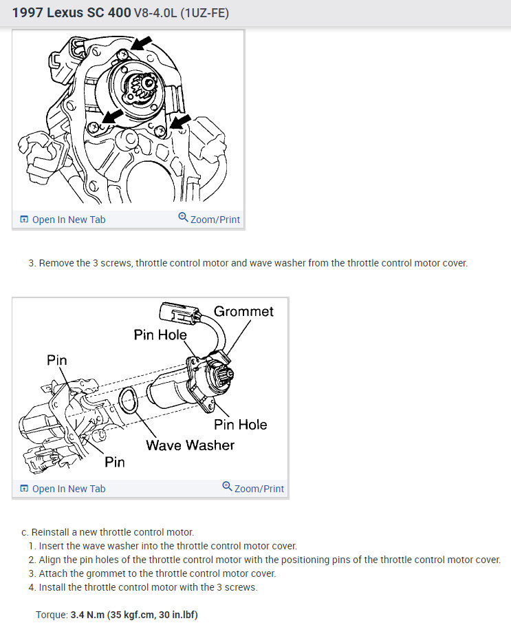

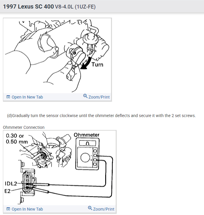

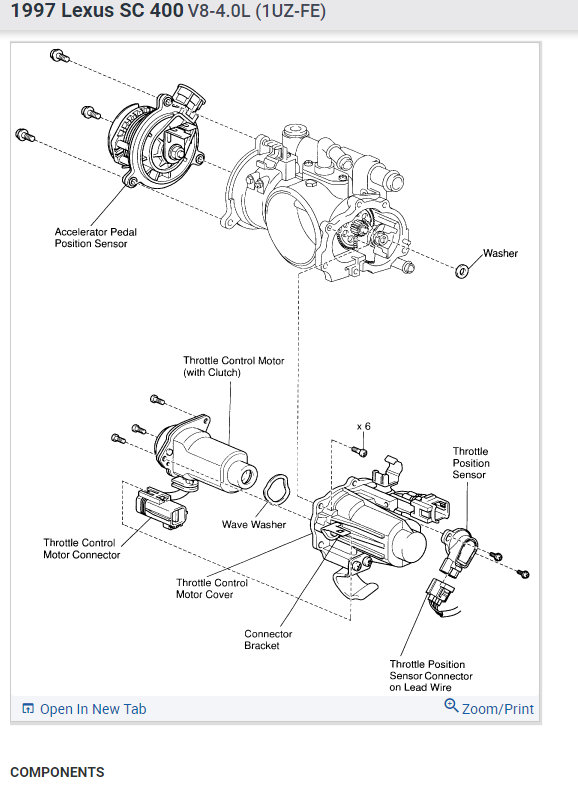

i am having problems finding the sub tp sensor i know it has 2 a black and a gray one, i am having a p1401 code appear thanks for your time
Feb 22, 2008 at 12:28 PM
SQM
  • 6,383 POSTS

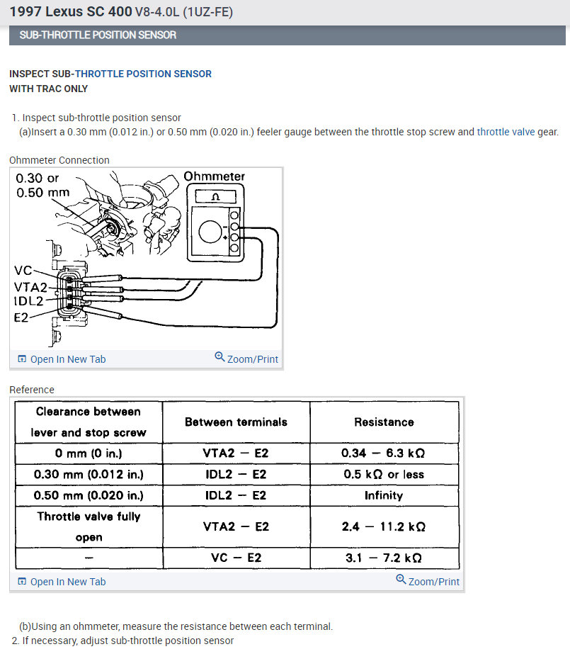

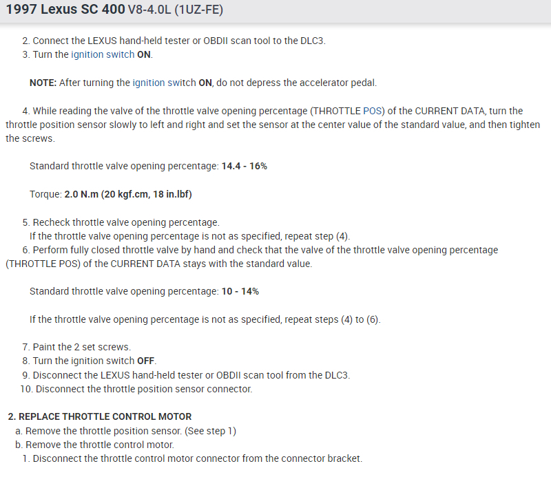

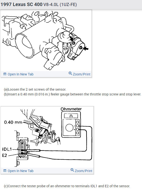

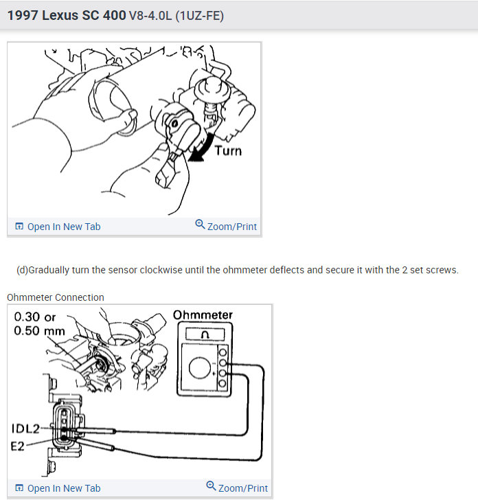

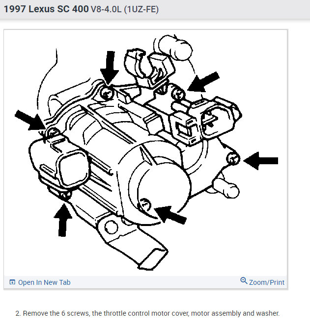

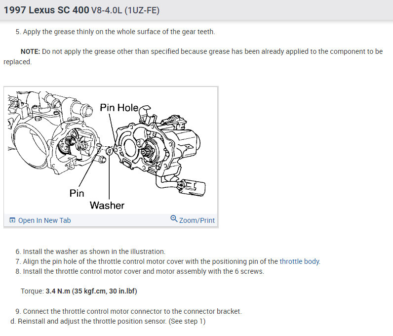

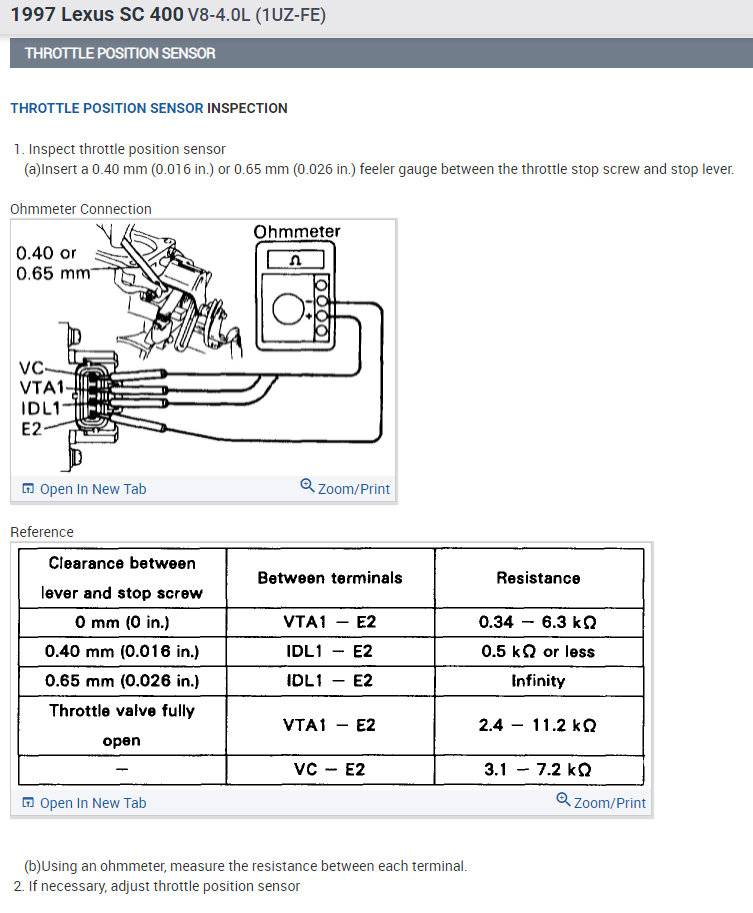

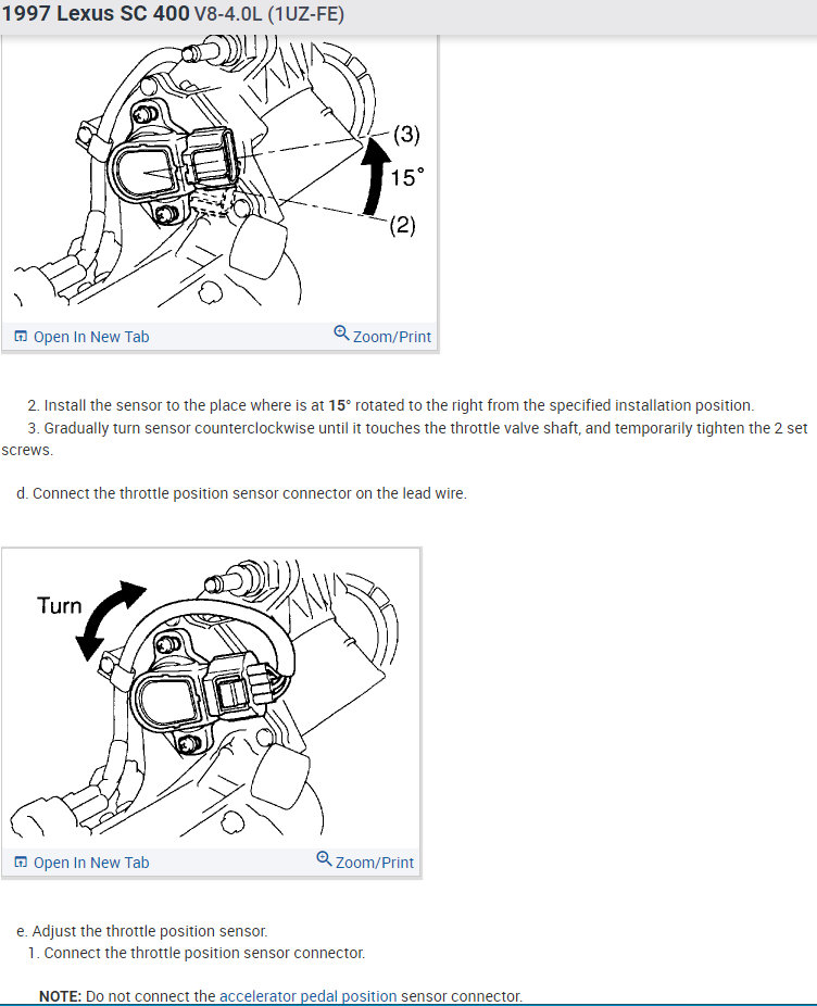

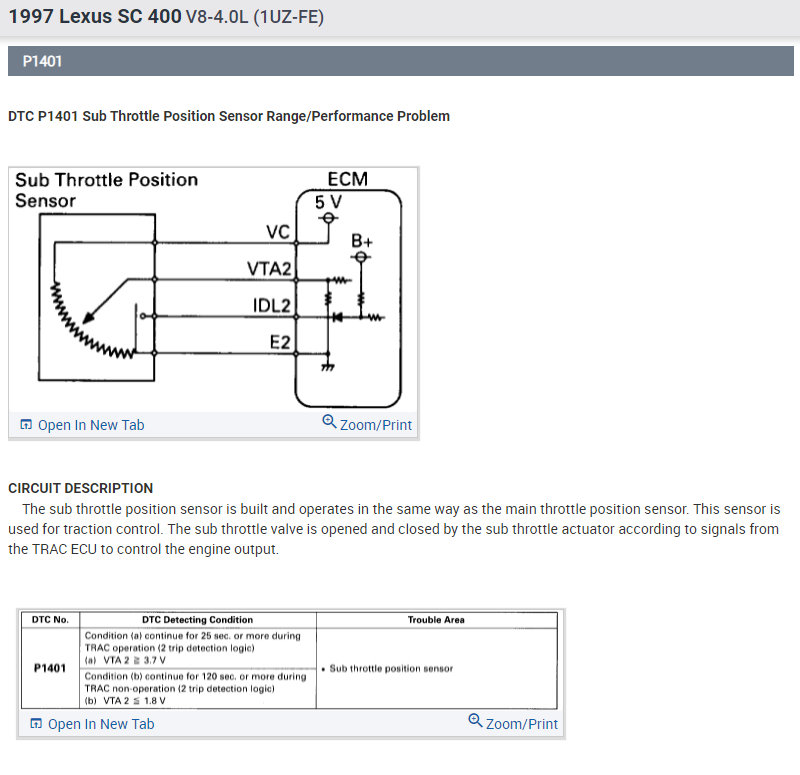

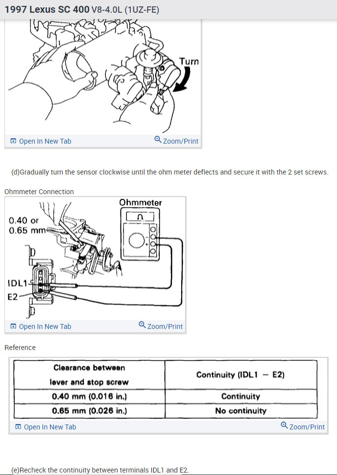

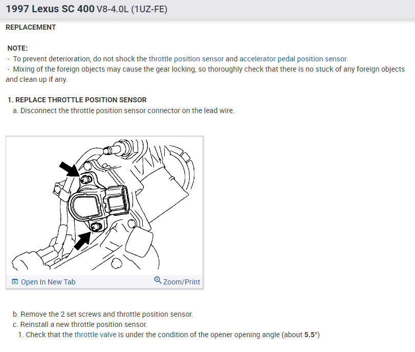

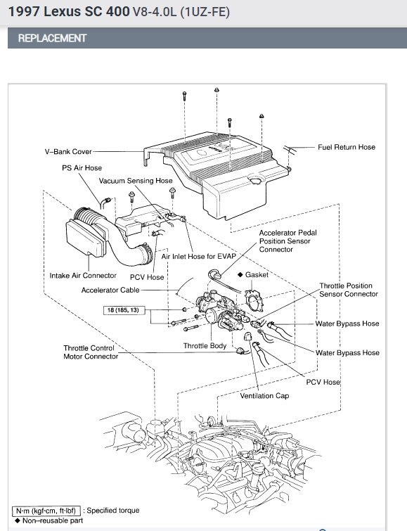

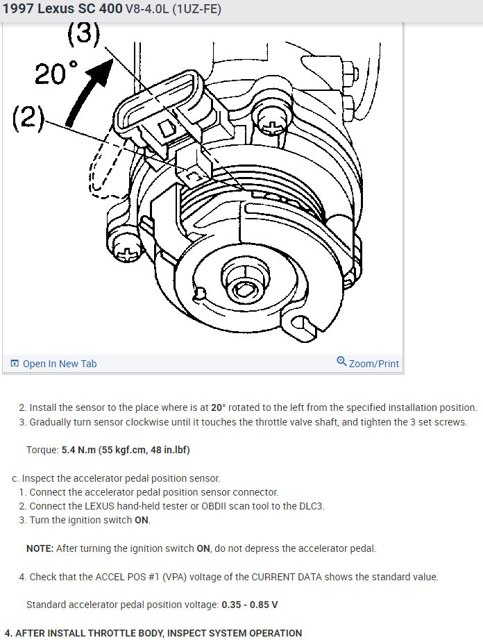

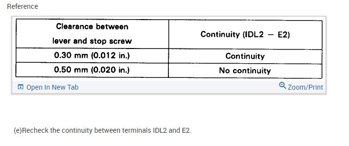

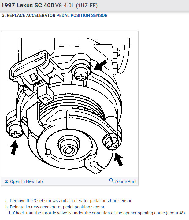

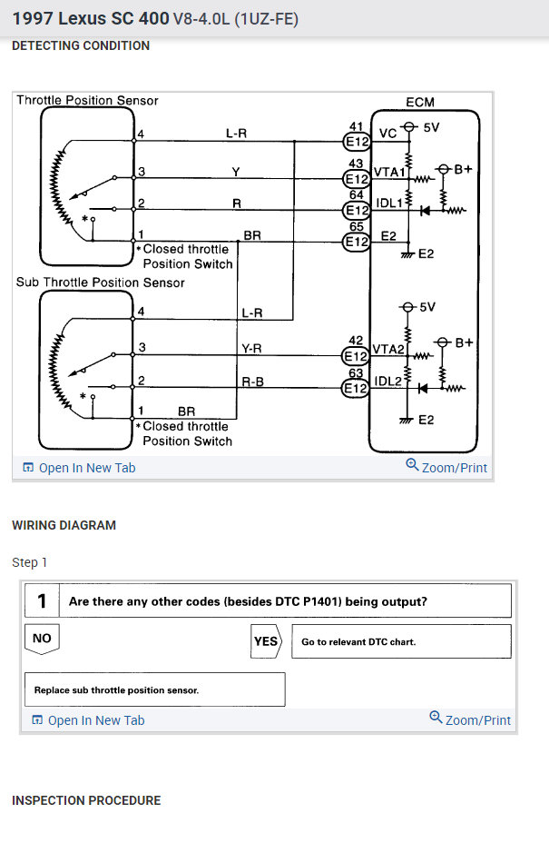

The code:
P1401 - Sub Throttle Position Sensor Range/Performance Problem

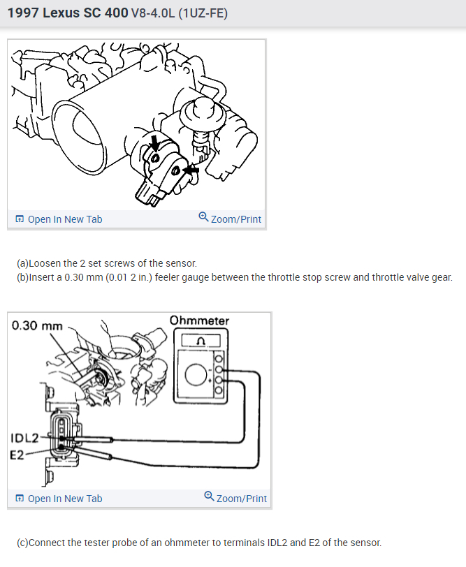

The sub throttle position sensor is used for traction control. See diagnostics procedure for that DTC attached.
This vehicle is equipped with a throttle position sensor, a throttle control motor and a accelerator pedal position sensor. They are all connected to the either side of the throttle body. See diagrams below for position of each of these components.
https://www.2carpros.com/articles/how-a-throttle-body-works
I have attached the diagrams for your reference.
