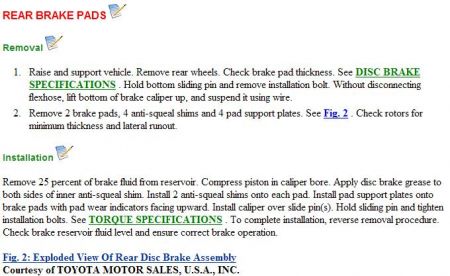

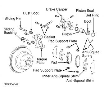

do i need a special compression tool for this cars rear calipers?

Hi there, There are no special tool;s required to replace the rear pads, see text & pic for details. mark (mhpautos)
