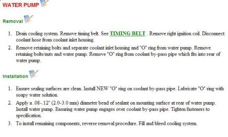

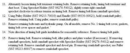

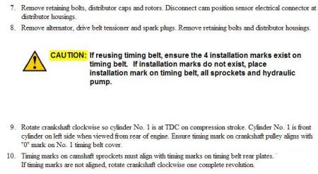

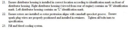

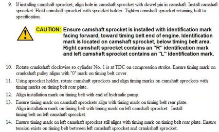

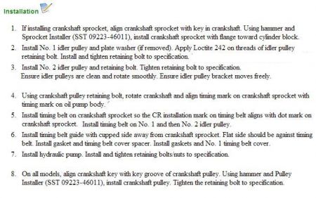

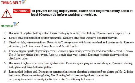

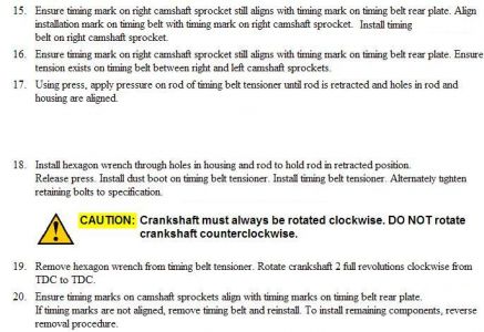

what is the best way to change the water pump on my lexus sc400? how much of the front of the engine needs to come off? is there a easier way?
I think it needs to be replaced cause when I start the car coolant comes out on the timing belt and sprays off it.... sounds like a bumb water pump right?

Dec 10, 2009 at 10:03 AM
