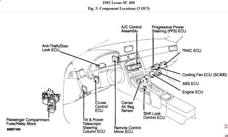

Does the interior lights work when you open and close the doors, if so, there is an ECU that controls the steering wheel position. It is located under the dash on the left side. It has probably failed. I have attached an image. Please let me know how it goes.
https://images.2carpros.com/forum/automotive_pictures/10_lexus_steering_wheel_position_1.jpg
Apr 12, 2010 at 12:54 PM
MONT.AUTO
  • 32 POSTS
Yes, if the switch above the interior rear view mirror is set to the "Door" position, the interior ceiling light ignites when either door is opened. Does this help?
Have a good day.
Apr 12, 2010 at 8:11 PM
  • 54,837 POSTS
Ok, thats helps, it sounds like the problem could be the controller, try replacing it with a used one and re-check operation.
