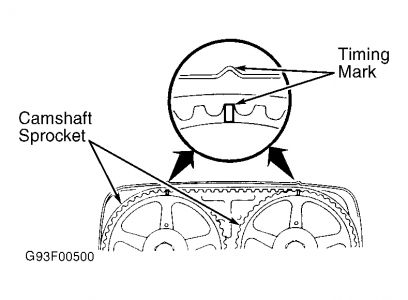

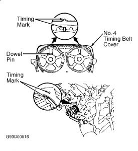

I need to know the timing belt alignment marks for 1992 in line 6 lexus sc300
Apr 6, 2009 at 9:52 PM
RACEFAN966
  • 5,029 POSTS
Here are two pics to show you the marks if you need anything else just ask.
