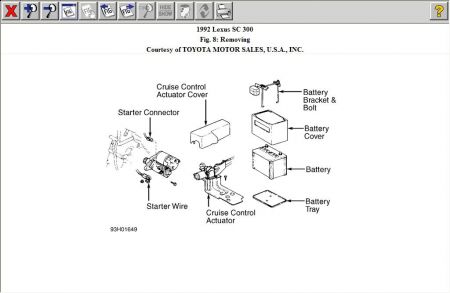

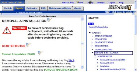

how do I repace the starter on my car. I want to put
a new one on myself.
